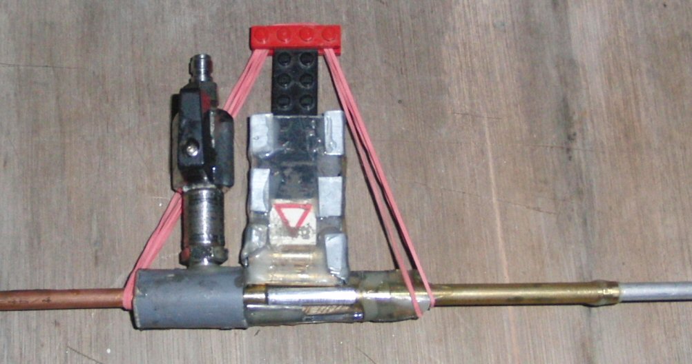

In any case though, I see no juncture where it should become a farting machine because the barrel is "open" when the new cartridge is being fed so there should be no significant pressure buildup in the breech preventing the new cartridge being seated.
If you're referring to the "caseless" design posted on this page, the same logic applies because before the projectile goes past the valve porting into the breech, there is no reason for any pressure buildup because air coming from the blowgun will be vented through the barrel, so no reason for flatulence there ;)
The simplest way to avoid this risk is to add a valve that cuts off air supply as till the bolt returns to its original position...
I could easily have avoided the whole pop-off cartridge thing by grafting this to my original cartridge design but I think the current prototype is a better way of doing things.
New bolt setup is cured and I'll test it after work, if I can get it cycling nicely I'll rustle up some more cartridges and a magazine and see if this will actually feed itself :)

You can say that, but at least in this case the cartridges are actually contributing to the function :) couple of hours of work left and I'll test it as a multishot :D
Edit: Here's a test of the cartridge ejecting with the new breech, with the target - a CD in this case - is visible being struck in the background. Time to make a magazine and some more cartridges :D
Edit 2: I made the magazine a little too tight and it's causing too much friction with cartridges fitted so I'm going to have to redo it, but tested it with a rubberband sprung balsa wood follower and it's looking *very* promising, the follower snapped into place before the bolt came back, if that was a cartridge it would have most likely been fed into the breech :D
Edit 3: Getting there, but not quite...
The potential solution is a heavier bolt, increasing bolt travel and reducing spring pre-compression, giving the bolt a really good run up so it can smack the new cartridge into the breech.

Cheers :) actually the fact that it's only popping off at around 25% of the pressure I'm feeding it means there's a lot more power potential, both in terms of projectile as well as power available to the spent cartridge to work the breech.
You know... you could just loop that last vid ;)
:D :D :D
or you could try increasing the slide room for the bolt to allow the next cartridge to settle before the bolt slams into it
The problem isn't that the next cartridge doesn't have time to move into place, but the bolt itself doesn't have enough cojones to push the cartridge into the breech.
My plan therefore as in my previous post is to extend the bolt spring housing, which reduces spring pressure on the bolt while allowing it to slide back further, the idea being that it will build up more momentum and bodily smack the cartridge into the breech when it returns.
