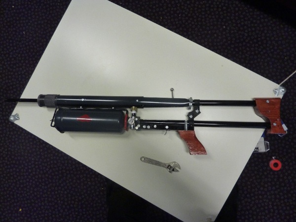

Today i finished my airgun! thought i'd share it with you guys.
Tank is filled up to 14 bars using a bicycle pump, then i can shoot 20 times or so..
if the ammo fits well it shoots a LOT better then my spudrifle ( http://www.spudfiles.com/forums/draguno ... ter,0.html )
Any ideas on what to shoot through a 15mm standard copper pipe? :P
i use plastic arrows that i make from self adhesive decorative stuff and wrap a nail in it or so.

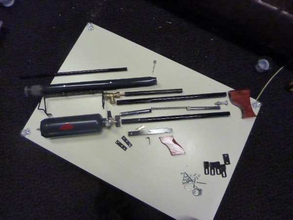

Right before assembly

cool thing, i allways wanted to use a fire extinguisher, but i don´t know if they fix to any brass fittings :roll: .is it accurant?

Well it certainly looks neat. I would have made the stock adjustable, as well as a cut off to allow that bolt to sit sideways while you aim.

Good work! Especially if that is your first pneumatic, is it?
On the pictures it looks like a hammervalve as a main valve, there are not that much hammervalve guns here. :)
How about the performance?
I would use Nail-Darts as ammo, what did you use until now?
The gun seems to be quit long, what is it's length exactly?
What is the big barrel shroud for? Is it just for aesthetics/ergonomics?
A lot of questions...

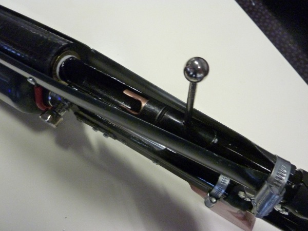

Its hard to see how the gun is triggered and how you made the hammer valve? can you please comment on this to clarify??.......

Thx guys!
i attached a diagram of the system.
The trigger is made from a bend piece of metal and a piece of a beerbottle opener.. The valve is firmly closed by a big spring, so the spring behind the bolt is powerfull as well. i took it from a hi-hat stand.
I still find that paper or plastic arrows are the most accurate. if they fit tight they are very efficient and shoot though my (thin) wall even without a nail in its tip!
AA batteries don't fit well unfortunately..

Yup its my first pneumatic :D i used nail darts, and everything i had laying around in my house, including a piece of Gouda cheese (rubbery stuff that sealed well ;) )
it is pretty accurate and powerfull if the ammo fits well..
the barrel is 50 cm long and the entire thing is 104 cm. and it weights a ton. because of all the metal parts..
The carbon tube around the barrel is for aesthetics and strenght. It also carries the bottle underneath it.

You get 20 shots out of around 200psi.. Must be damn efficient.. What is the power like? Shot at anything solid that you can sort of paint a picture for us?
It looks damn nice.
With your hammer valve setup, how good is the seal between where the yellow piece runs back into the black piece? Im worried if I tried to implement this with an o-ring detent setup it might not shoot, and and the air would just seep through the seal there..

Did you build the hammer-valve yourself?
Because I can't tell that from the pics. Do you have better resolution ones, especially from the valve?
Is this a "hammer-spring-adjustment-screw" in the back of the stock?
If yes, I like it! Is it accessible from the back of the stock, without removing the wood-part?

Yes the screw is for adjustments to the spring ;)
