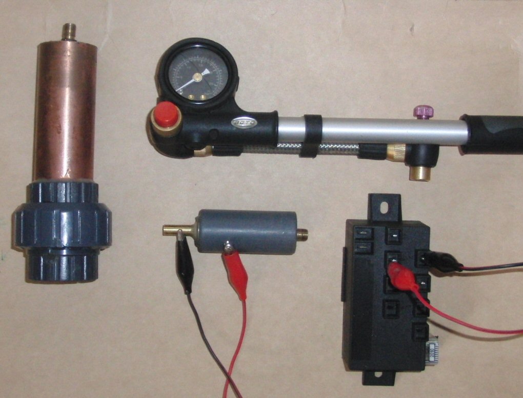

Just tested the project mentioned here, works nicely. Here it is at 10x filmed at 420 frames per second and 14x filmed at real time:
As you can see power isn't spectacular, a 1 gram 0.22" pellet won't go through the base of a soup tin - but considering the 45mm long barrel and 3.5mL chamber volume it's hardly surprising.
Still, the concept works. Also of note is that I used a larger version of my originalfill rig to fill it, meaning the schrader valve is superfluous and I can simplify the design to this.
Here's the internals excluding the PVC sleeving:
Here's the filling and firing setup:

Nothing for this particular prototype, something happened after the 14x test and it's leaking through the barrel. The seal isn't exactly heavy duty so I wasn't expecting it to last anyway, this was just a proof-of-concept test.
