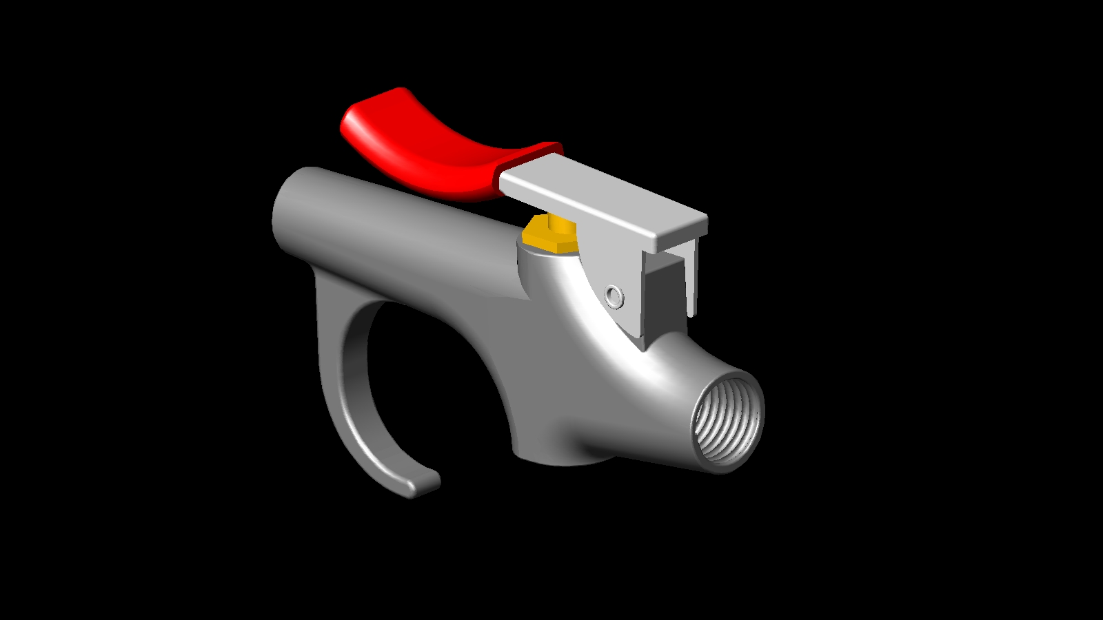

Here is a blowgun I added to Sketchup collection.
