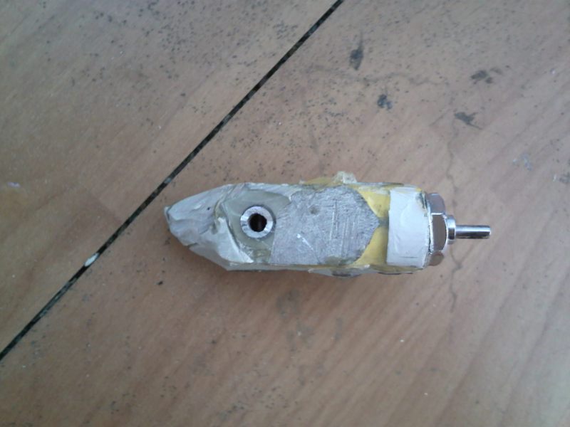

drill a hole on the buttom of the valve body, it will be used to connected to the chamber. When finished, assemble all the parts back together and the valve is done.

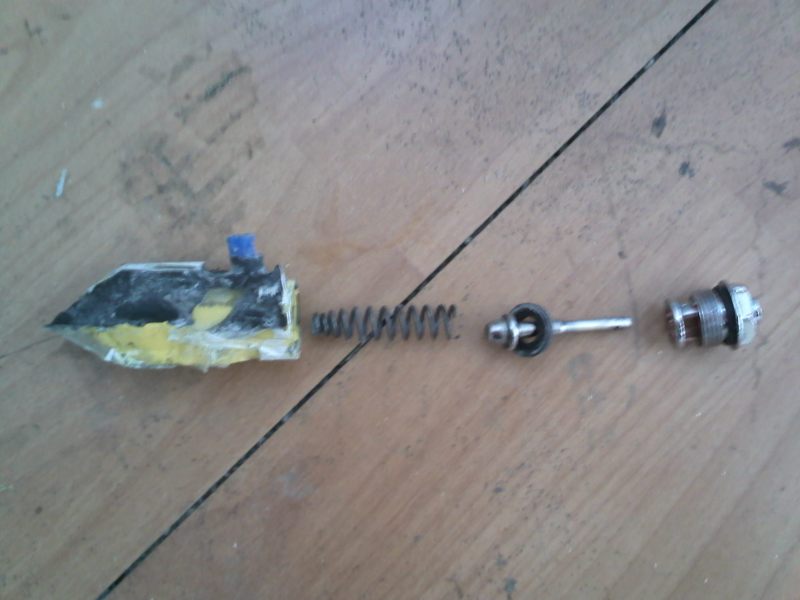

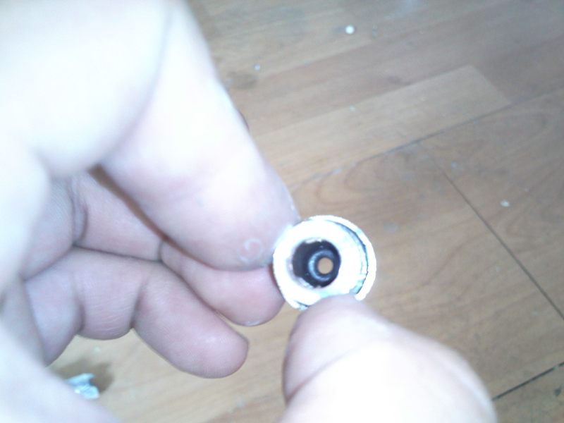

This is the end cap, it has a o´ring to seal the valve stem, you can remove the o-ring and drill a bleed hole if you want semi or full auto (I´m trying that)
open the valve, replace the spring using a weaker one if you want(not absolutely necessary), and replace that rubber disc using a harder one, so it won´t be crashed under high pressure.

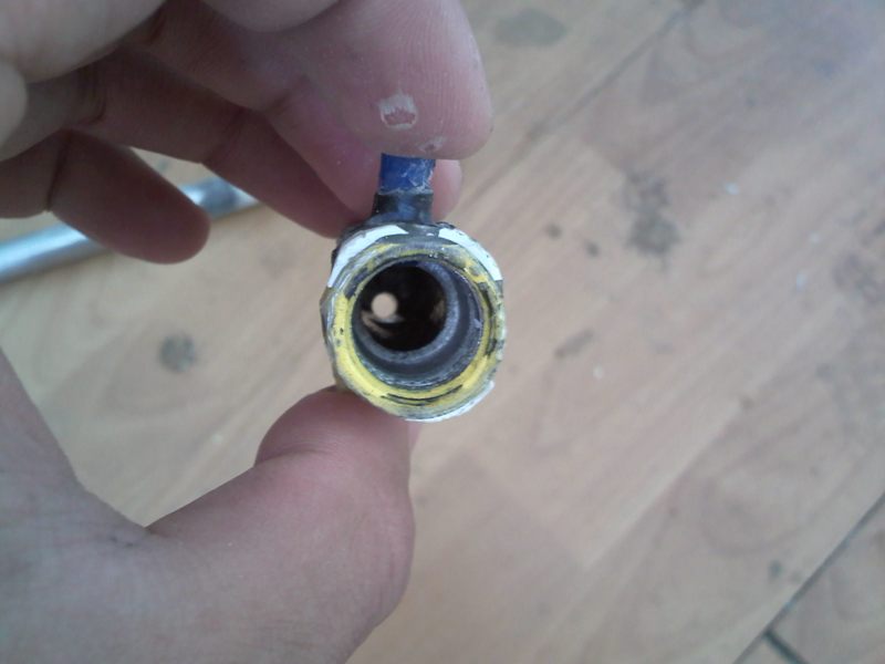

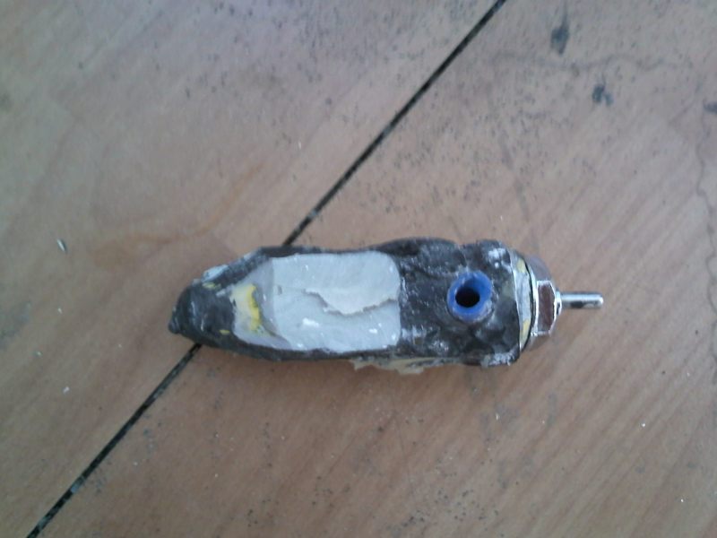

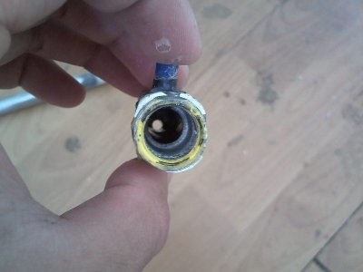

the output hole
the output hole
the input hole, I used to connect it directly to my chamber, but in this tutorial, I´m going to block it with epoxy

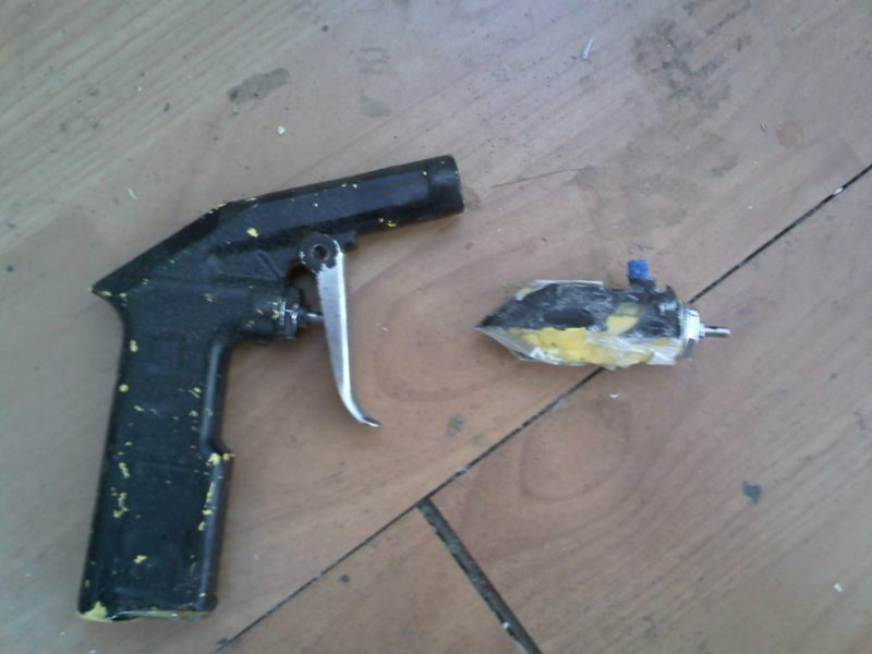

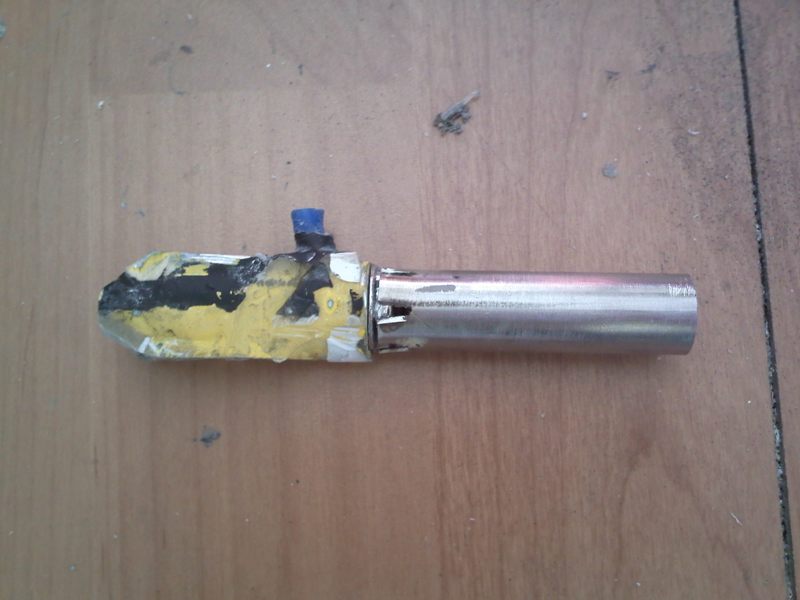

first, cut the valve section of the blowgun

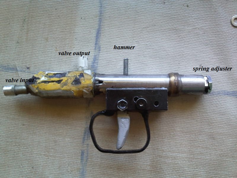

diagram about chamber+valve assemble

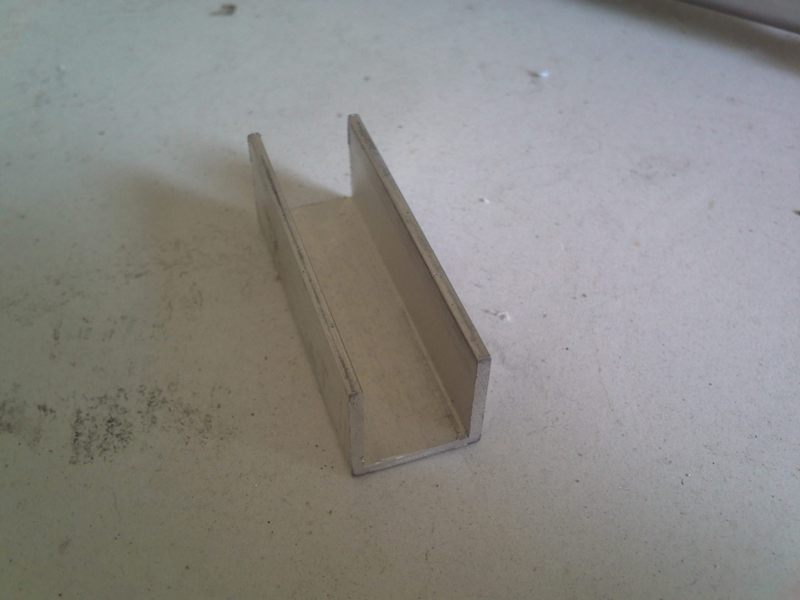

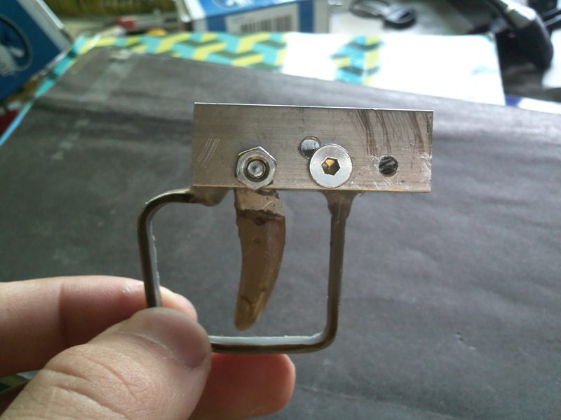

the trigger mecanism housing, I just used groove aluminium. lenth dependes the size of you trigger

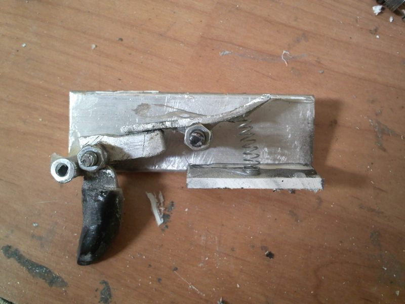

the trigger mecanism, all cutted from a aluminium plate, but this mecanism can be only used in single/full auto .

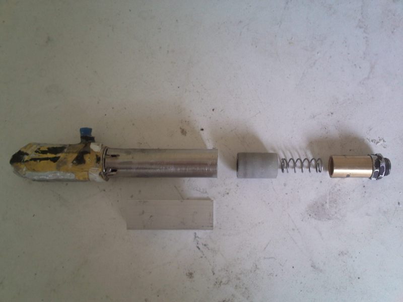

striker+spring+adjusttble end cap. striker made with a solid steel core, them covered with epoxy to match the same id as the 1/2 tube, because I need it to be relativelly air tight for semi/full auto. you could use anything you want that workes
epoxy them, it should looks like this
cut some 1/2 tube, lenth depende the spring you are going to use. and cut 6 grooves so it fits on the end cap of the blowgun

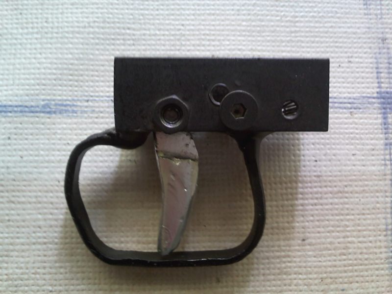

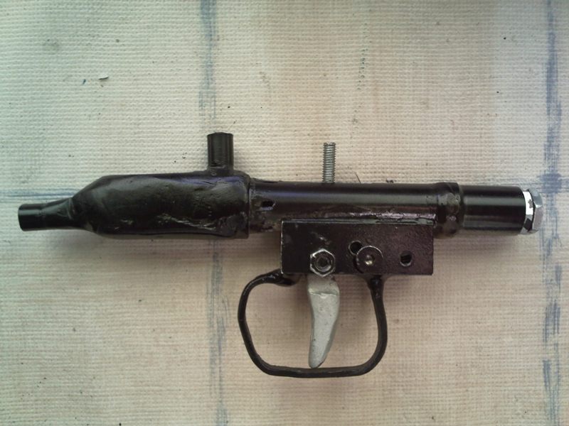

finished trigger
finished trigger
finished :D still needs a paint job and some fiberglass retouch
