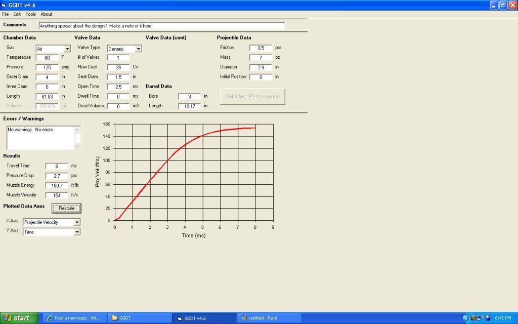

I am designing a water balloon launcher, and am trying to calculate the optimum C:B Ratio for a gun with 72" length. I am using a 4" aluminum pipe for chamber and a 3" aluminum pipe for barrel. I am using a 1.5" solenoid valve with a CV of 29.
I am just surprised by the c:b ratio recommended. I am not sure if I entered info correctly, especially in the valve section. Any help is appreciated. Thanks

Why does GGDT give low FPS result with a faster valve open time? I was thinking maybe it meant how long the valve is open, but that's cant be the case either since setting it high also kills FPS.
Wed Aug 31, 2011 6:23 pm
The problem with the low FPS is the dwell time. Try again with a dwell time of at least 20ms. It is simulating a hammer valve which opens for 2.5ms and is closed again due to no dwell time. The air in the barrel continues to expand and the power rapidly drops off early.

I ran a calculation using a burst disk of 1.5" and a CV of 29 and got a totally different suggestion. Said to use a 21" 264cc Chamber and a 51" 360cc barrel. Totally confused.
Wed Aug 31, 2011 7:08 pm
Dwell time on a burst disk is > one second. Once open, it remains open. :D

So when I change the dwell time, it says "ms" for the units of measure, guessing milliseconds. So wouldn't a solenoid valve remain open until the gas vents the chamber so wouldn't it be the same as a burst disk for this?

After running some calculations on GGDT it calculated that the optimum barrel configuration for a gun with a 3" barrel and chamber would be a 24" chamber and a 48" barrel @ 125psi. I thought that the general consensus was the opposite for pneumatic guns.

GGDT doesn't optimize the lengths by performance. Rather by efficiency. At a certain point, a larger chamber starts to give back not as much gain, and this is where GGDT cuts it off. Making the chamber larger, however, will still give you much better performance.
