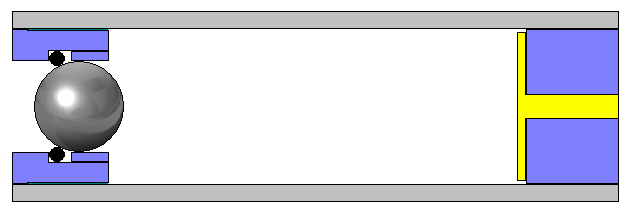

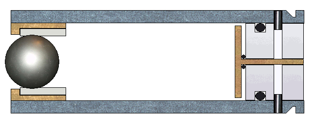

Why would this work
there are no orings on the piston so it should equalise
ramses
Posts: 1679
Fri Sep 09, 2011 2:05 pm
POLAND_SPUD wrote:
Why would this work
You will still probably need a spring, otherwise the piston will never be motivated to move forward to seal (until you depressurize the fill rig). There would be equal force on both sides of the piston.
Fri Sep 09, 2011 3:06 pm
Hmm I guess you're right
A spring would be useful... though the filling rig would neeed a pin for depressing the piston as the cartridge is filled
Personally I think that a detent based cartridge would be better...
though it's hard to tell what is better a detent based cartridge that has issues with sealing or a more complicated and difficult to build piston based cartridge

A spring would be useful... though the filling rig would need a pin for depressing the piston as the cartridge is filled
The spring doesn't have to be unnessecarily strong. It only has to hold the piston forward, it doesn't need to hold back ignition pressure. Due to the relatively large piston surface, it won't take much pressure to move the piston in order to fill the cartridge.
mind you the ID of the barrel is 5.5mm
for a pneumatic it wouldn't be a big deal... but a spring will have an effect on fueling

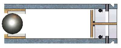

Here's the basic idea for filling:
1) cartridge placed in rig, and fuel (calculated to give a correct ratio for a correct mix taking the fill rig volume into account as well) is injected
2) the rig is capped and taken up to correct pressure. There are no airtight parts in the cartridge so both chamber and "pilot" are pressurised.
3) the rig is depressurised through the schrader, and the pressure imbalance causes the piston to shut, sealing off the cartridge.
A weak spring keeping the piston shut would be helpful with reliability though...
Will try to conjure up a prototype today.

POLAND_SPUD wrote:Personally I think that a detent based cartridge would be better...
That fact is inescapable. A coaxial piston cartridge of given dimensions will invariable be more complex to put together and be less powerful than a "valveless" cartridge of equivalent size.
Hmmm...
Sat Sep 10, 2011 8:00 am
yup... orings
orrrrr
if it works for copper it should work for lead :-D
not sure if it would be better to use the projectile itself as the seal or would you need a seperate olive...
the more I think about this the more the better the idea seems

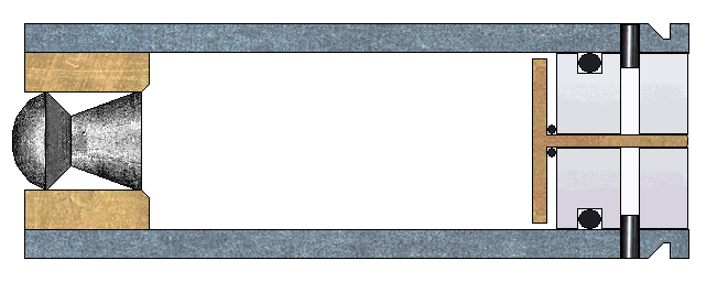

Why not fill the cartridge through the barrel port?
Thread it and you don't need the rig thing.
You might even be able to put it in a compression fitting whilst filling....
I would throw in the spring though.
It will keep that portion of the gas from escaping that split second of decompressing the barrel port.

Brian the brain wrote:Why not fill the cartridge through the barrel port?
I had contemplated this for another design but the fill rig is a one time build and allows for a much cleaner cartridge
For the piston design a small spring would definitely be helpful.

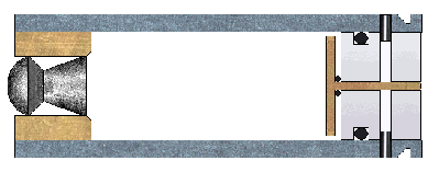

POLAND_SPUD wrote:the more I think about this the more the better the idea seems
I proved it works a while ago.
No need for compression fittings though, the projectile should be forced into a smaller bore. Airgun pellets are typically oversided for their calibre to ensure a good seal.
Here's a thought, avoiding threaded fittings instead having a "full bore" rear plug o-ringed and held by pins for full access and the ability to load the projectile from behind, which would also work for a silicone seal.

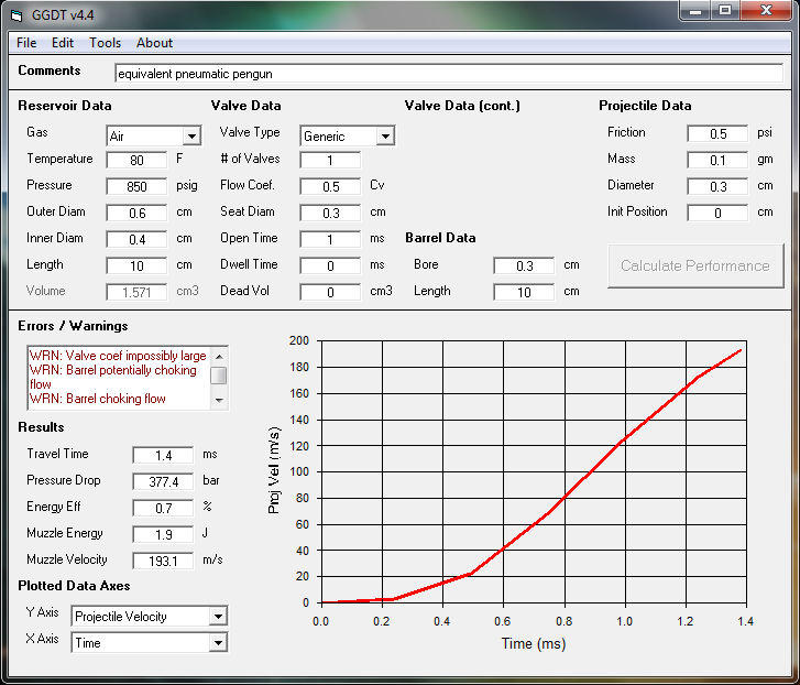

Sun Nov 06, 2011 12:16 am
Giving this a bit of thought again for a pen gun cartridge for starters, looks like it has reasonably good prospects, especially compared to the equivalent HPA pen gun.
