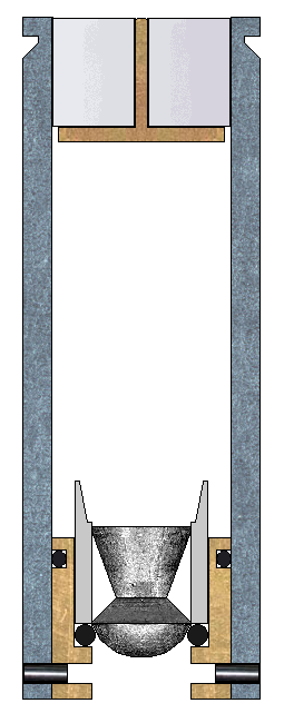

This was my first though for simplifying it, making the rear plug fixed and using the projectile as a valve:
Another variation, this time with a fixed rear plug and single o-ring sealing both forward plug and projectile. I reckon I could make this 7mm ID/9mm OD and 45-50mm long for a 0.177" projectile, giving a "realistic" cartridge size and reasonable power at high mixes.

It holds pressure well enough but couldn't get it to ignite at 10x. Eventually got it to ignite at 20x but as you can see, I missed one of the pins falling out.
Needs some work.

Some further testing, took it right up to 28x and no joy. Video at 210 frames per second, if you look at the rear part of the cartridge it glows indicating combustion half way through the clip:
The detent however is simply too good
it doesn't help that the o-ring is compressed further by the hot gasses, increasing its grip on the BB.
According to HGDT, internal pressure exceeds 3000 psi.
The Delrin seems to be holding up well to the high temperatures.
i tried, what looks to be a similar sized oring, with a .177 BB in a penu, I was unable to get it to pop at 1000 psi... and stopped there.
I am very surprised that it did not pop at 3000 psi though!

Theoretically speaking you could go past 28X and see what happens
Though I guess it would be easier and safer to use a different o-ring

ya I was also amazed about the detent power of a o-ring, even it looks and feels so easy for a bb to pass, it still needed more than 300 psi to work in my case, so now I make my detentes out of a rubber cube
and worked great
Internal diameter is 3mm - 1/8", I tried using a 3mm bearing with the cartridge but it's too loose.jhalek90 wrote:I am very surprised that it did not pop at 3000 psi though!
I'm sticking to atmospheric pressure fuel metering for now, besides the design compresses the o-ring the higher the pressure so I don't think upping the mix is a solution.Theoretically speaking you could go past 28X and see what happens
The next o-ring size is 4mm ID/8mm OD so it could be done.Though I guess it would be easier and safer to use a different o-ring

.117 is wimpy but a 6mm or 9mm lead BB cartridge could be pretty impressive... esspecially considering the miniscule chamber volume... I sense a possible suppresed hybrid
Damn I wish I had a lathe (envy)
If I perfect it I suppose I could offer a limited run of say fill rig and 5 carts for under 50 euros...POLAND_SPUD wrote:so if it works... how much do you charge for one cartridge ?
That's the long term goal, really I want it to use 0.22" pellets but wanted to try something smaller because a hybrid "pocket pistol" is also on my list.117 is wimpy but a 6mm or 9mm lead BB cartridge could be pretty impressive... esspecially considering the miniscule chamber volume... I sense a possible suppresed hybrid
