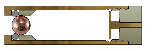

Thu Sep 22, 2011 9:49 am
Oh, I meant to post this the other day, but was at work and forgot.
Part sizes are a bit random (fat o-ring :D), the bore is .22 though.
Oh and that front section is meant to be threaded, not sure what I did there.
Edit: Oh and I meant to make the O-ring compression stop a bit longer.
Also Edit: I meant to drill a couple of holes in the srew in brass bit, to be able to unscrew it, with a handy custom tool ?

Looks great but unless you use thread tape... or have I missed something?

Yeah no tape would be better. Tapered thread? Or O-ring on the brass or Delrin ring. The delrin plug should seal depending on the fit but I guess an o-ring or rubber washer could be used.
...or just drop the compression stop and use a closer to bore size cartridge like the last prototype.

al-xg wrote:Yeah no tape would be better. Tapered thread? Or O-ring on the brass or Delrin ring. The delrin plug should seal depending on the fit but I guess an o-ring or rubber washer could be used.
A groove in the delrin ring should allow it to act like a parachute seal.

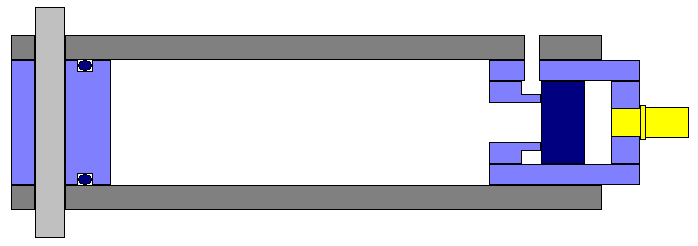

What is critical is that the pressure drop on the outside of the fill rig should be dramatic. At the moment I'm just using the fill schrader, I'm wondering if I should add an exhaust valve, or perhaps an adjustable pop-off that automatically drops the pressure once the desired mix number is achieved.

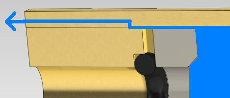

3 way valve + regulator + syringe -> automated syringe metering :)
Oh and while I'm at work...
Some more useless 3D. I just like using the program :)
Obviously the O-ring wouldn't be used with the cup. (that sounds worse than I thought)
Been there (I understand you're referring to the fact that detents need to reach a given minimal pressure to work correctly)
Get a 1/8" QEV and a 3 way

Could one not just chuck a spring in there?
Fri Sep 23, 2011 12:21 pm
to keep the ammo pressed against the oring ??
hmm you might be right

Between the ring and the check valve, coil diameter close to the cartridge ID. Fair point with keeping the projectie in place though, I guess one just has to keep the cartridge pointing down while filling.

al-xg wrote:Some more useless 3D. I just like using the program :)
Which one is it by the way?
... rather while emptying the rig, this is what I've been doing.
Better to add one time complexity to the fill rig than complicated every cartridge, this is how I see it:
SolidWorks, very user friendly, probably my preferred choice for CAD now.

Weren't you meant to be venting the filling chamber on disconnecting the schrader ? :?
You should use some sort of quick release plug, or even just an o-ringed threaded cap.
Maybe a large version of one of these schrader connectors:
<img src="http://www.jerzeecustoms.com/images/Gau ... %20001.jpg" width="300" height="200">
to hold the plug in.
