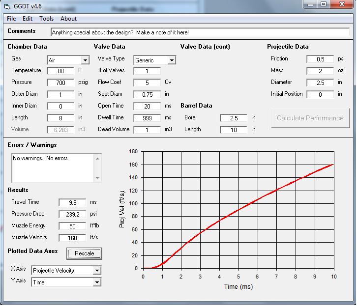

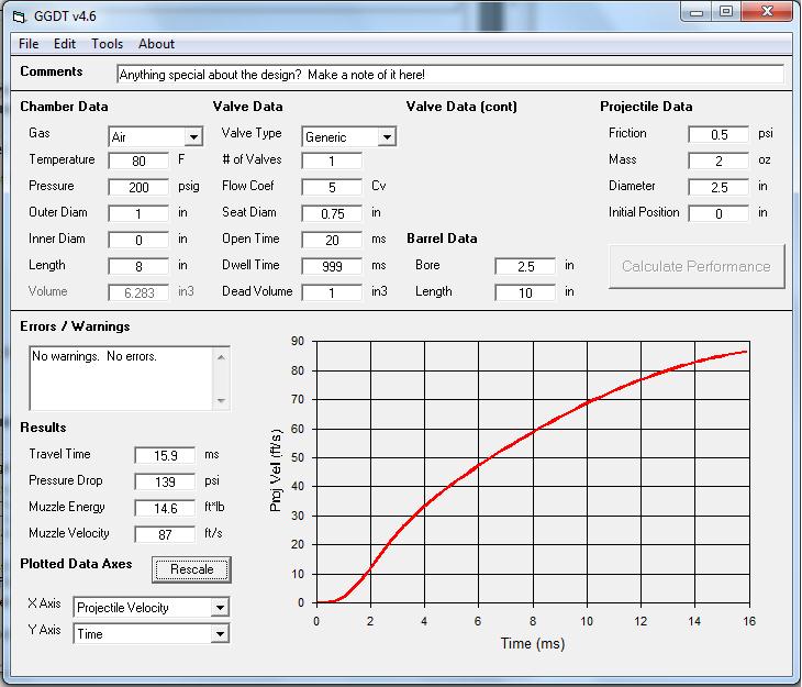

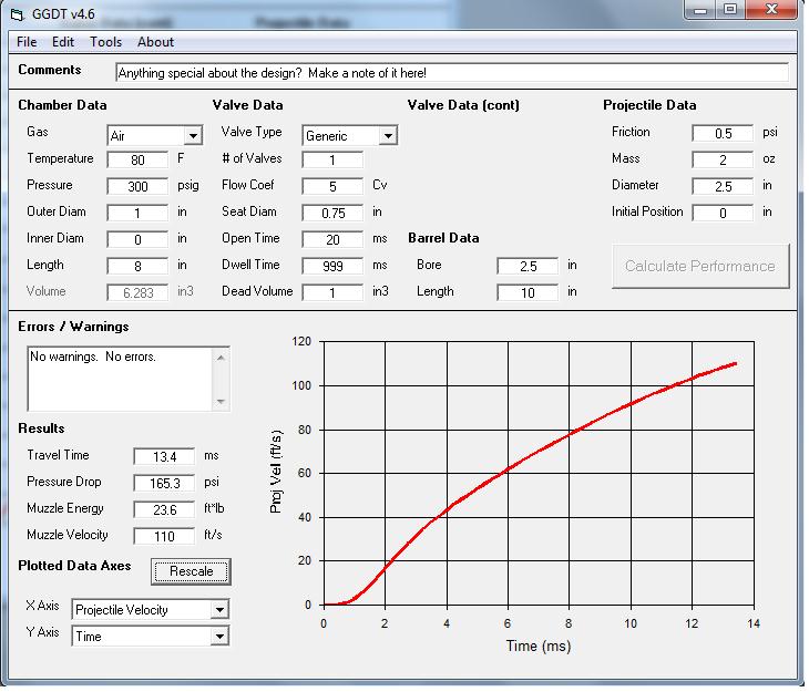

2.5" x 10" tennis ball barrel
1" x 8" chamber
2oz tennis ball with a CD of about .6
Valve:
valve type - generic
# of valves - 1
Flow Coef. - 5
Seat Diam - 0.75 in
Open Time - 20 ms
Dwell Time - 999 ms
Dead Vol - 1 in3
Can I get screenshots at 200, 300, and 700 psi?

Thanks a bunch,
well its a very tight barrel, but those numbers look very low compared to what im actually seeing... I'm getting a 6s hangtime when i fire straight up at about 300psi
