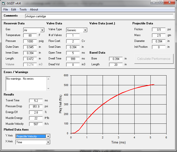

I was working on my accurate drawings of my plans for the shotshell cartridge. (I have decided to make a lever action shotgun first.) I have come across a problem. My shotshell dimensions is 61mm x 24mm. The end plug that houses the schrader valve is 20mm long. The end plug for the barrel is 10mm long. The barrel is 30mm long and 10mm diameter.
I have gone with the design where the schrader valve is hidden inside end plug (JSR's modification to my original cartridge.). Behind the piston there is a 5mm gap where pressure builds up. Infront of the piston is a 12mm gap.
The problem here is that there is barely any room at all for pressure to build. I don't want to decrease the barrel's diameter because my type of ammunition is buckshot. Which in this case is 12 bb's that are 3mm in diameter. I cannot decrease the length of the barrel because that would create more pressure behind the piston and less pressure in front of the piston which means that when I open the pilot valve, the piston will move backwards very slowly. Another problem is these are the dimensions of the cartridge WITHOUT the wall thickness drawn into the design.
So, would anyone be able to help me? I want to have 1000 psi in this cartridge. Do you think it will be able to propell 12 3mm Steel BBs at 300 fps? Lastly, what would be the recommended wall thickness if I want 1000 psi?

Sun Nov 27, 2011 3:44 am
DerpWithAGun wrote:I was working on my accurate drawings of my plans for the shotshell cartridge.
Let's see them :)
With a dimensioned diagram we can do some GGDT modelling.
Depends on the material. A steel CO<sub>2</sub> capsule has a wall thickness of around 0.9mm and will happily hold 1000 psi safely.

I put in all the info I knew onto GGDT and I got this:
Travel Time: 8.5 ms
Pressure Drop: 957.9 psi
Muzzle Energy: 0.3 ft*lb
Muzzle Velocity: 27 ft/s
I probably entered in some of the information wrong but I'm glad you can do it for me :)

hmm, seems like you right about it having practically no chamber volume... Even for 1000 psi thats pretty small... :? Are you sure you cant make it just a bit longer? That 27 f/s actually sounds about right.

Sun Nov 27, 2011 5:38 am
Assuming a 20 inch barrel, 10mm calibre and an extremely thin barrel wall inside the cartridge (:roll:) for 2.5 grams of BBs and sabot I got around 500 fps, pretty healthy.

aha! So my design did work after all? but You said 2.5 grams of BBs. Try it with 10 grams. 12 BBs that are 3mm in diameter is roughly 10 grams. I might just increase the length of my cartridges by 10mm - 20mm just for a bit more power. Thanks a lot JSR! And 500 fps! That's heaps! I think I read on the Farco Air Shotgun website that the Farco got 300 fps.
