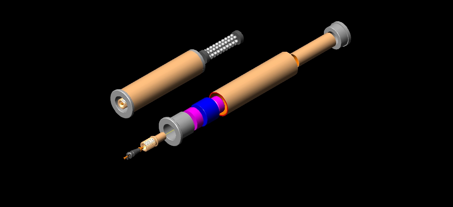

Is this what you are looking for?
3 inch long total, 3/4 inch OD.
DerpWithAGun
Posts: 144
Joined: Sat Jul 30, 2011 10:11 am
Sun Nov 27, 2011 3:45 pm
Wow dewey is that my design in 3D or a different design? It looks like mine.

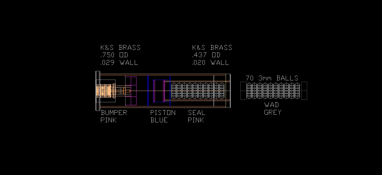

DerpWithAGun wrote:Wow dewey is that my design in 3D or a different design? It looks like mine.
If there is a shotgun shell in real life that is 3 inches long then I'll probably go with that or just increase my design by 1cm.
The design was for a hybrid cartridge that I did for JSR and modified it for a pneumatic cartridge. Here is a wiremesh side view.

Very nice as always dewey!
(I've downloaded sketchup in the meantime... baby steps ;))
I would make the piston out of delrin, this would remove the need for a bumper and possibly seal, and greatly reduce piston travel. The chamber is so small that piston bounce should not be an issue.
