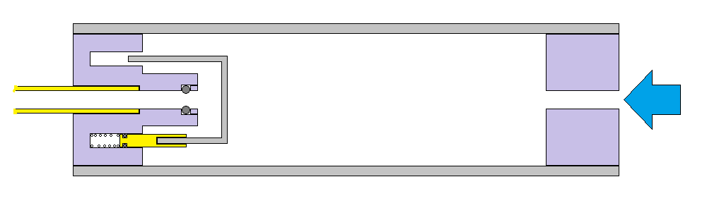

Thinking of a way of making this design practical, here's on idea. The principle is as suggested previously, a BB would jam in the detent, causing pressure to build up in the chamber, causing the piston to compress, blocking off the breech until the BB is fired, depressurising the chamber allowing the piston to return to its rest position and the cycle to be repeated.
warhead052
Posts: 1769
Sat Dec 03, 2011 8:14 pm
I see one problem with that. If the piston is depressed, and air pressure is behind it, wont it get jammed there? And how do the bbs feed into it.
pneumaticcannons
Posts: 392
Sun Dec 04, 2011 10:18 am
I think that the thing that blocks the breech is just a wire(lol I thought it was like a little cup at first too)

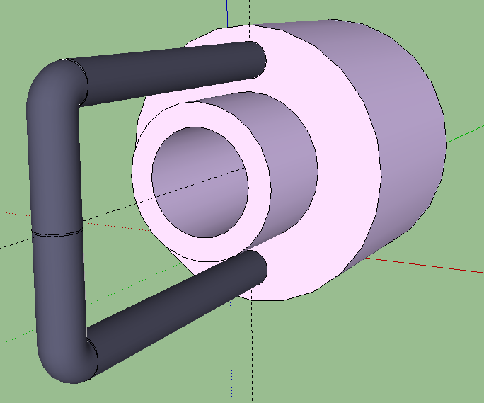

pneumaticcannons wrote:I think that the thing that blocks the breech is just a wire(lol I thought it was like a little cup at first too)
Yep, some mucking around with sketchup later:

There isn't very much area for pressure to act on, that spring would have to be really weak or the area would have to be bigger.
Sun Dec 04, 2011 1:27 pm
*cough*850psi*cough*
Even with a 1mm diameter piston there would be a full pound of force pushing on the blocker.

judging by the bends I'd say he's had it for a while :D

Bends are rather simple to make, and judging by the random circles on the rod I'd say he's new to the program :wink:
