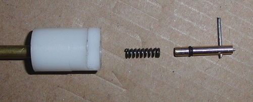

Just an idea, what if you put a bolt behind the spring (left side on the diagram) so you can thread it in and out to adjust the spring pressure? Just a thought.
Tue Dec 06, 2011 3:18 pm
Put it on hold for now, a bit fiddly in the dimensions I chose. Started on something else in the meantime, trying to see if the Monsoon loader will work at lower pressures, watch this space :)

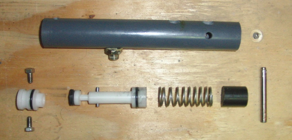

I started on this but realised that my smallest o-ring for the blocket piston wouldn't fit, so I have to remake it with the barrel mounted off-centre.

As for the design I showed here yesterday, it is really from a nerf gun. I took it off some time ago, and hooked it to a blow gun with very small air reservoir at 300 psi. I made a small video of the operation :
http://www.youtube.com/watch?feature=pl ... hDlZ1gc4tA
Wed Dec 07, 2011 5:42 am
As I think I had pointed out in an earlier thread, it's similar to what I did here.
I recently made another prototype based on the above, with the benefit of the lathe, but no real luck, it either cycled extremely fast or not at all, though by restricting the outlet with my finger it was popping away quite happily :)
The problem of projectile feeding remains though, you still have to hook this up to some sort of reloading breech.

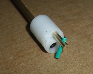

Thu Dec 08, 2011 3:13 pm
Some progress on this, should have it ready for testing tomorrow.
Fri Dec 09, 2011 3:52 pm
Well it sort of works... testing at 850 psi:
I have a feeling cloud feeding is never going to be reliable enough...

JSR I was thinking the same thing about cloud feeding...
what if you used an inline vortex block and had a bolt portrude into the barrel partly, and used some sort of linkage to link it to that spring piston? That way you eliminate the cloud feeding..
I feel like the linkage could be somewhat difficult to implement however..
