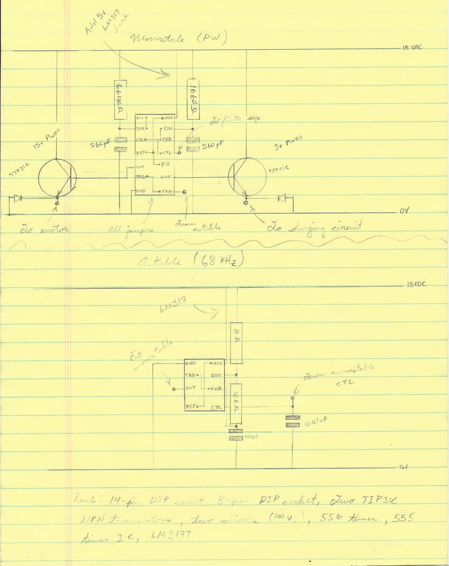

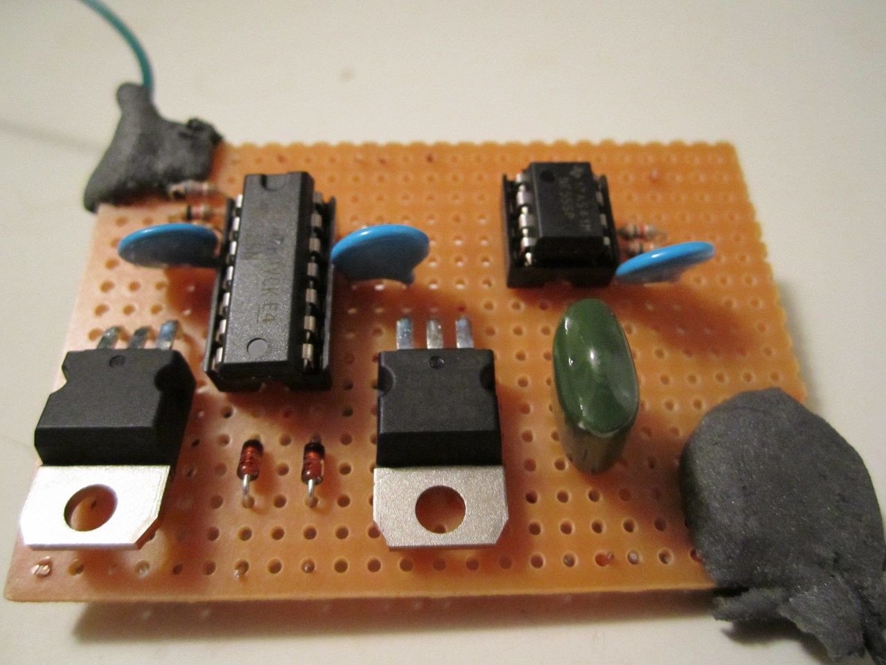

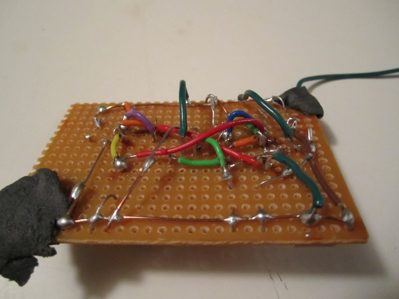

Hmm.... how much are those PCB companies charging these days? :roll:
EDIT: and unsurprisingly, it doesn't work. I double checked my wiring, though, and I think the likely culprit is that I fried the power switching transistors with my 75-watt howitzer/soldering iron.
It was supposed to be a PWM circuit with a 12 and 3VDC output, but all I can measure at the emitters of the switching transistors is 0v.

Mark;
post the schematic you used and the component side of that board.
Posts: 3640
Been thanked: 62 times
Thu Dec 22, 2011 11:41 pm
As you wish:

mark;
I do see some problem areas.
What are you trying to achieve with this circuit design?
A DC motor control and 3 VDC charger?
Why such a high Astable frequency? 68KHz
What kind of motor?
Posts: 3640
Fri Dec 23, 2011 3:17 am
It's basically just to provide two switched power sources without ohmic losses as involved with linear regulators. This is sort of a "proof of concept" circuit.
I suppose I could go lower with the frequency. 68kHz is just one of the "standard" 555 frequencies (made with a 1kohm, 10kohm, and 0.001uF capacitor).
The motor is brushless.
