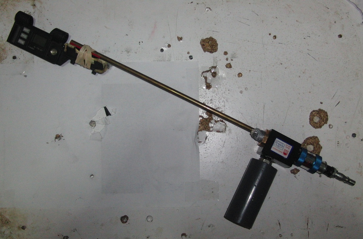

Wed Mar 07, 2012 11:40 pm
In response to some questions about the sort of power available to this setup, I hooked up a 12 inch 6mm barrel and did some chrony testing at 120 psi. The firing chamber volume is around 3.5 cubic inches, a little wasteful but that's what I had ;)

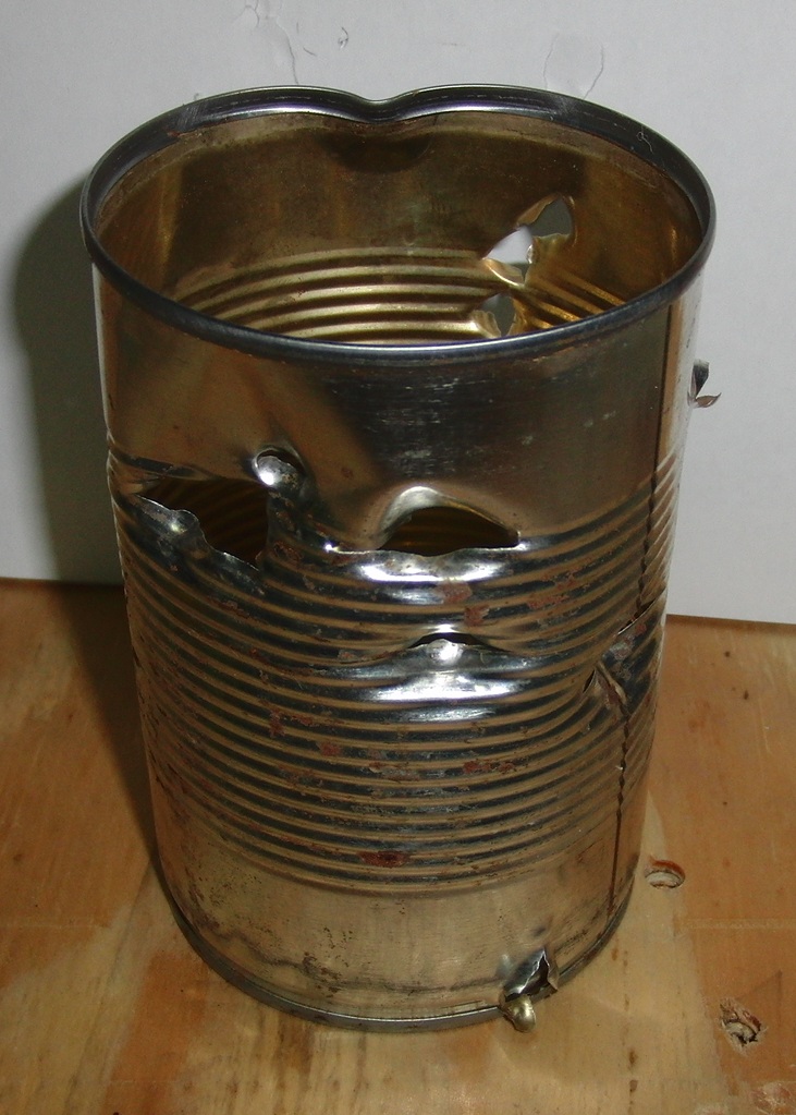

Using 0.25g airsoft BBs, I got an average velocity of 590 fps, more than enough to punch through a soup tin. With some adapted 1 gram 0.22" pellets I got an average of 355 feet per second, fairly decent.
In short, even at relatively low pressures with a relatively short barrel, this valve setup packs quite a punch. For say a field legal airsoft sniper, if you fit a longer barrel you could get away with much, much less pressure, a regulated main chamber would last a long time.
Conversely, increasing barrel length and/or calibre, and upping the pressure, you have enough power available to do some serious damage. I might do some testing with steel BBs and marbles down the line.
Some photos, my test setup with Combro CB-625 chrony at the end of the barrel, and a mangled soup tin.
All penetration with 0.25 gram airsoft BBs
