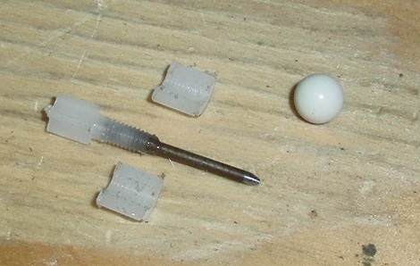

I'm going to make myself a 6mm one to try it out first :)

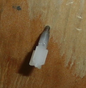

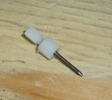

Well, capturing the separation is going to be a bit tricky with the EX-FC100. I didn't get any useful results, fired at just 10 bar. Still, it worked! Good penetration even at low pressure. I think the best way to evaluate separation would be to have some light paper screens at various distances ahead of the muzzle.
One issue I'm seeing with this is that you can't simply make the sabot then cut it up into "petals" because that would leave gaps, you would have to machine each one individually, with a lot of precision, so it would be quite time consuming. Another vote in favour of fullbore fins...

Cut them first then machine them, maybe keep a bit of extra length when you can keep them together and then part off.
I've done this to drill out a split cylinder on the lathe. It was a bigger part though so I actually bolted the parts together. Still wouldn't want to do very many like that though... You could cut multiple sections from the same cylinder I guess, some sort of ring jig could hold the end together, you could also use the tailstock that way...
Although, does the sabot even need to close up fully ?

al-xg wrote:Although, does the sabot even need to close up fully ?
Yes, because there's no sealing plate, any gap between the petals is a space where air can leak through, not very efficient.

The problem here isn't about fit - since the two halves are clamping on the projectile, they still form the correct OD and keep the projectile centred. The issue is that propelling gas can seep past the gaps.

For small quantity testing the cutting in half then turning down and tapping should be fine then.
Delrin is quite hard, so might be a bit of a pain to slice in half, worth a try though, would be a much easier solution.

If you used a simpler external profile than a thread to hold the sabot on in the barrel, you could simply produce two sabot blanks, then mill off half of each one. It's wasteful, but these aren't exactly time consuming, high precision parts you're making. Threads could still be used, but you'd either have to be very precise, or tolerate a bit of mismatch between where each sabot half sits along the length of the dart, which could decrease accuracy. If you don't care about accuracy, it's probably the easiest method - just make the second half longer than it needs to be, and cut off based on where the threads match up.

Good test, I was worried about the gaps created by cutting, that`s why I thought about casting when I was going to do it full scale. I have to use threads as that is the best solution that is readily available IMO.
This pretty much proved the thread part to be sound and that is really all I wanted to know.
To eliminate leakage you have to create two pairs of shorter petals and have them turned 90 degrees on the axis of the penetrator. They should adequately seal.
