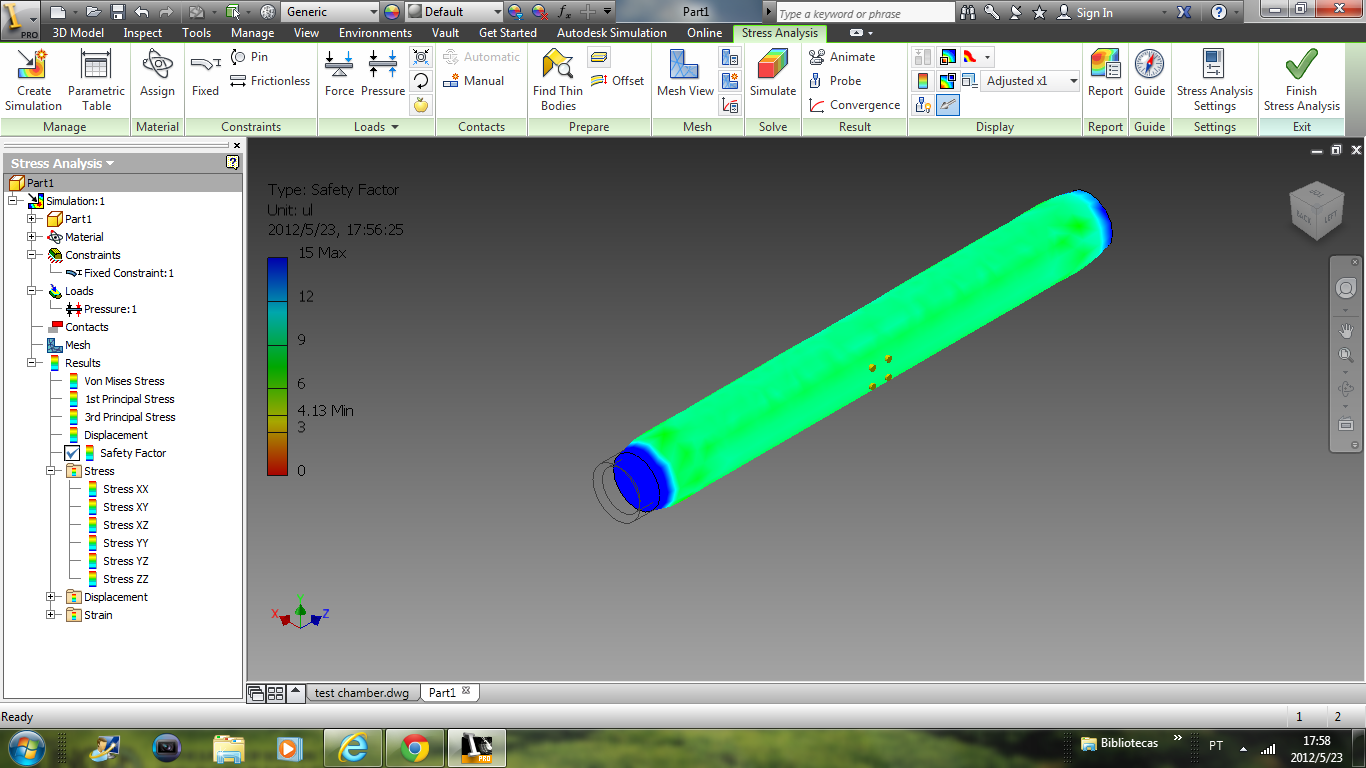

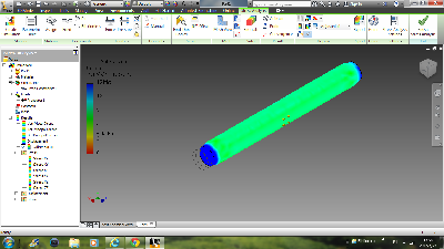

I was simulating using Autodesk Inventor Professional (student version) a chamber for my pcp, but I think I have done something wrong
Material: stainless steel, 440C
length: 10 inch
OD: 1 inch
Wall: 1 inch
Pressure: 3750psi (250bar)
It shows a minim safety factor of about 2, but I can see the chamber gets deformed quite noticeably
I´m pretty sure that I did something stupid
I´m studing how to use Autodesk Simulation Multiphysics, but haven´t be able to use it effectivelly yet.
A picture of what I´m trying to do. The model it´s just a cylinder, I made it just to see how the simulation works. I can create parts far better than that
length: 10 inch
OD: 1 inch
Wall: 1 inch

uhmm IIRC that's perfectly normal - the program presents them in this blown out of proportion way so that they are easier to notice

Ah that makes sense, because when I did the same simulation in multiphysics, nothing happened. Well anyway safety factor (in yield strength) 2 isn't safe enough but 0.15 inch wall thickness brings the minimum safety factor to around 4, so I'm pretty sure about the chamber size/material now.

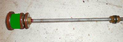

but would making a epoxy cylinder to make the rod the dia of the piston reducing the back of the sealing face surface area for pressure to push agianst?.
- mod to piston..JPG (12.25 KiB) Viewed 4623 times

dam really don't wanna reduce the seat dia, because i want it to be decent with golf ball as well as smaller ammo too, right now HGDT is saying 110ms with a golf ball at 10x disk bursting at 1000psi.

Unless your chamber is pretty small I reckon you'll get a lot better than that.
You could always change the tee diameter but that means you'll need a new piston. How much investment have you put in to that piston anyway? Is it all epoxied up and what not?

all I spent i on this is buying a mapp torch for it, i got the fittings from work because my boss told me to throw out a box full of them i took them home lol. the piston is only lock tighted together, not hard to take apart.
you said reduce sealing face to 27mm i can do that.

Actually, I'm not sure why I said that. Maybe I used the original sealing face area outside the seat instead of the revised one when the sealing face is changed to 27mm. I just checked the back of the book where I was working it all out and there are just numbers from all over the place, including my o-ring calculations
If you make the piston diameter 27mm it would work though
