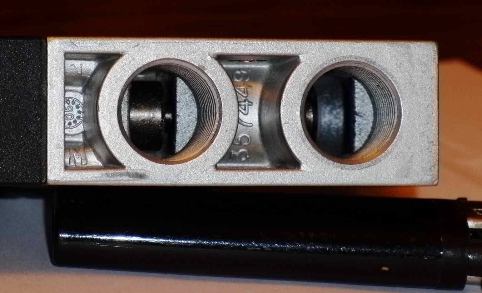

nice find... you should be able to use it as the main valve for a 6mm gunAs you can see in the diagram on it, it is a indirect acting, normally open valve, with 3/8 female ports, rated to 10bar and 2500 l/min flow-rate.
Probably up to 20bar- How much above 10bar can I go safely, without destroying the valve?

Thanks for the quick reply guys!
Maybe even enough for 9mm. I'm planing to test that, the difference in velocity between dcv+qev and dcv only with 9mm steel-balls.
the rhombus-shaped thing with a diode in the center seems to be a bridge rectifier, only there to power the LED (with a series resister). Because it doesn't rectifier anything more than the LED-circuit.
Couldn't it be that way, that the "48VAC/DC 4A" is just the maximum voltage and power the adapter/solenoid could tolerate?
And I can run it on minimum 24 and maximum 48 volt ac or dc ?
(because there doesn't seem to be any step-down-voltage-controller (don't know if this is the proper engl. expression), like 48->24V built into the circuit)
But that would interfere with the printing on the solenoid saying: 20,4-26,4V DC...
mhhmmm...
That might be the case because it is a indirect acting one, I assume yours is a direct acting one, because of that high power input.irisher wrote:my significantly smaller 3-way takes 25 watts so 1.5 seems a little low
Actually I want to use it with a 3/8 QEV, but that seems to be a bit overkill (which has not to be a bad thing...), for 6mm it should have plenty of flow.POLAND_SPUD wrote:you should be able to use it as the main valve for a 6mm gun
That would be really great! Though I hoped it was machined out of one solid block of aluminium, but it turned out to be a cast piece...mhhhmmm...Probably up to 20bar
