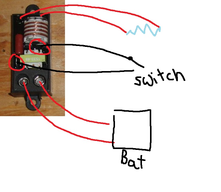

is it possible you could draw a a simple wiring diagram :)
Mon Sep 03, 2012 3:42 am
Here you go, red is low voltage wire, blue is high voltage

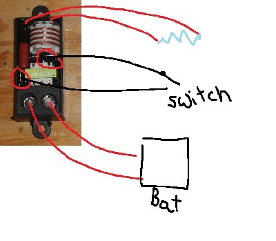

I'd just like to point out that the igniter won't work if you place a switch in the circuit with the battery. You can connect the battery directly and nothing will happen. The switch needs to be placed between the two spade connectors located in this picture, circled in red.
Or else put a switch in the battery circuit and just short the two spade connectors together.
Wire it like this
Wire it like this
Fri Oct 05, 2012 12:05 am
Right you are, forgot the switch terminals were separate.

the ignitor from USG can be connected directly to a battery ( at least from the one i got from USG ), if you do, it will continue to ignite untill the battery is empty.
So the first drawing Jack made will work (at least it works on my gun), and i would suggest u get a 9v battery connector, to make the whiring easyer.
