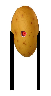

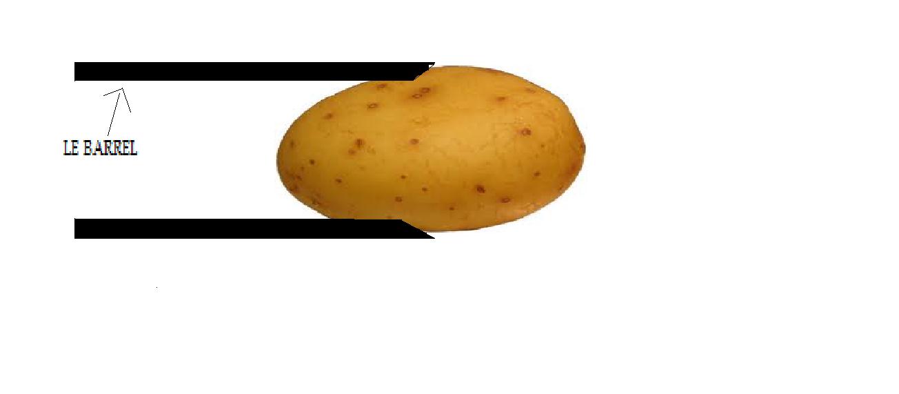

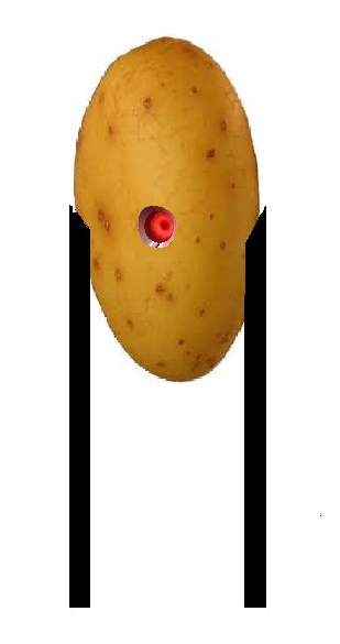

try put a internal chamfer on the barrel barrel so you cut over size spuds that fit the bore tighter.

Oh, now i see. I'm gonna give this a try.

The valves are fine. The leak was coming out the side of the barrel through a small hole that was made from a screw thats holding the handles of the gun.
Yes, i do have a cap on the back.
The main problem was the spud night getting a tight enough fit when it goes down the barrel. But that problem and the leak has been fixed. I also put a new fan in the chamber today.
