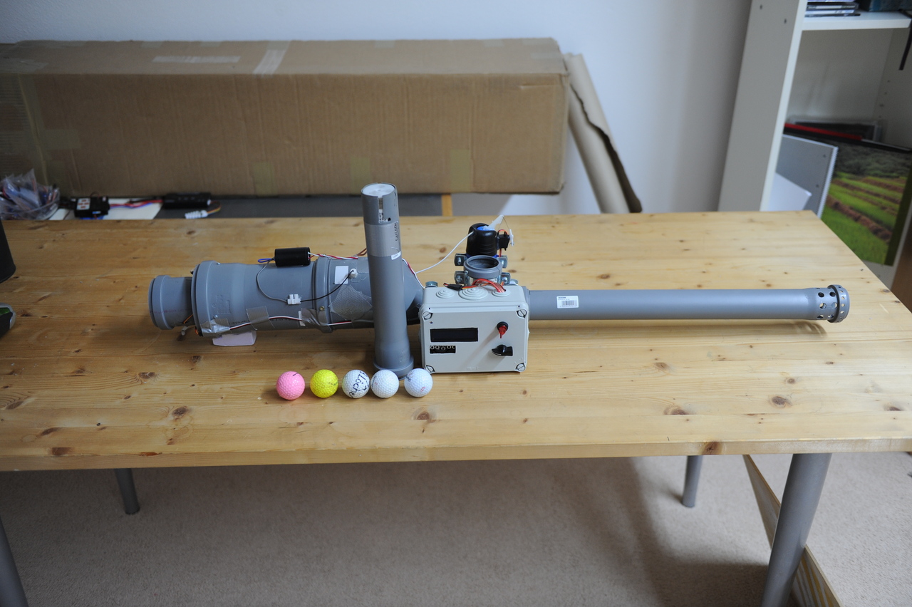

i just wanted to share with you my first spudgun i have build.
I tried to do it "First Time Right", and not go with a simple kiddie-spudgun...
The idea was to have a full automated spudgun that is portable.
One major goal of the project was to achieve 1shot per second. Right now i achieve a cycle time of 1.2seconds, but there is room for improvement. The Loading and venting times can be reduced as is assume....
For ammunition i use golf balls. The power of the gun is, as i assume, average "low". High power was never o big goal for the project.
A typical problem found is the heat-up of the barrel. After each magazin (5shots) is empty, the temperature of the barrel is pretty high --> 50°C. The gun is constantly cooled, but this seems to be not enough for a longer fire sequences.
Overal weight is 2.5kg.
As propellant deodorant is used.
Venting system utilises a EDF.
All mechanical actions are done by Servos.
I try to upload a video of it in action later...
Fell free to tell me what you think of it....

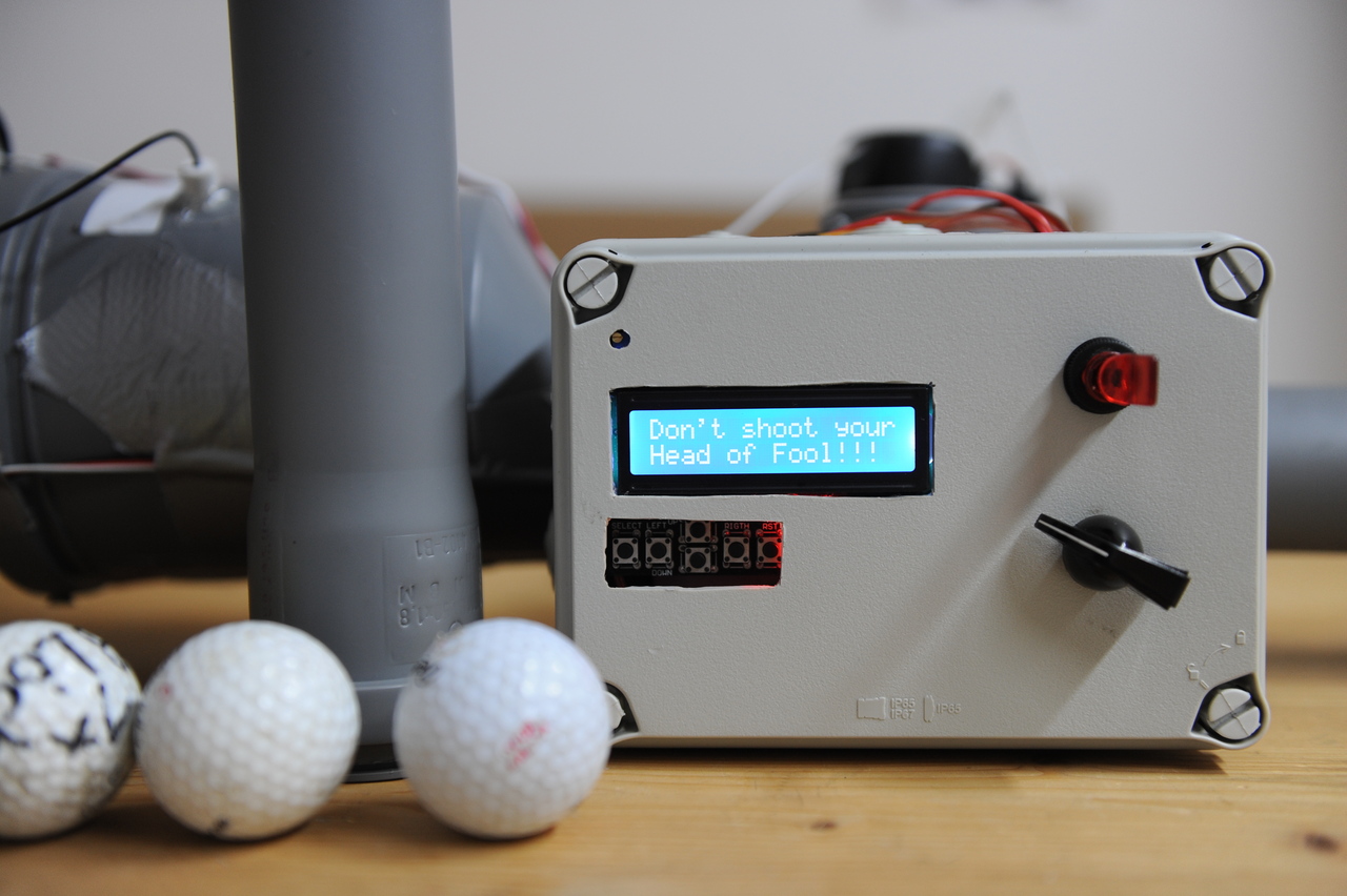

Control Unit
Control Unit

Mon Mar 11, 2013 3:07 pm
Fantastic!
Some more details of the mechanism would be great :)
How are you venting the chamber between shots?
You should really consider propane or butane as a fuel source, a simple way to get more consistency and power.

Mon Mar 11, 2013 4:10 pm
I see a hybrid version appearing in the near future..
:D
awesome job!
I assume it functions like a gaspowered nailer?
A "cool" solution to your heating problem may be to shroud the barrel and fill it with water like they did on the Maxim machineguns in WWI...
Without any means of circulating the coolant I reckon you could do 10 shots without any problems.
replacing the barrel by a copper one with a heatshield ( to protect your hands) would probably work aswell.

Tue Mar 12, 2013 10:40 am
Heer is a principle sketch i did today.
More details will follow later this evening...
Principle sketch
Principle sketch

Tue Mar 12, 2013 2:33 pm
Hi,
I try to answer questions and add information whenever I find time.
The deodorant is measured by an timer. I can select the injection time in 25ms steps.
The gun is controlled by an arduino micro controller.
I can contol the ESC that controls the EDF. On top the EDF I have a valve, that is closedd by a servo. Then I have the injection-servo, and the loader-servo.
The ignition module is controlled by a relais.
The EDF is always running at low speed.
When I start the fire-sequence the controller is doing the following:
1. Close the valve
2. Open the loader to load a golf ball in the barrel.
2.a start injecting
3. Wait the given injection time
4. Start ignition
5. Open valve
6. Wait for given time
--> the edf blows all used-air through the barrel out of the gun
-------> the gun is ready for the next shot
I now have to optimize the EDF speed and the venting time to allow more than 1 shot per second.
I doubt that I will more consistent inject times with butane/propane. Maybe the bang is better, but I need way more stuff to controlled it.
Even a nearly empty deodorant can needs little adjustments on inject time. I just go from 350 to 400ms, and I can continue to fire....
The adjust man can be made from the shooting menu, and permanently stored to the EEPROM later in the programming mode... :-)
For cooling I have a special mode, that opens the valve and blows constant fresh air in the gun. After about 1min the gun is pretty cold again.
The most useful mode is the BBQ mode!! Very handy to fire up the coal on the summer BBQ. :D
