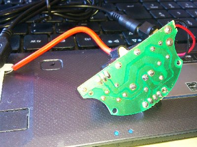

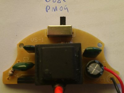

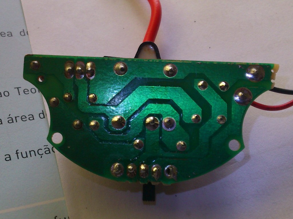

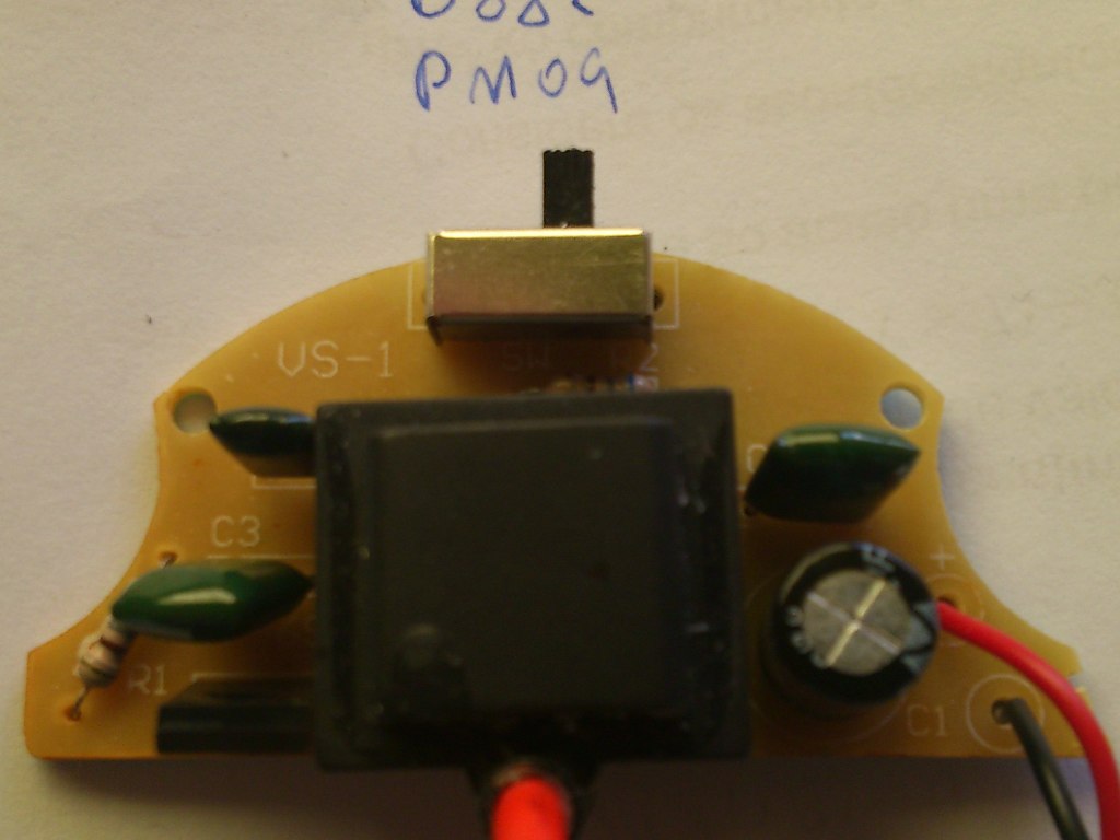

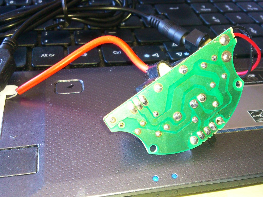

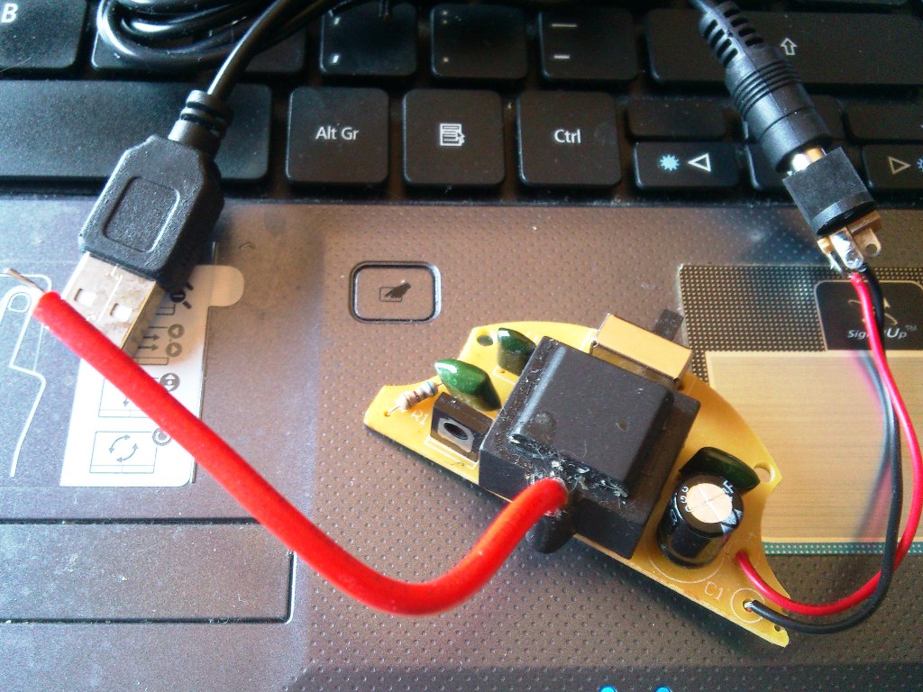

Is it possible to make a ignition system from a plasma ball? I've seen one here that did that.
I mean for any transformer there must be 2 output right? Here are the photos, why is there only one output wire :?
dewey-1
Posts: 1298
Location: NE Wisconsin USA
Wed Apr 17, 2013 1:07 pm
The other lead is basically the Black lead.
You will see two pins of transformer are connected to Black which is ground.
If you can give me a direct overhead close up and a view of all the values of parts I can create a schematic.
Any part numbers on components would help.
wyz2285
Austria
Posts: 2388
Location: Porto, Portugal
Wed Apr 17, 2013 1:28 pm
So basically I just have to weld a wire from the 2 points and the spark will happen between the wire and the red wire?
Q1: NEC D882 PMO9<br />C3: 2A473J<br />C4: 2A103J (above C3)<br />C2: AA473J (above C1)<br />C1: 16V 470UF<br />That's all I got
Q1: NEC D882 PMO9
C3: 2A473J
C1: 16V 470UF
That's all I got
