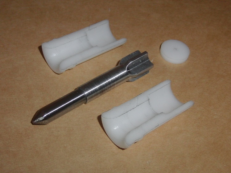

Yep, I should have known better, those first rounds were a combination of lazy machining and mindless optimism.
On acceleration, the core slipped through the delrin tail (where it was only a push fit) and dug into the shot cup.
Both factors have now been taken into account though, using more supporting sabots to stop the projectiles yawing in the barrel, and delrin disks to reinforce the base of the shot cup.
Here's the latest batch for demolition ranch, I've been machining like crazy lately to reduce my material stocks before moving to Quebec
That's what happened here:DYI wrote:There's also the more obvious failure mode involving the core penetrating the sabot owing to insufficient mechanical strength in the sabot. Have you investigated your safety margin against that happening?
Here's the latest fabriaction, fitted with another set of find approximately at the projectile centre of gravity, so that it can hopefully be fitted directly in the shot cup without the need for extra sabot parts:
