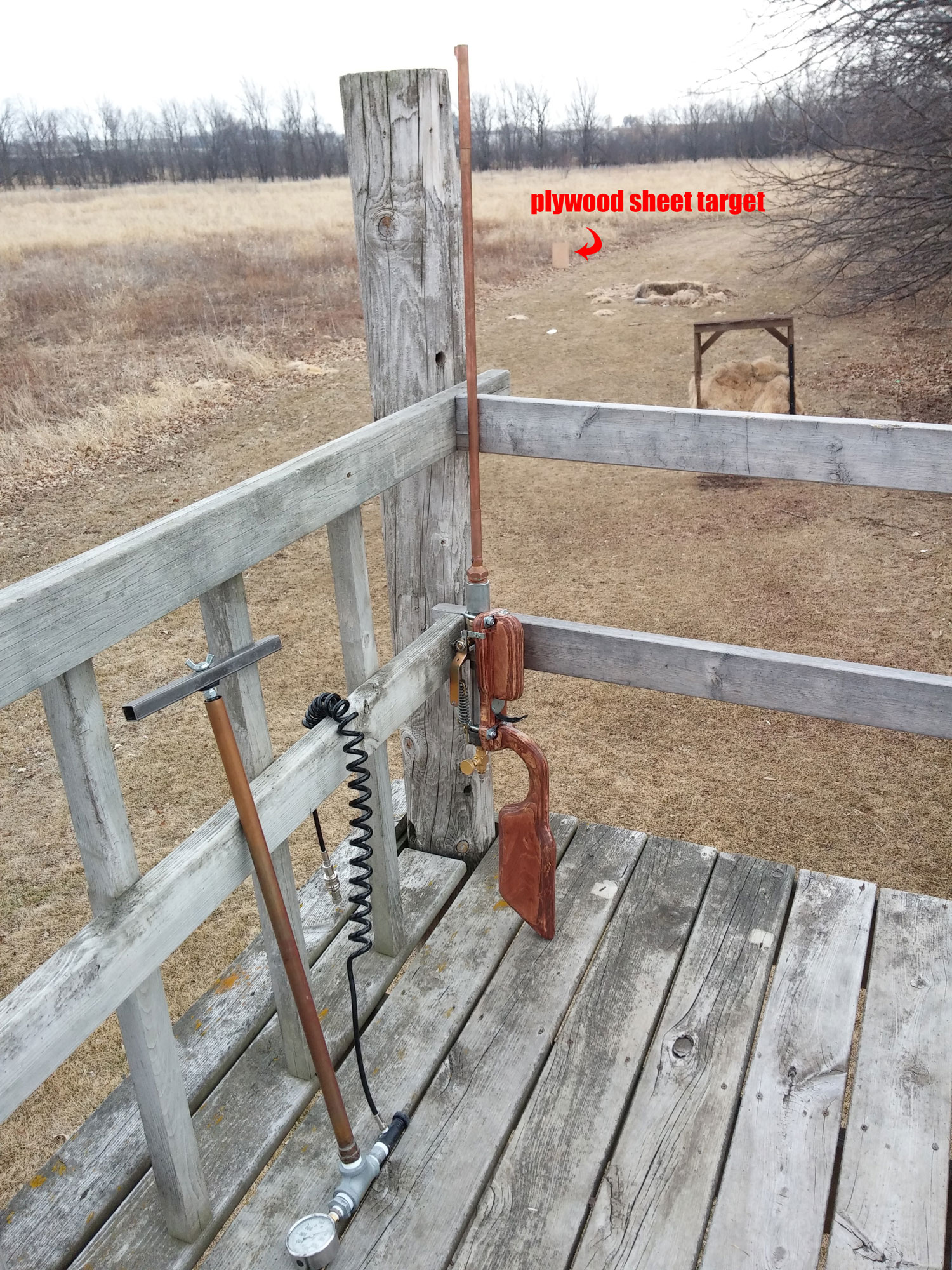

Finally made the stock and forestock for the rifle. Also etched it's name ("Peacebreaker") into the 1" steel pipe using a 9v battery, two wires, and Q-tips dipped in vinegar/salt solution. Now that it's finally getting nice out here in Wisconsin, I plan to make a YouTube video of it in action soon. It's got some nice power in 'er :)

Tue Apr 08, 2014 4:46 pm
interesting stock! like.
SOme people look down on the spring actuated ball valve, but while they are wondering why their piston doesn't seal today or why the buffer is disintegrated or the seal shot downrange, you can actually be shooting your ball valver!
