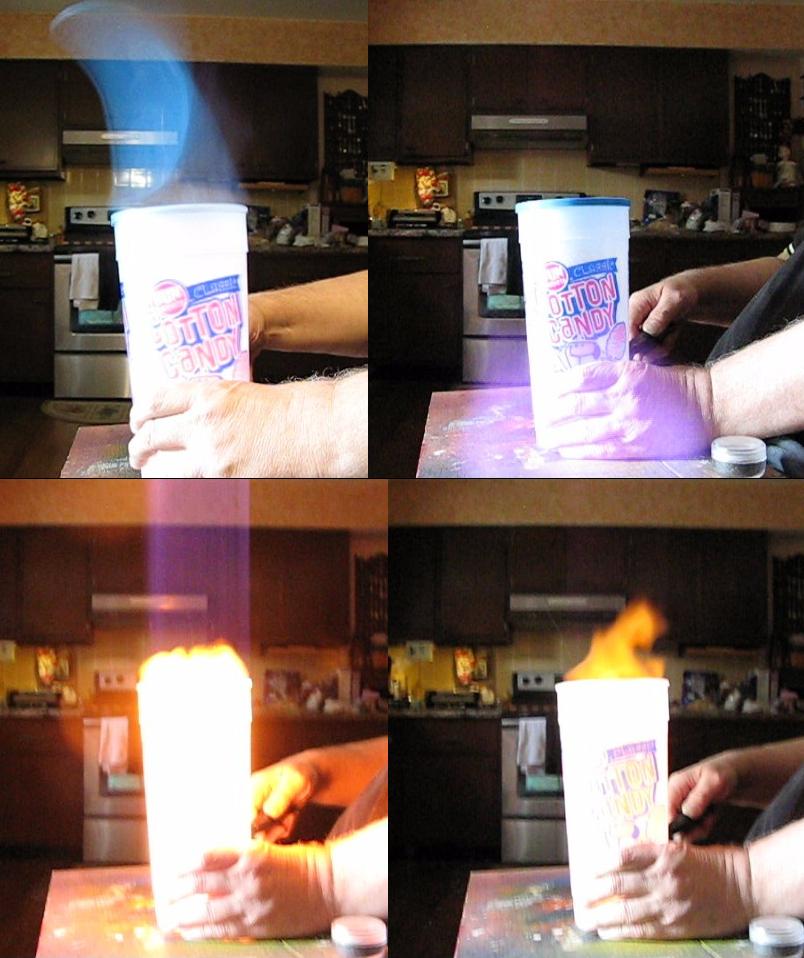

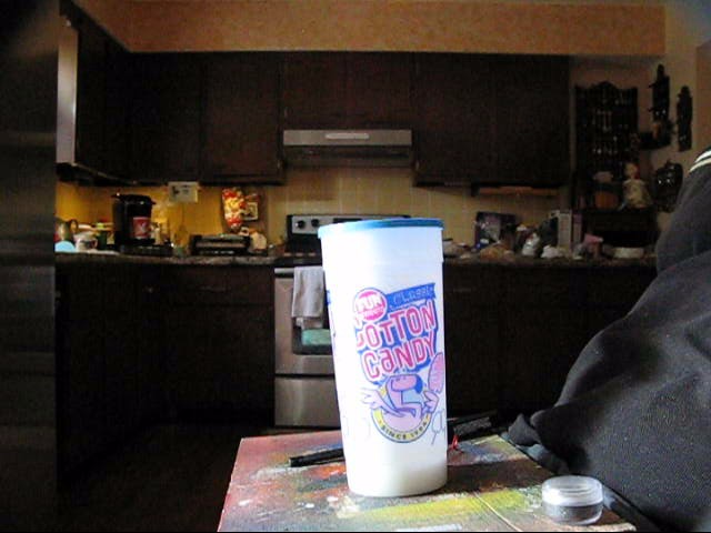

Adjustment on the cotton candy cup, 1 .22LR shell full will pop the lid off as if you stomped on the cup with the lid on, exciting but not really a celebration. 2 .22LR shells full you start to hear the bang from the conbustion. 3 .22LR shells (about 15 grains) it will ring your ears a bit. An empty 9mm shell holds about 13 grains so an empty 9mm shell will light the cup up and give everyone a bit of a surprise :bom:
First image is .22LR shell, last 3 is the stills from a 9mm shell. You can see the bottom line is the water level.
