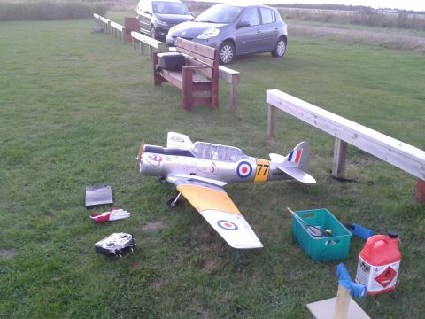

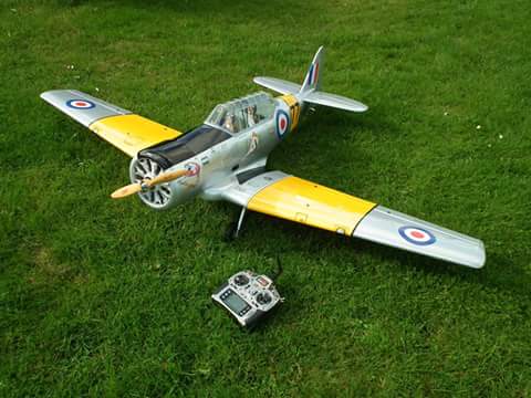

I came to this forum because I got that crazy idea of putting a noise cannon on my big RC warbird plane.
The plane is 209cm/82" in wingspan and is powered by a 26cc gasoline engine. Top speed is around 160kph/100mph and it weighs around 5kg/11lbs.
The plane makes a nice sound when flying by at high speed and low altitude, like a few meters above the ground. I thought it would sound even nicer, if it could make a cannon or machine gun sound, since it is a warbird.

I have attached a couple pictures of the plane for you to enjoy :wink:

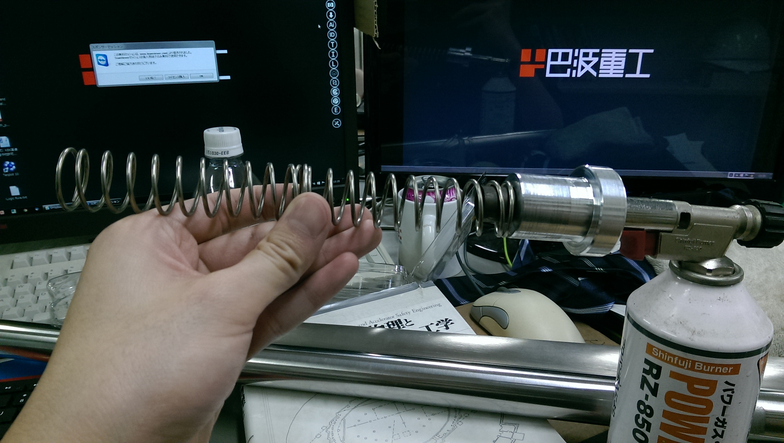

Sorry for my late reply. I'm now investigating how to design the optimum configuration for detonation cannon. So, I tell you my current view briefly.
Although I don't know about the existence of length/diameter ratio, there is minimum value of both length and diameter for realizing detonation. The more important element is the existence of turbulence promoter inside of the tube. Turbulence promoter is used for the purpose of accelerating propagation of deflagration and it results in shortening the distance of the DDT(Deflagration to Detonation Transition).
I used this spiral as a turbulence promoter. This spiral is fixed near the gas torch. (This spiral which used as a turbulence promoter for DDT is called "shchelkin spiral" ) You will be able to get intense sound by inserting this spiral inside of tube as a turbulence promoter.
With respect to its length, it is said that once the DDT achieved, the upstream spirals works as a obstacle that decay the detonation propagation and we have to cull optimum length. However in our situation that use propane or butane and air mixture, it may be originally impossible to generate fully transited detonation by using hand-held tube. This means that the longer the spiral's length, the better for the intense sounds.
I had thought that the my detonation cannon's sounds was attributable to detonation, but it might have been caused by fast deflagration jet. (I'm now planning to conduct the experiment with additional spirals.)
Summarizing above, for creating intense sounds by fast deflagration, the larger pipe which contains spiral inside is better. If you want to realize the real detonation, it will be needed to use pure oxygen as a oxidant instead of air, use high detonatable fuel such as hydrogen or acethylene, or using very long tube.
In additon, basis of detonation are well summarized in this paper. If you interested, please check this.
http://commons.erau.edu/edt/124/
I forgot to mention my cannon's dimension.
The inner diameter is 30 mm, and the length is 900 mm, and it uses propane and butane mixed fuel.

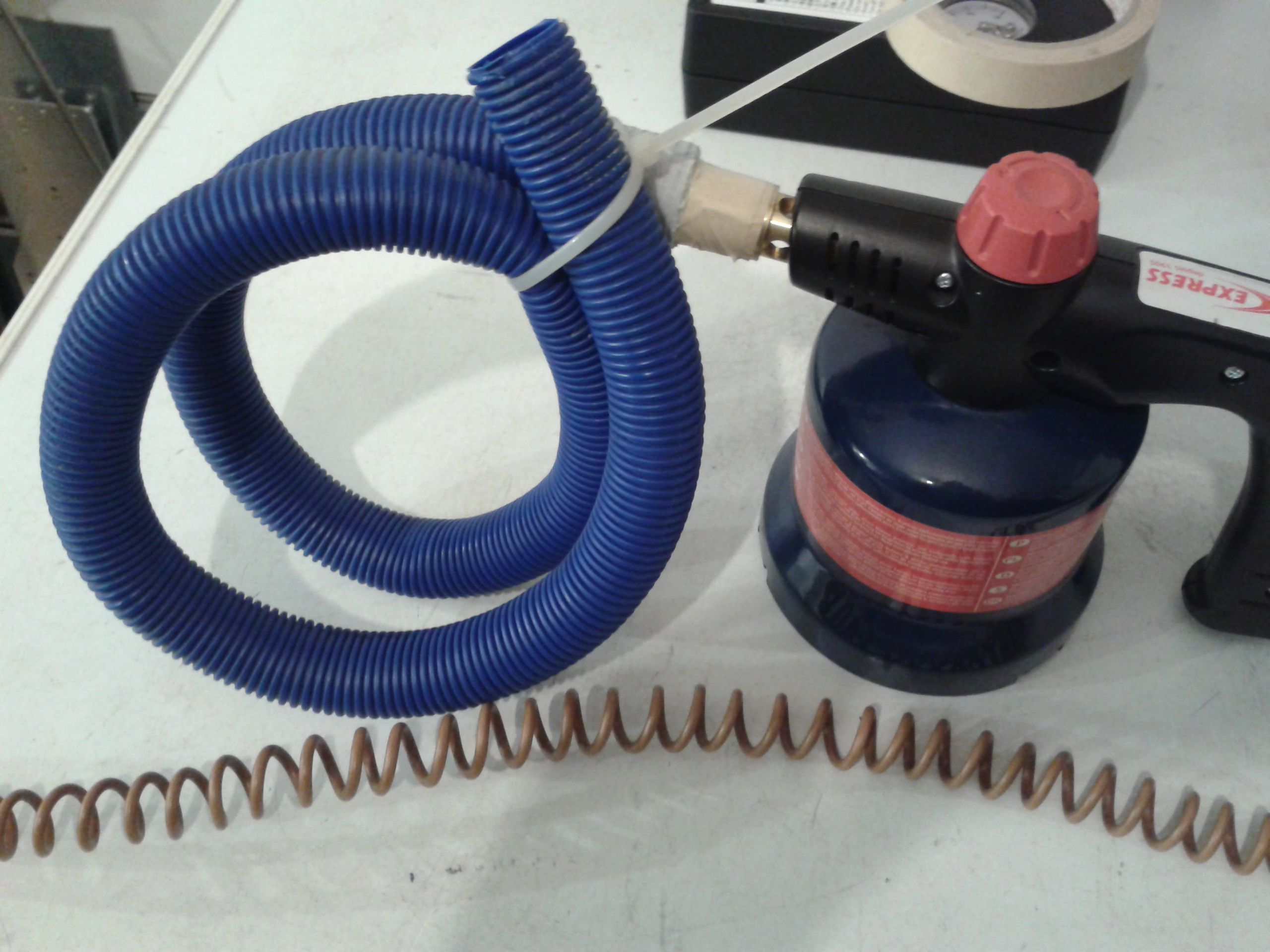

Shyasuna has posted a few more videos on youtube regarding detonation cannons, and I just happened to find some plastic tube that wasn't smooth, so I did a few tests. I can get a good bang but the high pitched sound is not very repeatable with my setup, sometimes it sounds more like a blob than a bang. Perhaps it has something to do with the wind, it's pretty windy tonight.
The spiral in the picture was no good, so I widened the spiral pitch to about 20-30mm and shortened it up to half the length of the tube and this is what could give me a detonation-like sound.
I will have to find some more of this tube, it seems like a good foundation for more testing. The size/diameter is also be very suitable for my RC plane.
