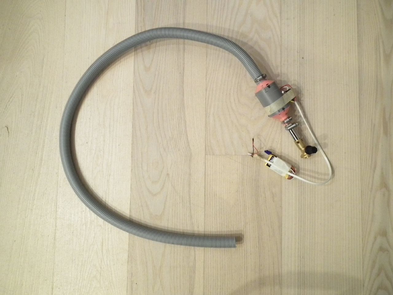

From the video in my previous post, I extracted the soundtrack and used an online sound editor to analyze the sound so I could get an idea of how fast I am able to shoot the sound cannon. It turns out I can shoot it every 400ms, thats 2.5 times a second. So I made a microcontroller board with SMD components, and with such small traces, an optocoupler, seperate supply for the HV modules, my homemade spark plug and short wires, I have no problems with the microcontroller and RF noise from the spark or HV module.
So I went to the garden to shoot my microcontroller timed sound cannon, and it rips! I had it firing maybe 10 times, and then the grey plastic tubing got soft from the heat and broke.

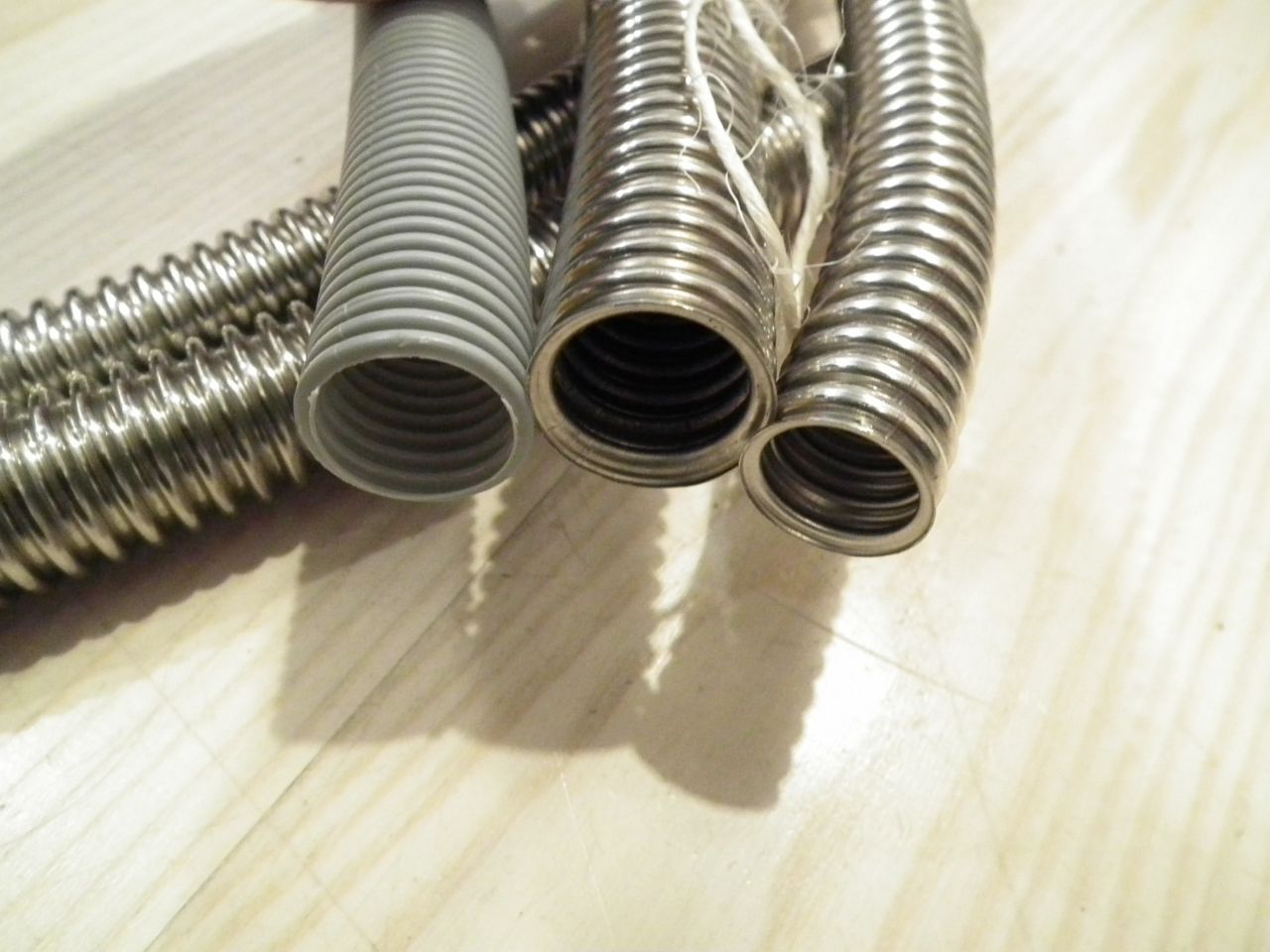

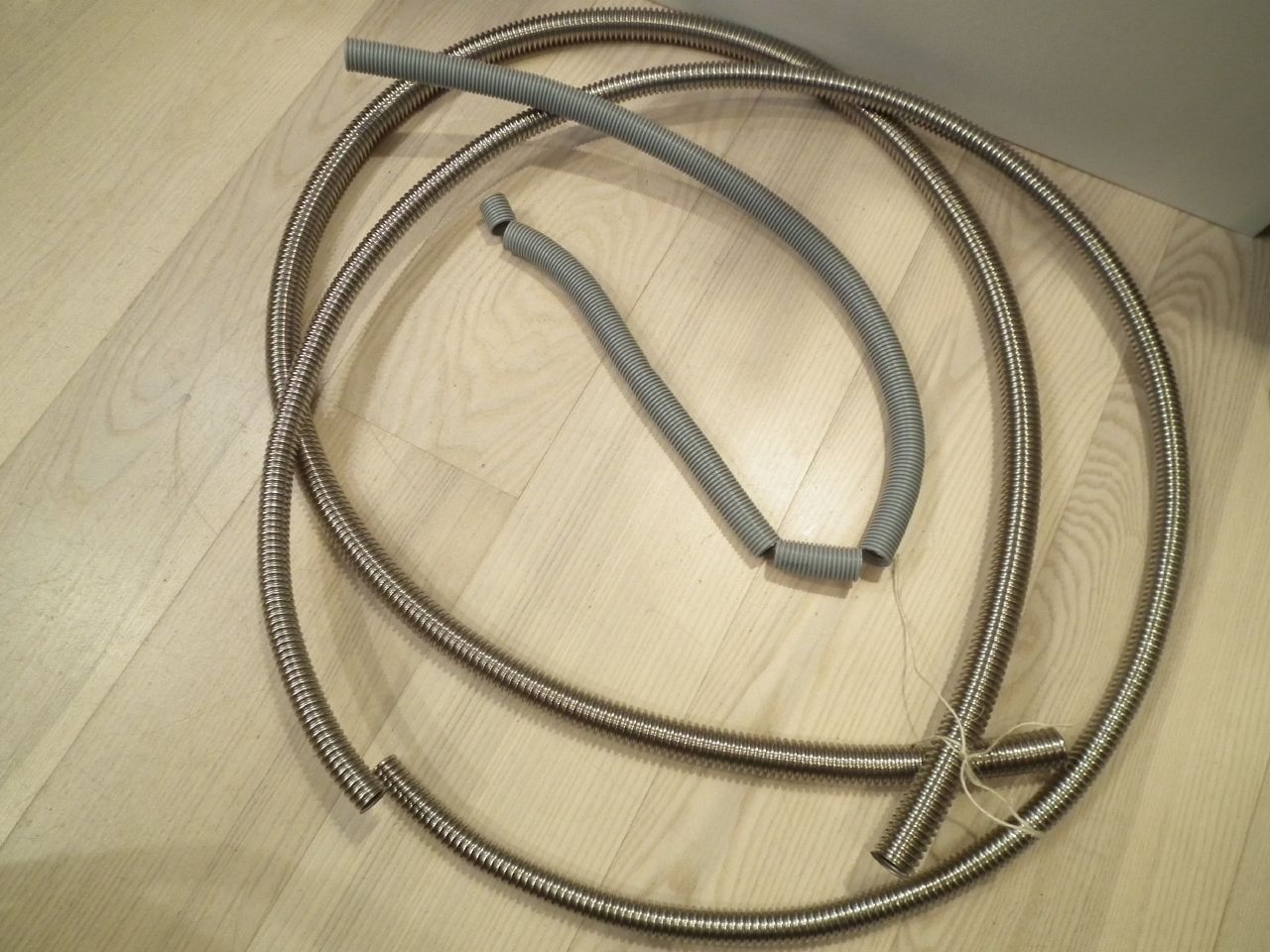

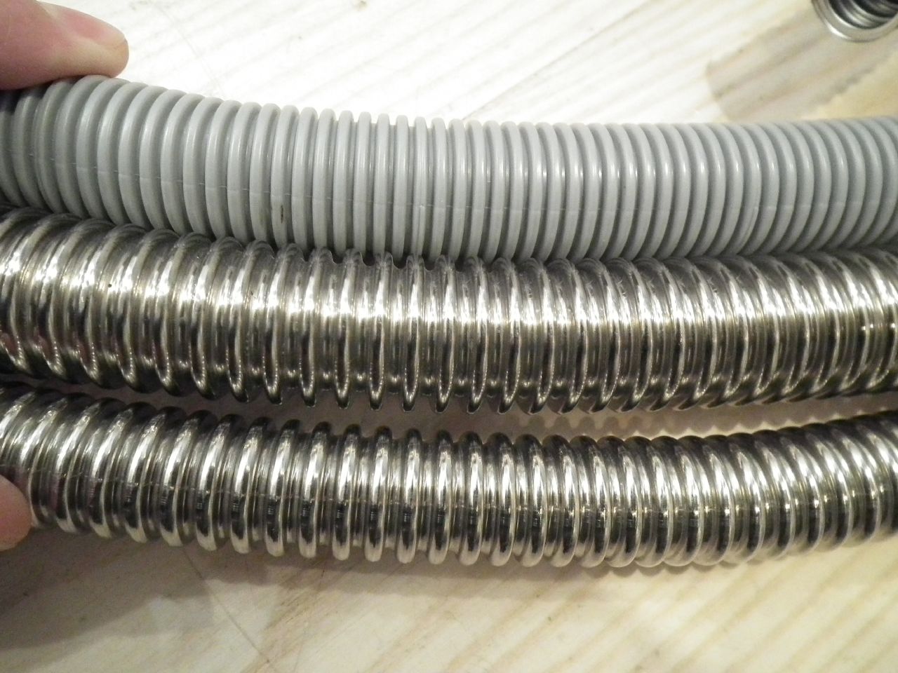

So I found some corrugated stainless steel hose online, and found a place where they used it for solar panels for heating water, and the price was good compared to other places but still set me back what equals to $46 for 4 meter hose.
I bought 2 meter DN20 (ID 21mm) and 2 meter DN16 (ID 17mm). I'm pretty sure the DN20 will work just fine, but I'm not sure about the DN16, but the smaller size of DN16 would suit the plane better, so I got it anyway so I can test it.

I have tested the new stainless steel hose with a small initiator chamber of 130ccm. Both the DN20 and the DN16 works with 1 meter hose. This is great news! 8)
More testing is needed as I just confirmed that the new hoses will generate a loud boom, but I haven't tested how fast I can shoot them with the existing gas mixer (weed burner) yet. Neighbors start to wonder where the sounds come from, so I'll wait till its dark with more testing, maybe drive outside of town for testing :lol:

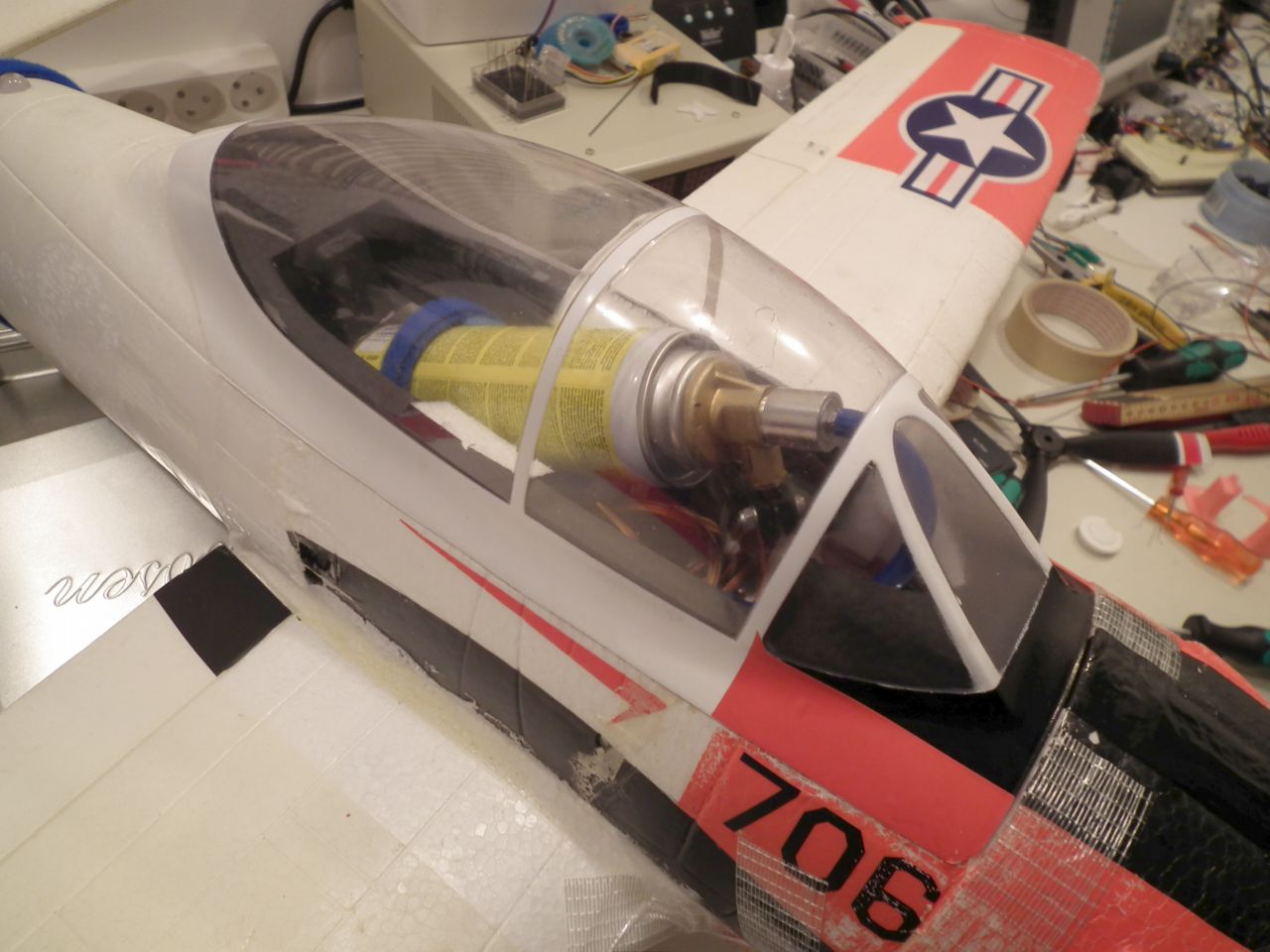

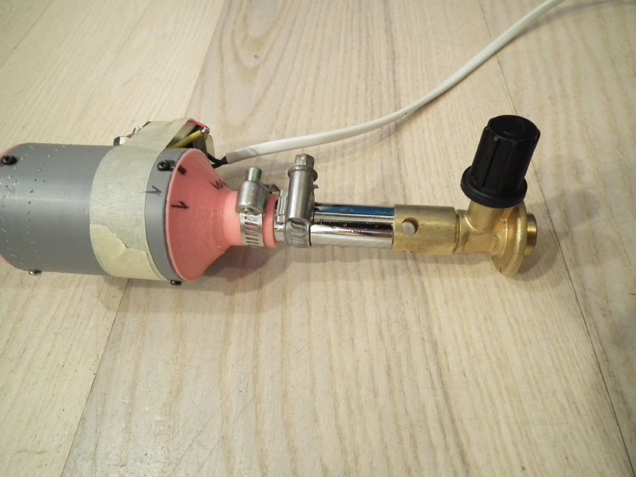

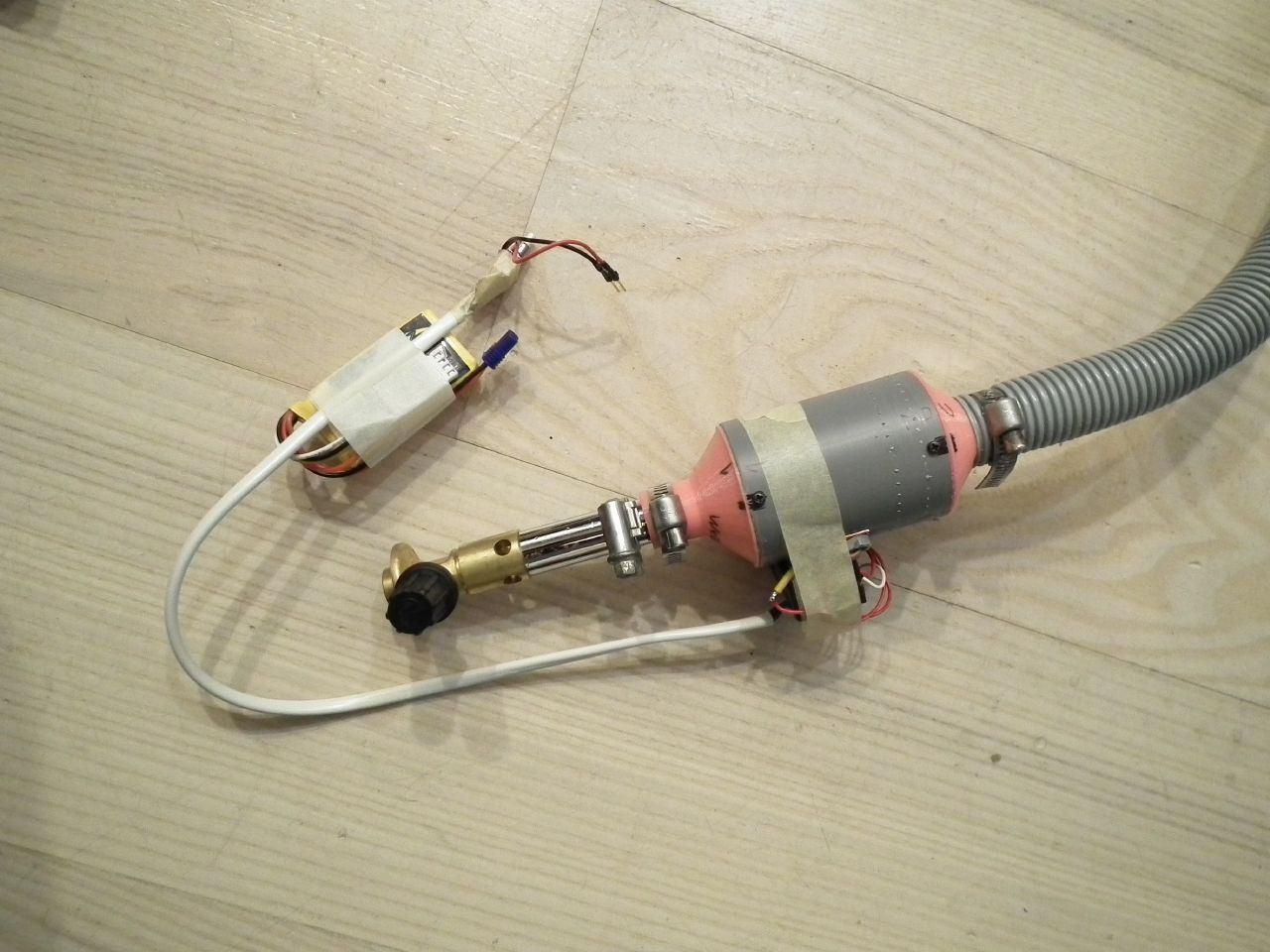

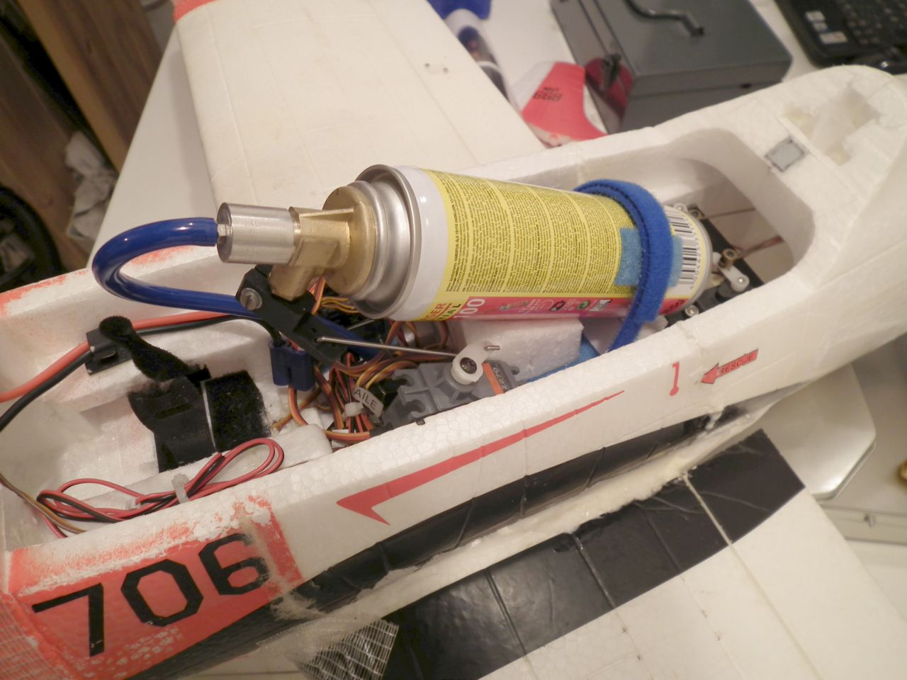

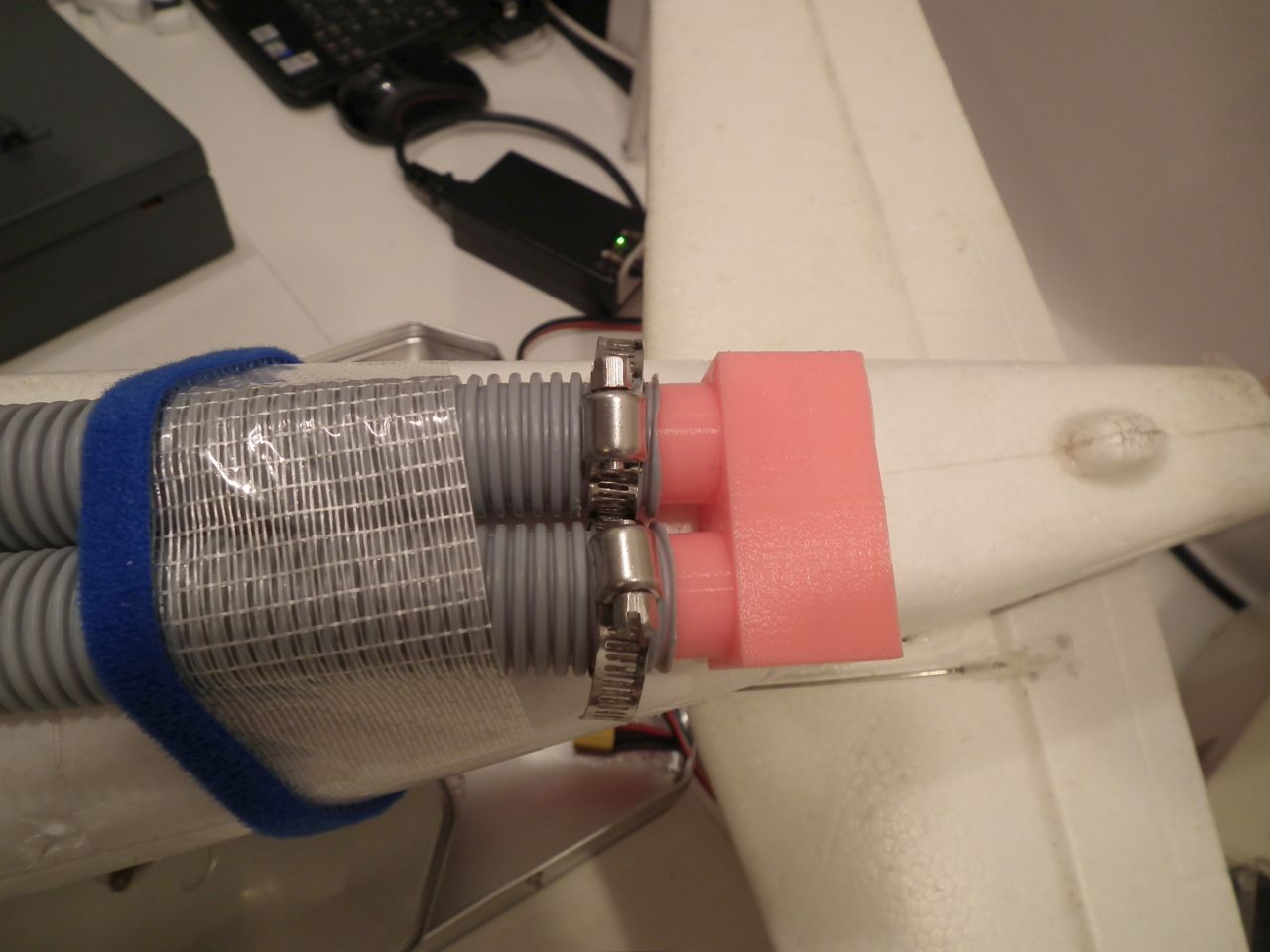

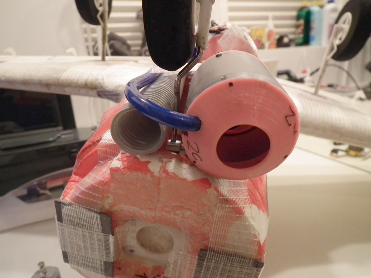

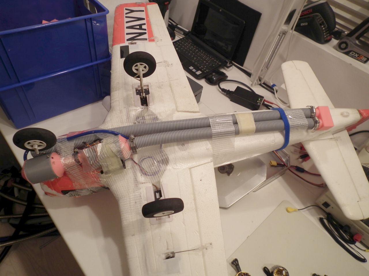

I just took some photos of the installation. The plane was a model I had crashed previously and was not the most suitable for the job, but I couldn't wait to test it in the air any longer so I fixed the plane and installed the sound cannon.
The 150ml propane tank should be mounted as upright as possible to avoid liquid propane entering the blue hose. But the plane was not big enough for a full upright, and I wanted to be able to fit the canopy afterwards so it does sit at an angle. I modified the valve from the weed burner to accept the blue hose, which is actually a gasoline hose from gasoline RC cars, but it seems to work fine. Also I attached an arm for servo actuation so I could open and close the gas flow by remote. The 1 meter long detonation tube was cut in two and the square pink box in the pictures was 3D printed and used for connecting the tubes so they could better fit on the small plane. The propane nozzle, nozzle housing and mixer tube was real heavy, so I 3D printed those parts too, except the actual propane nozzle. Since I want the detonation tube opening to point forward on the plane, I made an adapter for the air intake, so that the exhaust hole and intake hole gets the same amount of air pressure from the air passing by due to the plane moving forward. This way, the propane nozzle can actually enable flow from intake to exhaust using the venturi effect, but the air pressure inside the initiator chamber and detonation tube will be slightly larger than atmospheric pressure.

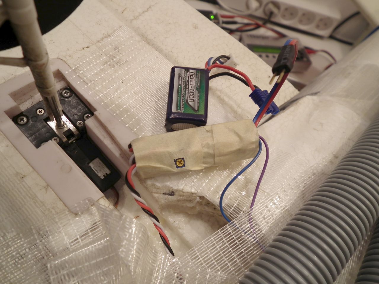

The rate of fire is controlled by my microntroller board, the one wrapped in yellow painters tape. The controller board has a microcontroller reading the signal from the RC receiver and the position of the small pot. The pot is used to adjust the rate of fire, or actually the rate of spark ignition, and the signal from the RC receiver is the same as the signal for the gas valve actuation servo and is used to enable/disable ignition. So when I flip the switch on my RC transmitter, the servo opens up the gas flow, and the controller board starts igniting the gas at the set interval. The ignition module is powered by a small separate battery and the microcontroller uses an optocoupler to control the ignition module, so that the module cannot send noise back to the RC receiver through the servo wire.
Before flight, I had set the fire rate to a safe level where I was quite sure enough gas/air mix would have entered the initiator chamber and detonation tube. I only had that one flight due to the motor failure so I could not test it again with a faster rate of fire by adjusting the pot.
Now, I have ordered another new RC plane, a cheap trainer plane with a larger wingspan and more room inside the fuselage. I hope to be able to put more stuff into the fuselage so I can reduce the drag from stuff hanging off the bottom of the plane and I hope the shape of the wing and the bigger wingspan will enable the plane to carry the extra load with more ease than the warbird in the video. Because I need more test flights, a lot of them. I need to test rate of fire, intake vs. exhaust hole sizes, propane nozzle sizes (I hope a bigger propane nozzle hole and air intake hole can increase the gas/air mix flow so I can increase the rate of fire), I need to take the steel detonation tube into the air too ect. I want a completely proven design working before I start cutting up the wing and making changes to the big wooden plane seen in my first post of this thread.

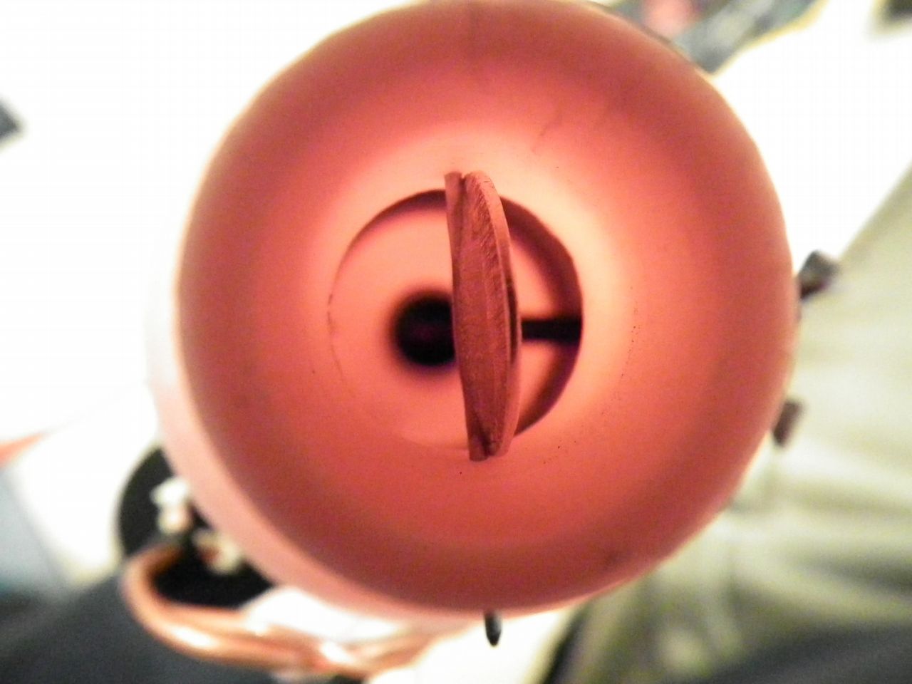

So I came up with the idea of using a throttle valve (like the one used on a carburetor) as an inlet valve, I was thinking I could easily control such a valve with a motor or fast RC servo. So I did a test (using the proven weed burner) where I fired the noise cannon with the valve open, and one where I close the valve with the gas still flowing and igniting very quickly after closing the valve. The result is very strange, I get a lot bigger boom with the valve open, and I can see a much bigger exhaust flame when the valve is open. I would have thought is was the other way around!
What can be the reason for this? Shouldn't the closed inlet valve help produce a much higher pressure inside the initiator chamber when igniting (because then none of the burning gas can escape through the air intake) and this would then help accelerate the flame through the tube?
I'm thinking that the closed valve somehow affects the propane/air mix, because there were times during my testing where the cannon wouldn't fire at all with the valve closed which must be due to an un-ignitable mixture. Maybe I'm using a lean or rich mix, and the closed valve somehow creates a too lean or too rich mix that won't ignite.
Pictures of the throttle valve.

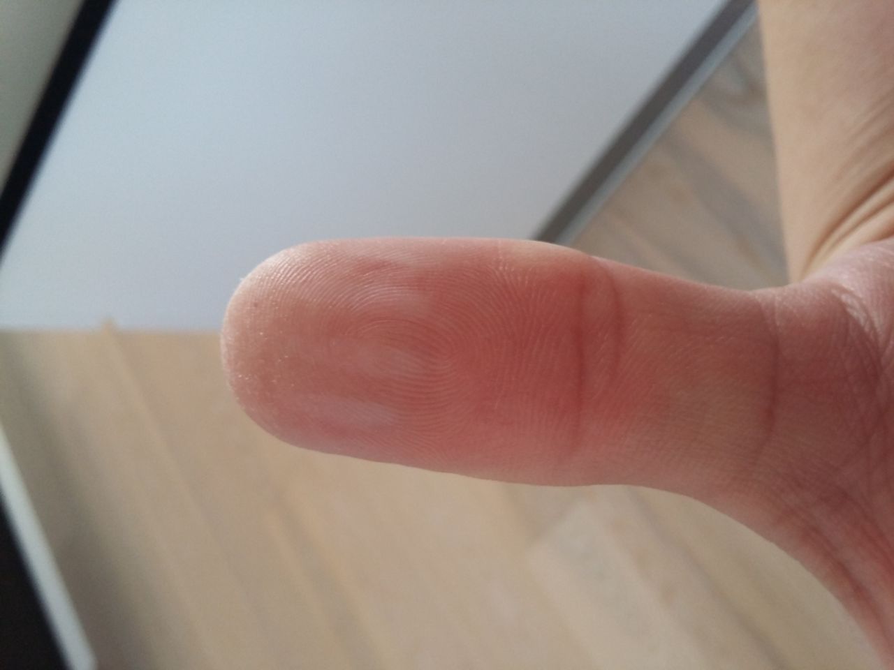

During my testing, the corrugated stainless steel tube proves to be very reliable. It gets burning hot, just look at my thumb from when I grabbed the tube too soon after shooting it.
The heat is also too intense for both the 3D printed parts and the grey drain pipe after a series of maybe 10 shots. So I was in thinking mode on how to make a heat resistant initiator chamber that is also lightweight. Thin welded steel plate, no, too heavy because I can't weld such thin plate with the welder I have available. Silver solder the thin steel plate, could work, but it seems hard to find silver soldering tools around here. TIG welding aluminium plates, yes, but I don't have access to a AC/DC TIG welder.

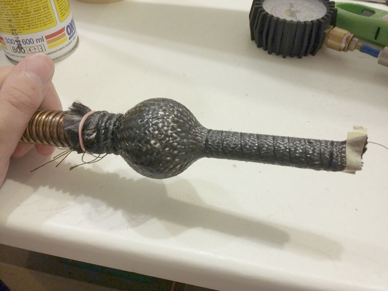

Then it suddenly came to me. Carbon fiber! Lots of people make fiberglass stuff for RC planes, carbon fiber is not any different in manufacturing methods, only a different material which gives a more stiff product. I even have a guy at the club making fiberglass fuel tanks for RC jets, he gave me some hints, and I found some braided carbon fiber sleeve which would be easy to work with, and I found some affordable high temp epoxy resin. Resin has arrived, but not the carbon fiber, so I won't be making any real stuff from it before next weekend.

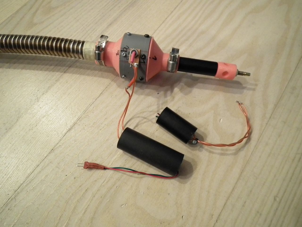

So I was just outside for some more testing. I attached the noise cannon to a test airplane, just to get some wind from the propeller into the air intake. I had bent the steel tube 120 degrees with a nice soft radius. I was having a hard time getting a good sound from it. So I bent the steel tube back to almost straight and now it was easier to get a good sound from it. So bends on the steel tube is also a factor to consider. Holy cow, this is getting very complicated, too many factors to consider! I think it is time for me to get rid of some of the variables and make them constants. Like, the length and shape of the tube, this is limited by the airplane wing so that is easy to make constant. Also the initiator chamber, I need to start making those carbon fiber chambers.

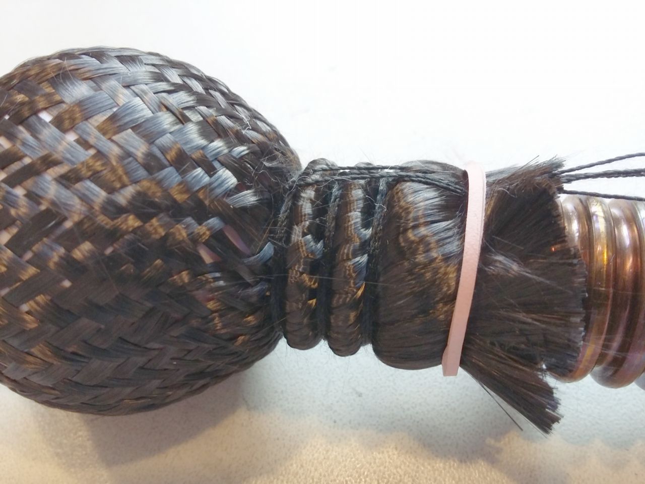

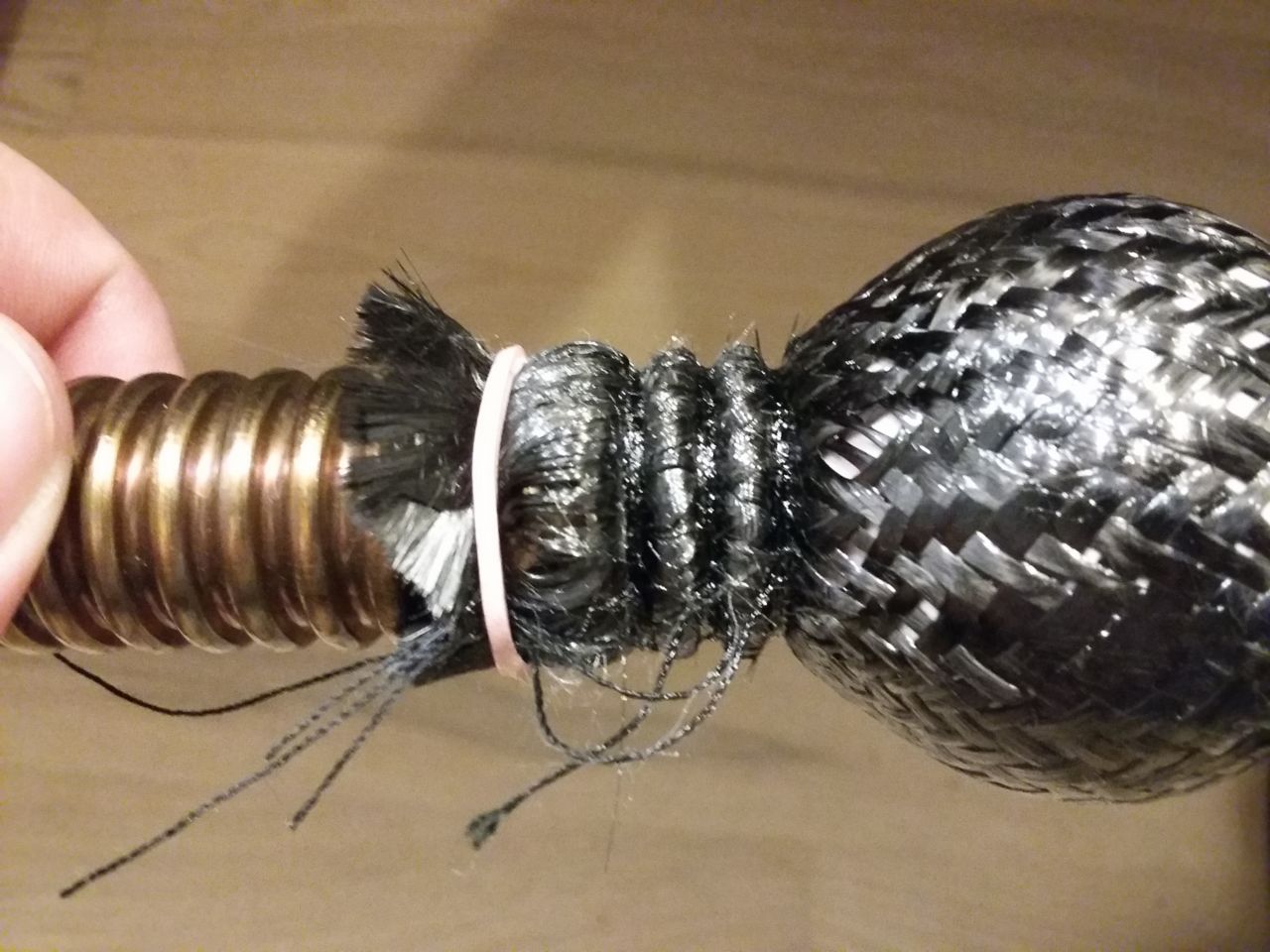

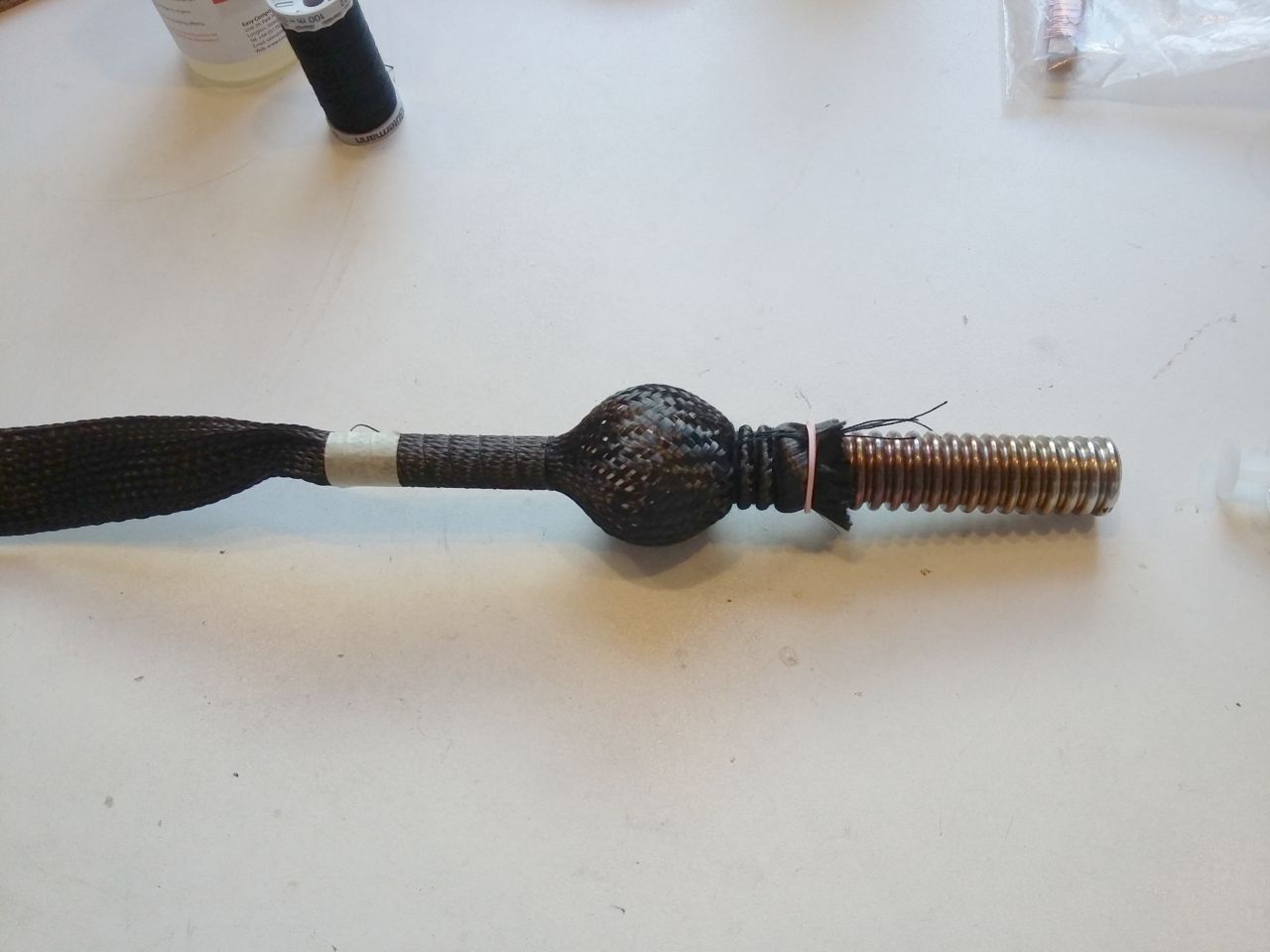

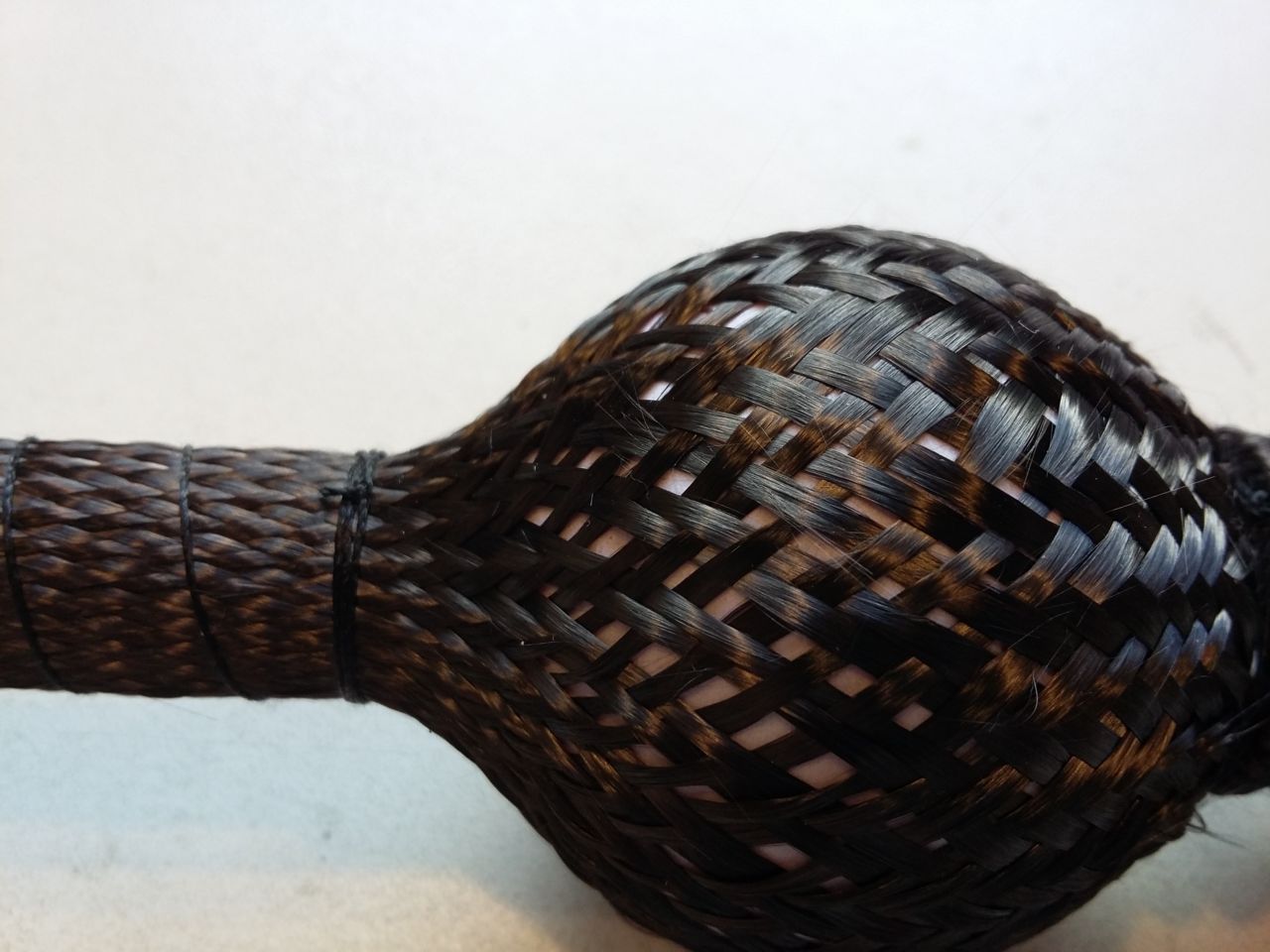

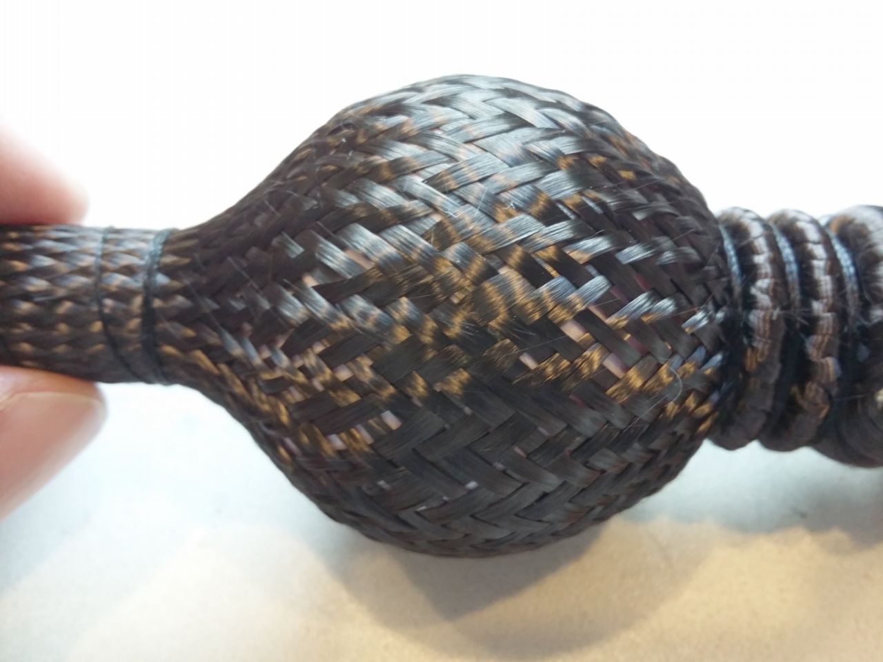

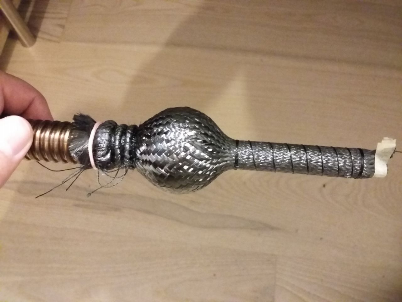

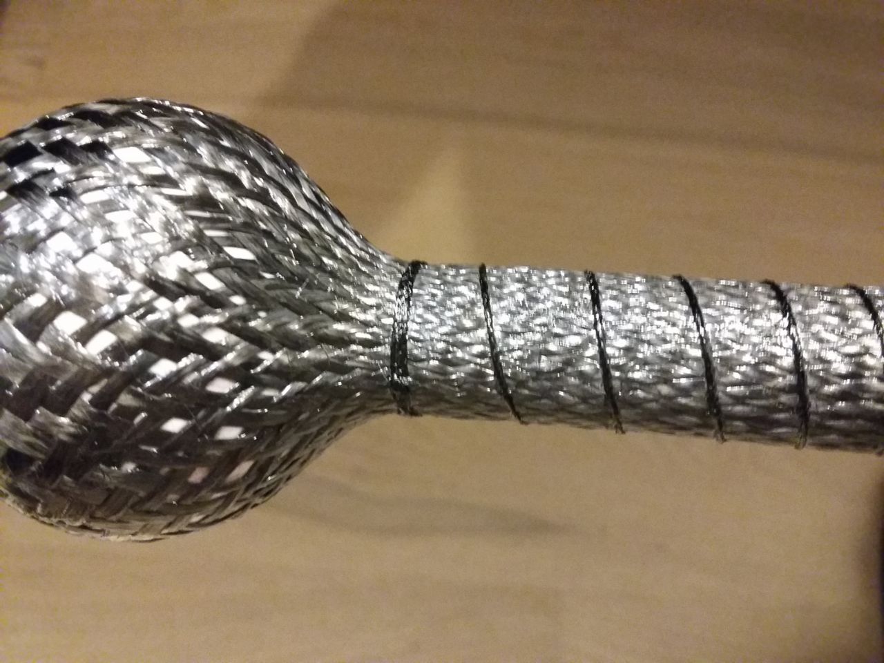

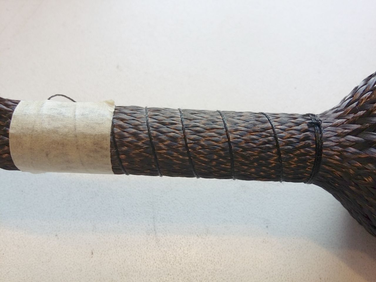

Oh, and I did my first carbon fiber thingy today, probably need 2 or 3 layers of sleeve before it's good. Pictures are before and after resin has been applied.
