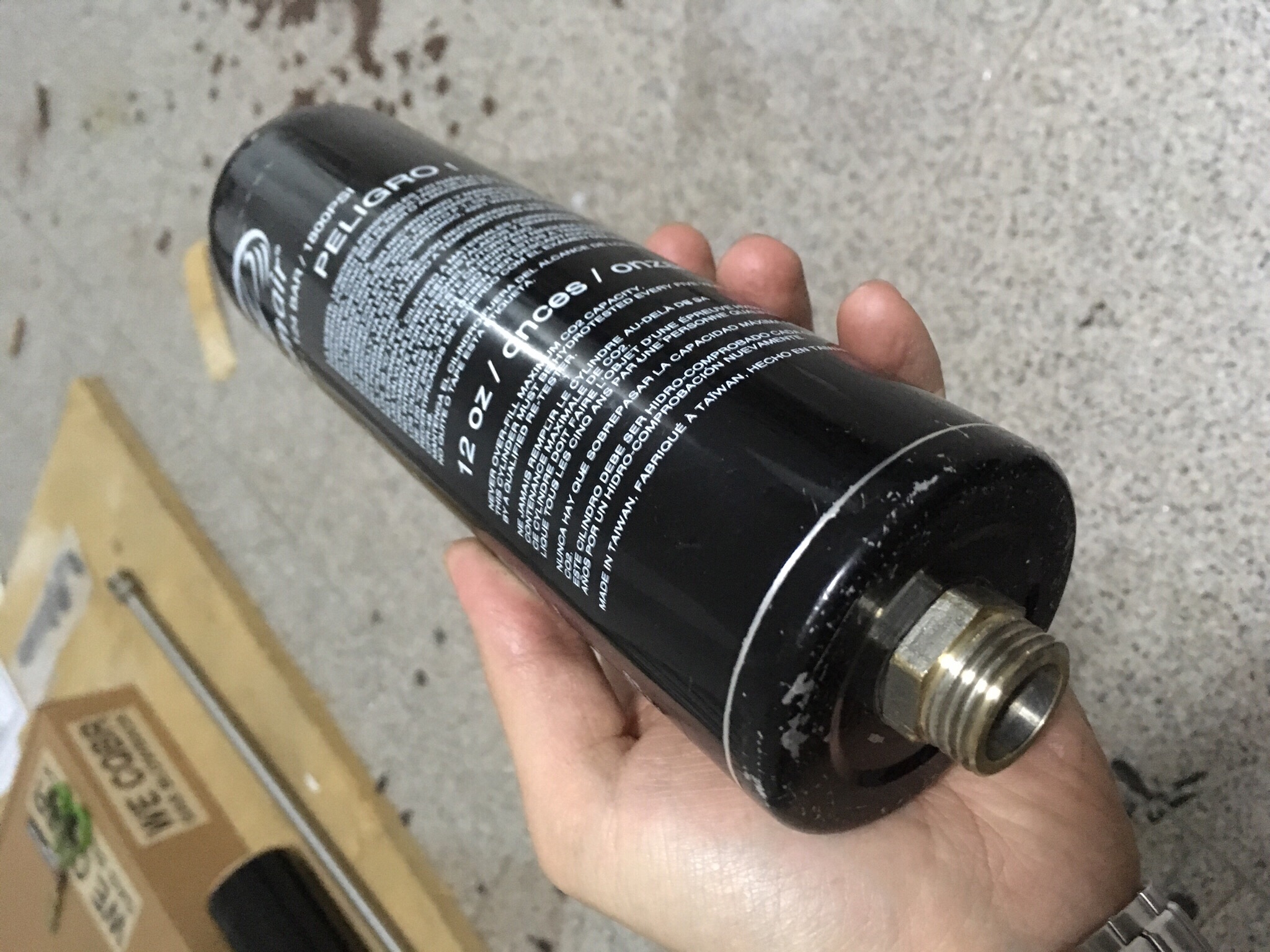

I had this co2 bottle for quite a while and it seemed like a good chamber for 10x hybrid. However the threading isn't very user friendly and small so I drilled and tapped the button with 1/2 BSP and epoxied a modified 1/2 union. Is this a bad idea? The thickness of the button allowed about 10mm of thread.
That's about 5 turns in, sounds reasonable for a 10x hybrid.
