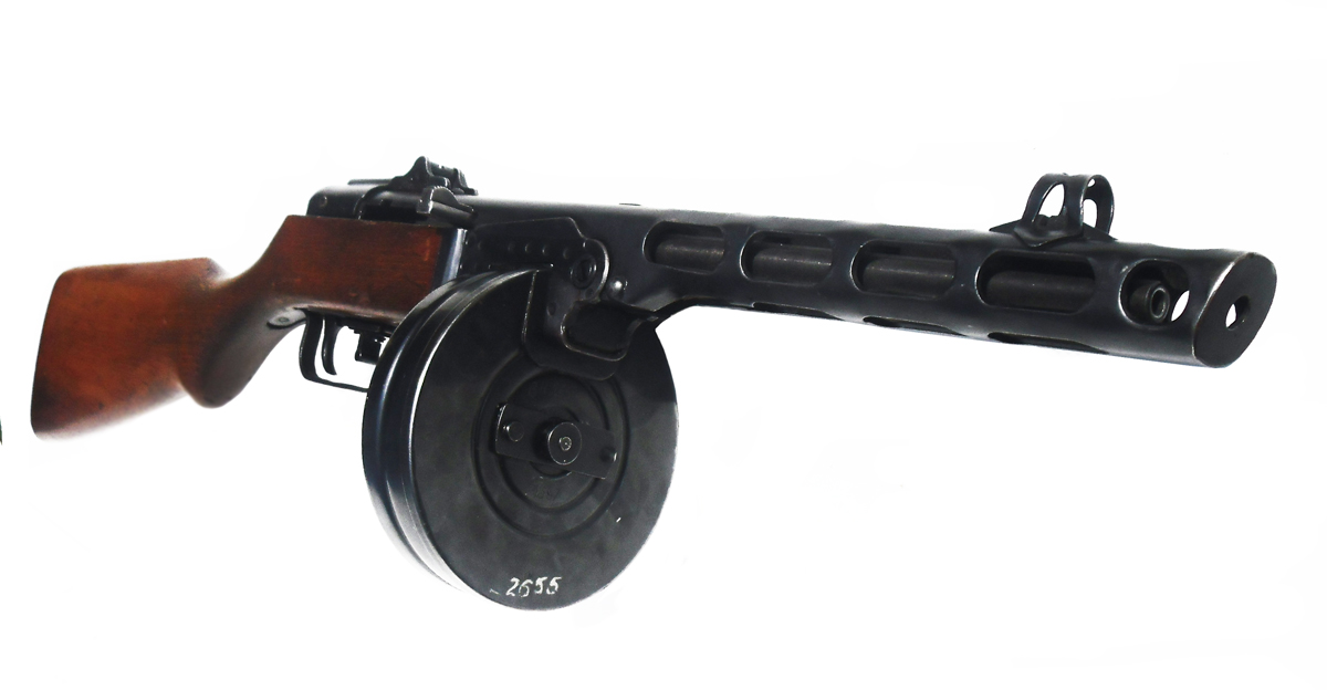

I don't get the PPSH reference tho? It's a big heavy gun firing a small pistol round, that's why it has so little recoil, i have a semi auto conversion on license and it still kicks tho :p Or are you referring to the barrel shroud acting as a crude muzzle brake?

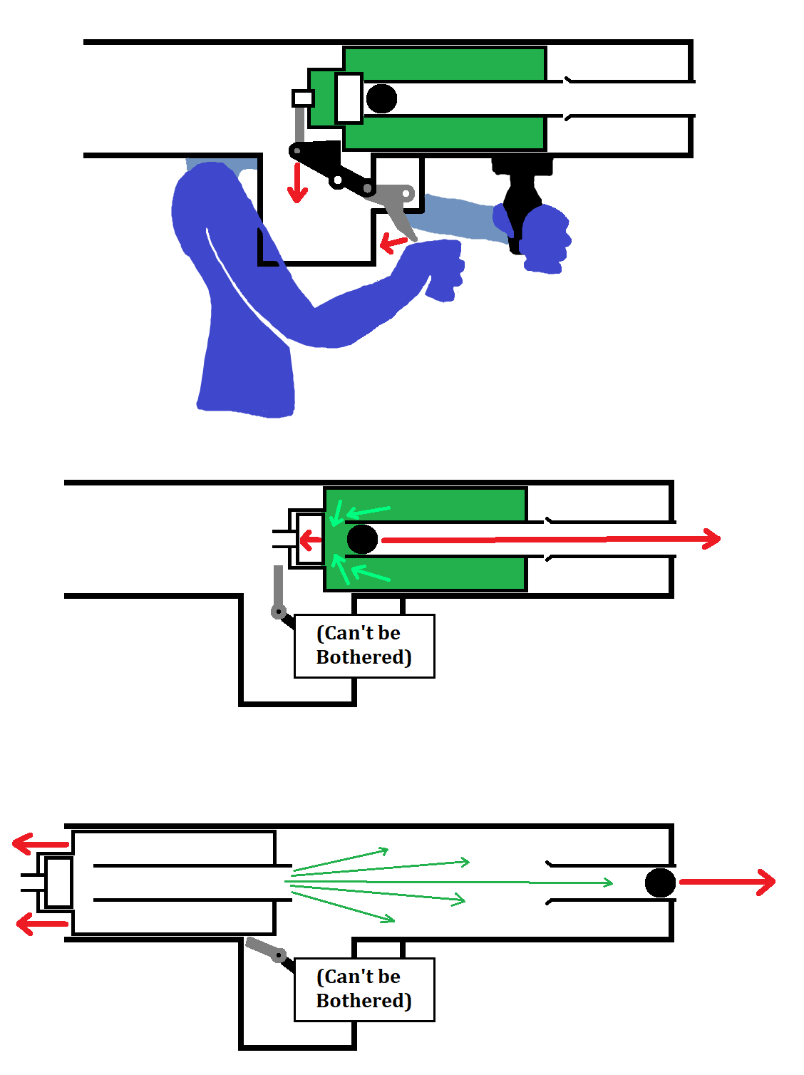

A truly recoiless weapon must eject something at the rear. Having a contained counter-balance like a counterweight that moves inside the gun will not eliminate recoil, only delay (like the AEK models of AK rifle) or redirect it (as in the Kriss Vector). So these aren't true recoiless weapons. They can be made more ergonomic by extending the duration of the recoil, so that it is less force at any one moment and less abrupt, tho. Remember that adding features to a gun will make it heavier. Fundamentally, heavier guns have easier recoils inherently, so a recoil managing system might be a thing with diminishing returns where it quickly is too complex and helps very little compared to just making the gun heavier.
Man handed rocket launchers exhaust gas. For effective compensation, half of the energy produced by discharging must be released in both ways. Because gas is much lighter than the projectile, you have to push it faster through the rear. That is rather inefficient for air launchers because it means you are dumping more than half of the chamber's pressure away from the projectile.
An obvious solution is to make as if duct-taping two launchers that share the same trigger. Each shooting the same mass at the same gas pressure. This would make an extremely effective solution, but also a danger in most shooting ranges.
Here's a small caveat you can exploit: your rearward launcher doesn't have to shoot the same mass as the front facing one. It only has to eject the same kinetic energy equivalent. Maybe a much heavier mass with lower speed doesn't have to travel as fast and thus don't eject as fast. But here again comes into play the issue with diminishing returns in recoil delaying systems.
jackssmirkingrevenge, as always, gives an interesting alternative. Don't contain the counterweight, but the gas. I you can have a two-ended barrel (as in gas exhausting systems), but the rearward exhaust is made to push on a piston which is trapped when it reached the rear end of the launcher. This piston will act as platform that transmits the energy to an actual ejecting mass. Once the piston is stopped, you'll feel some added recoil as the trapped gas is pushed forward, but it will be greatly delayed recoil. This is kinda of an hybrid of all the other ideas, if you think about it. Maybe allowing the trapped gas to escape perpendicularly will help dissipating the late recoil.
If I wanted to manage recoil in a launcher of mine, I'd built it like a Kriss Vector. It isn't recoiless, but aligning the barrel with the wrist (thus having a low bore axis) will prevent the recoil from having any negative effects but the fact that it hurts. If you have large launcher that needs to be shoulder mounted, you'd better mount it on the ground instead.
In any case I want to present this idea and you tell me what you think:
Launcher within a launcher
Maybe this could be improved by instead of having the fixed barrel extension segmented off from the interior launcher, make it enveloped as in arrow shooters, but whatever...
