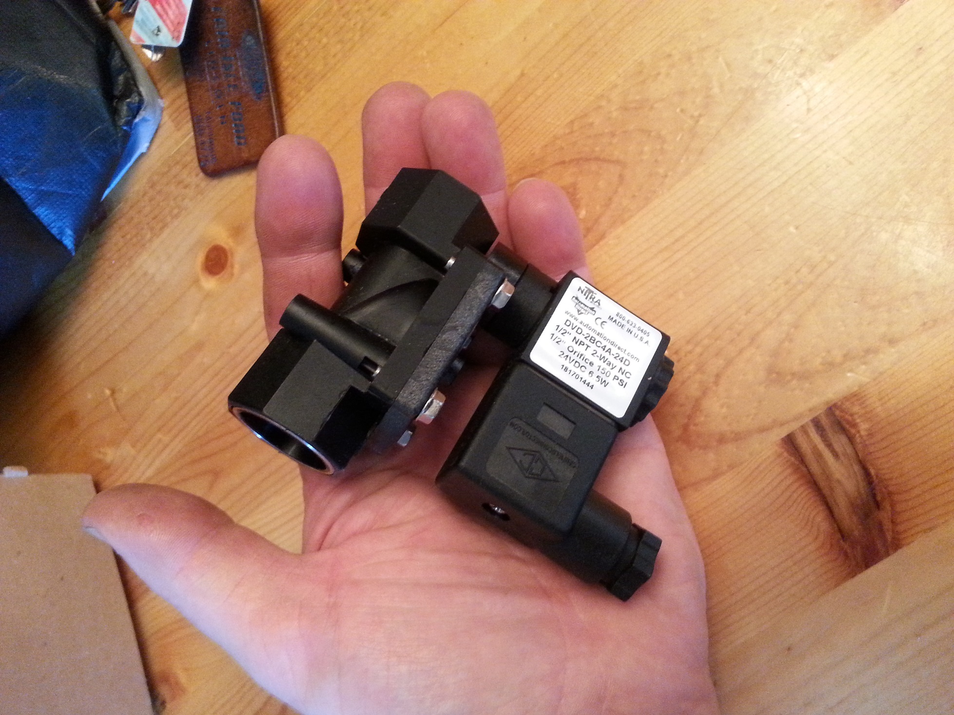

Got the 1/2" valve, it's pretty sweet, all polymer body so it's pretty light, rated at 150 psi, good enough for me. :lol:

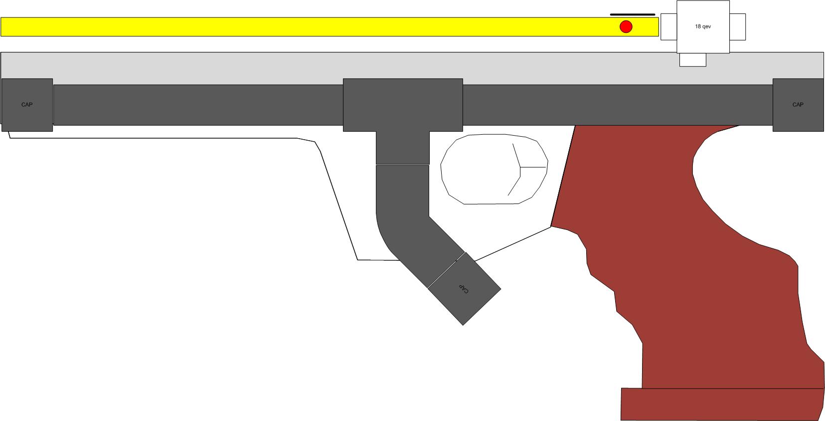

My one day, some day, pistol layout, I have the QEV, barrel and trigger valve already, damn, it's nearly built then :o

2 ideas for a stock layout, I'll have to make up both and see what they feel like, I have a tote bin full of PVC fittings and pipe, It's like my Lego :D

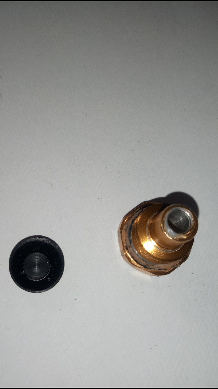

ITWOST, again. Thoroughly impressed with the pump(for the price), ran it up to the full 4500psi. Wee little 1/8" QEV survived 2000, didn't manage to trigger it because of valve problems. Now I've been distracted by a pressure washer handle and 3000psi. Next test is a larger QEV.

I'm yet to strip it, but it held. Poor test because it was a QEV that I had bored out the seat to 4.5mm (was thereabouts to 4mm). It's always had a slight leak since, but still the gauge read 2100. Seeing as I was indoors I didn't care to go much higher. I've got another ordered which I plan on testing more extensively, I have a few spare diaphragms.
[Edit] Pulled it apart, nought a mark, score nor imperfection on it. Seems they're more durable than you'd expect from a $4 part from the PRC. 4500psi testing to follow
Bar the terrible boring on the seat, perfect!
