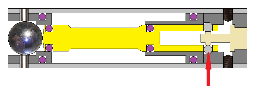

More practical musings, perhaps a mechanical lock is a better idea.

It seems a little more complicated, without this being a problem.
Question: What material is indicated by the red arrow?
What are the advantages compared to the previous design?
Those are steel balls, the function is like an airsoft grenade:
They hold the piston in place in the same way that a quick-connect fitting works:
No air is wasted for piloting, and piston release is instant, there is no pilot chamber emptying that will slow the piston down. It's a little more complex to make, but also more reliable and in theory faster opening. If the difference in diameter between from and rear o-rings on the piston is small, the force needed to actuate it will also be minimal.

The fact that it opens faster is important. I like it. :bounce:
