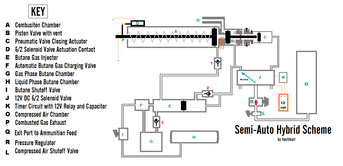

This is the block diagram of the test installation. It has some details
the combustion chamber and the piston valve, for clarity. Is not a
pneumatic diagram, because there are people who do not understand this and my idea is that all
people can understand. If not, feel free to let me know and I will try
to expand and explain more clearly.

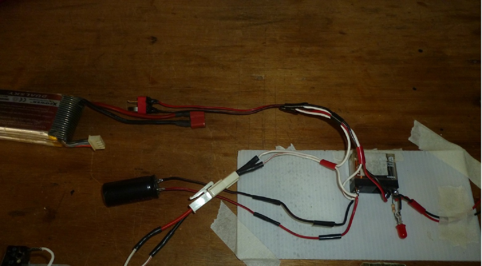

The timer consisting of a 12-volt relay in the coil is controlled by
an electrolytic capacitor of 2200 Uf. He is in charge of keeping the electrovlala activated
5/2 to allow time for the output of excess gas from the dispenser - "E" gas injector.
The more capacity the capacitor has, the longer the solenoid valve is activated,

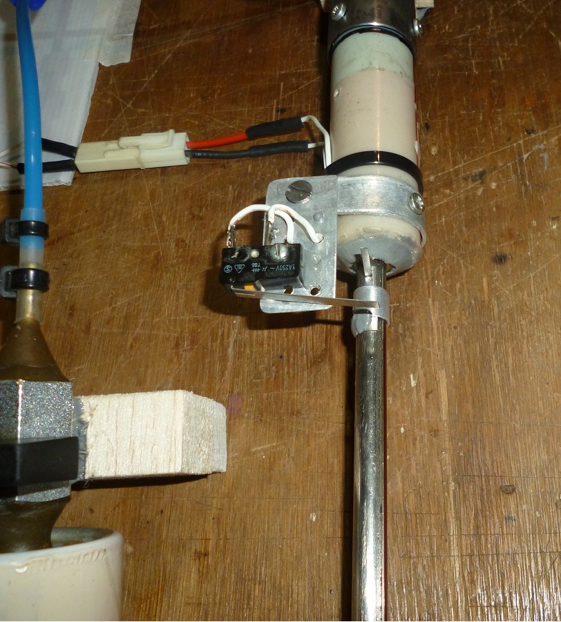

as necessary. The contact that activates the solenoid valve is actually a push button
which is "pressed" when the piston rod that sweeps the burnt gases from the chamber
of combustion is in the position of "volume 0 combustion chamber", totally clean.
I have contributed a couple of photos of the timer and the contact.

Translated the key in English for clarity as most members would not understand, items 1,2 and 3 are check/one way valves:

My daughter says it's a weapon crushes fingers for armagedon! Thank you very much Jack for translating the references and joining the two diagrams. It was excellent!
