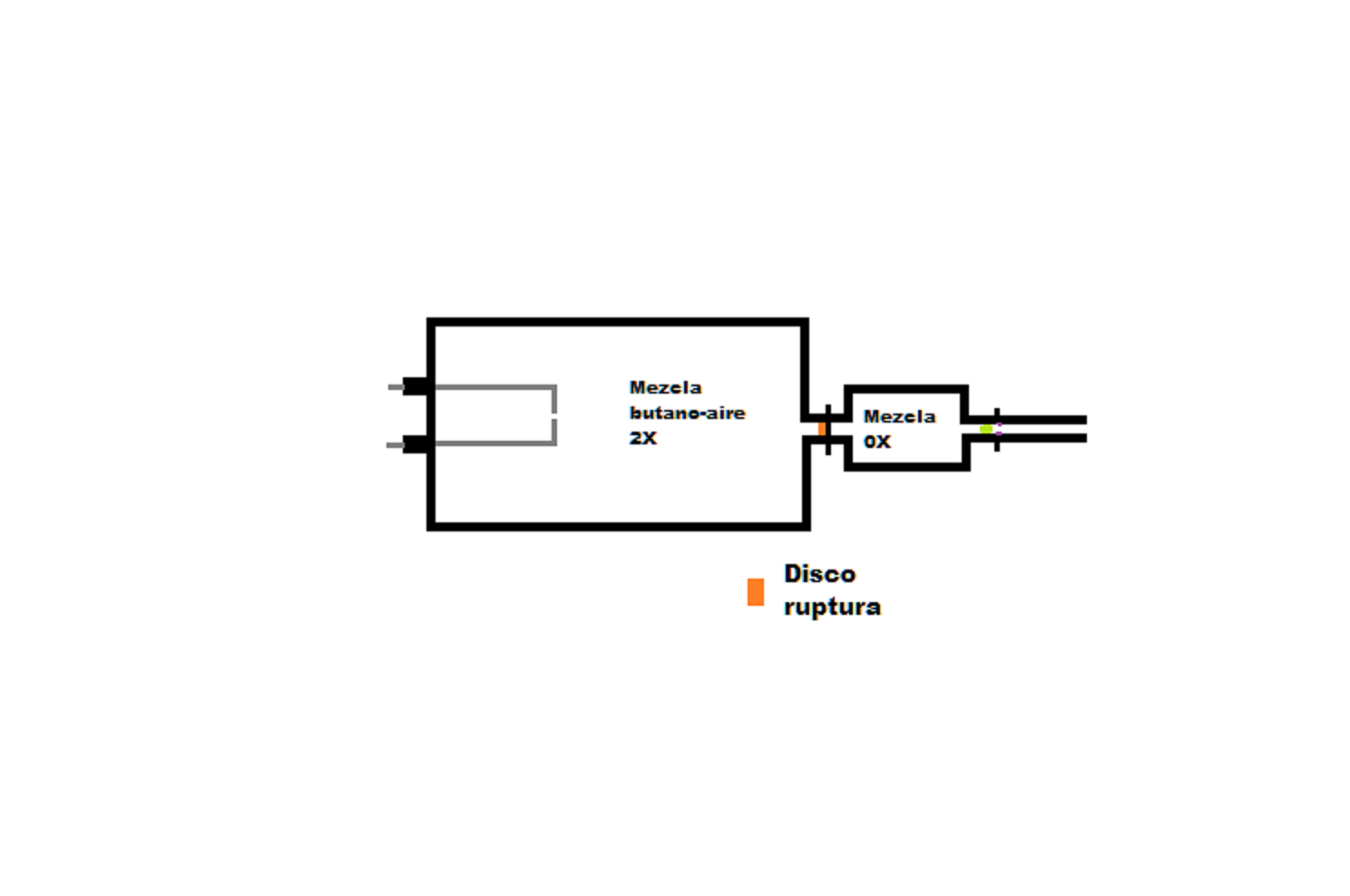

This would be the rigor experiment. I imagine that with at least 5X in both cameras the result would be interesting ....
Let's say that in the first chamber the peak pressure at the time of the explosion could reach 7 times 5X about 35 bar, 500 psi.
In the second chamber, the pressure could go, according to the author, about 7 times more, about 245 bar, 3500 psi, according to figure 1.2 of the article.
Double rupture disc could be used to achieve the maximum pressure peaks in both combustion chamber.

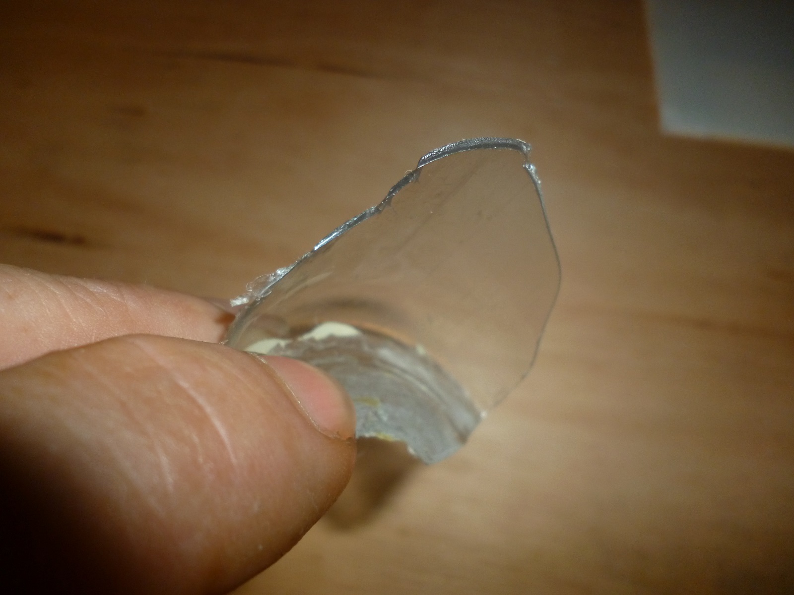

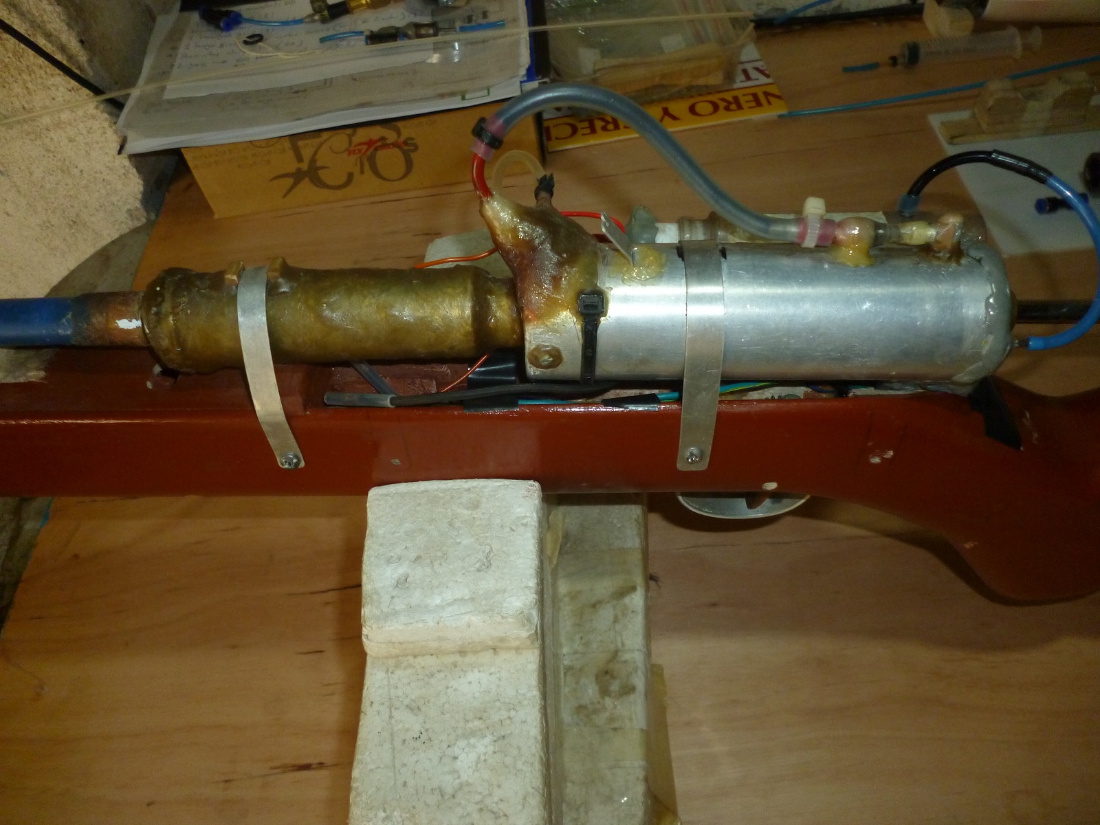

I leave a picture of my little test. The secondary chamber is an aluminum tube reinforced with glass fabric and epoxy resin.
WARNING: :shock: :shock: :shock: :shock:
This breaks where the red arrow is. I already pass without compressing anything, with a small and common combustion weapon. I attach a photo of the only piece of 1 mm PET plastic that I could find. The rest of the approximately 150 ml container disappeared in my workshop ... I do not want to imagine what could happen if I use a compressed mixture and have a break there. I say it to stay calm myself, and knowing that here, there are many people who experiment with these things.
As a curious fact, in this small accident I had, the primary camera of about 200 ml also made of PET plastic, suffered absolutely no damage.
It is noteworthy that I made countless shots with this small combustion gun using these PET containers, without ever having a minimum deformation. If it burns, but does not break with about 10 bar.

This is an image, with the measurements, of my experiment with a combustion weapon.
I can barely make a small video to listen to the sound. I will not be able to measure speeds, but I think it illustrates well how it works. This is perceived more, when it is without the firing gun.
No doubt that is very interesting :) at least as an option to evaluate.
The problem I see with the cartridges is the small volume they can contain, I do not know, I would like to understand how you see it.
I am planning to do this first experiment with the first compressed combustion chamber and the second at atmospheric pressure.
The idea is to see the increase in energy measured by the penetration power of the ammunition.
First it shoots with the primary chamber alone, several times and would average how much it penetrates, using bar soap.
Second the secondary camera is attached, and the procedure is repeated.
Regarding the penetration test, look at this:

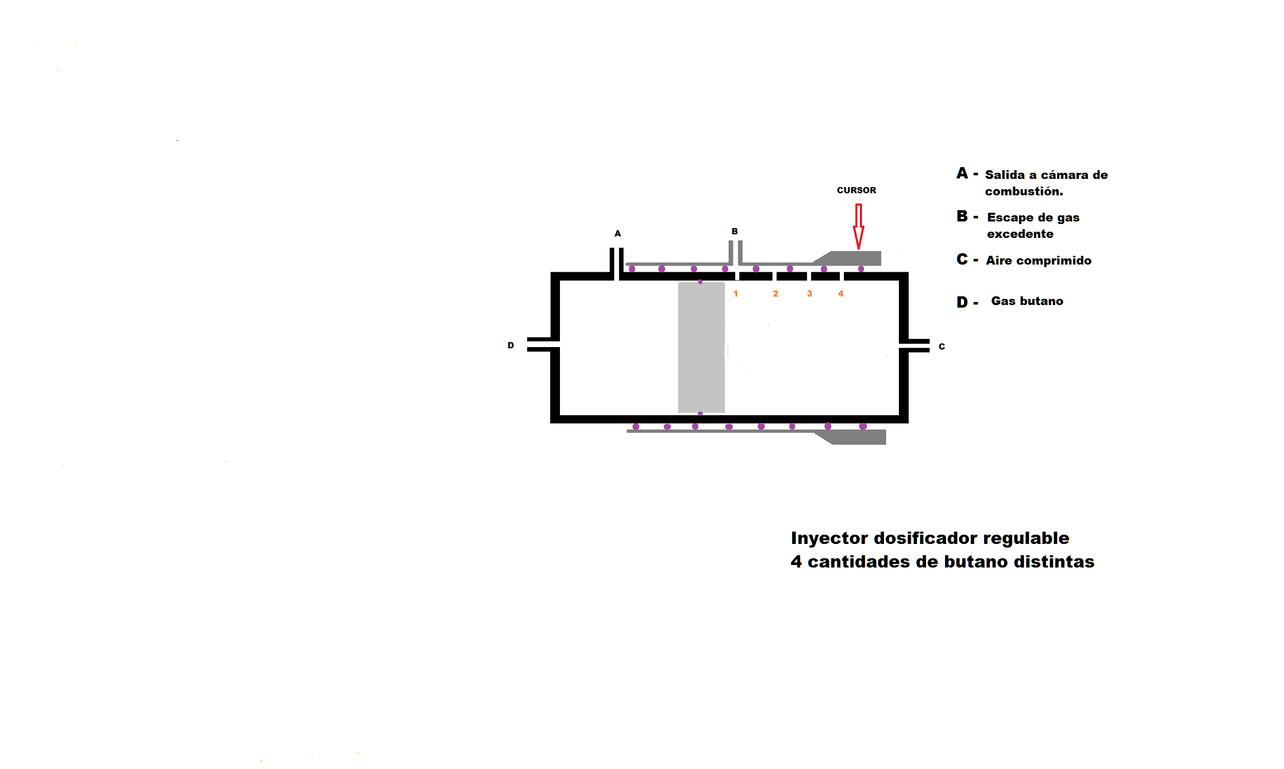

I'm thinking of improving the device responsible for measuring the fuel gas butane and injecting it into the combustion chamber. I came up with this simple form, and it seems to me a solution to be able to vary the amount of gas depending on different volume of each combustion chamber, (for the experiments), with the purpose of having an optimal stoichiometric ratio, for the different cameras.
The diagram has 4 possible gas quantities, but when you build it, it will have at least 10.
This will leave me free to have to build a new one, every time I try something ... :x
This system measures and injects at atmospheric pressure, which is how I use it in autonomous hybrids and in semi-automatic hybrid experiments.
The "CURSOR" moves so that the exit "B", which is where the excess gas escapes, communicates with each of the holes graduated in the cylinder. I have tried a simple version, and it works correctly. 8)

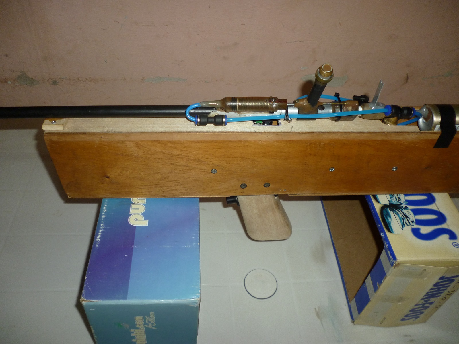

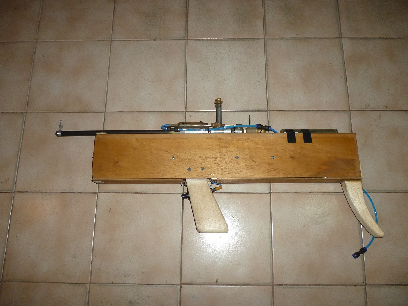

I managed to manufacture a small semi-automatic hybrid airsoft gun, I leave some pictures and next week I will make the corresponding video. Shoot 6mm plastic BBs, with enough speed at 5X. I have built some components again to make them smaller and put everything together in "something" with a sight and with a stock to be able to shoot. The compressed air tank the remote. It works perfectly, and shoots every 3 or 4 seconds.
The first problem is the excessive heat for the piston and several other parts that are resin ... The charger has capacity for 10 BBs, but I use it with 5 ammunition because I do not think it supports the heat.
The solution is to make everything metal.
I'm making an equal shot system but for 5.5mm lead spherical ammunition.It is very fun to shoot, and this "drawer" is prototype 1 :D
I can barely upload the trial video of shots to be seen in action, and the design diagrams.
The other way of design, much more complex in terms of construction, I have not been able to follow it for now, due to my own limitations in knowledge to machine these elements and for not having the necessary tools. I mean to use cartridges with the pressurized mixture in each of them, being the weapon only to shoot the cartridges in a semi automatic and automatic way. The system of loading and ejection of each cartridge would be by inertia of recoil, which Jack has already experienced and that works.
These design ideas, which I present here, are to be built with very few tools, and only this is the meaning of the project. :)

Mon Jan 28, 2019 8:34 am
el G11 Argentino!
:D
Looking forward to seeing the video!
Argentina
Posts: 1064
Location: Argentina
Has thanked: 274 times
Been thanked: 276 times
Mon Jan 28, 2019 9:17 am
jackssmirkingrevenge wrote:el G11 Argentino!
:D
Yes, it is similar to G11. I was looking in google, because I did not know this weapon. Maybe I removed the shoulder rest to make it more similar :D

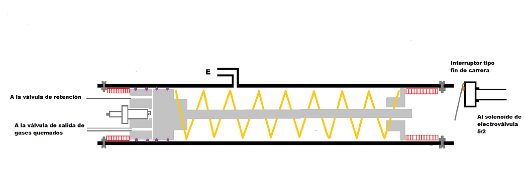

These are the final diagrams of the loading system of BBs, pneumatic system and combustion chamber.
For the pneumatic system to work, it is necessary that the compression pressure of the hybrid be greater than the pressure of the butane gas. In the case of this prototype, the gas does not exceed 3.5 bar, and the hybrid pressure is 5X- 6X.
Following the red and blue arrows, it is clear :?
The solenoid timer system is a relay and an electrolytic capacitor. According to the value of the capacitance, it is the time that the solenoid valve 5/2 is activated, (position "YES" in the diagram).
Any questions on this subject, ask and I will answer.
