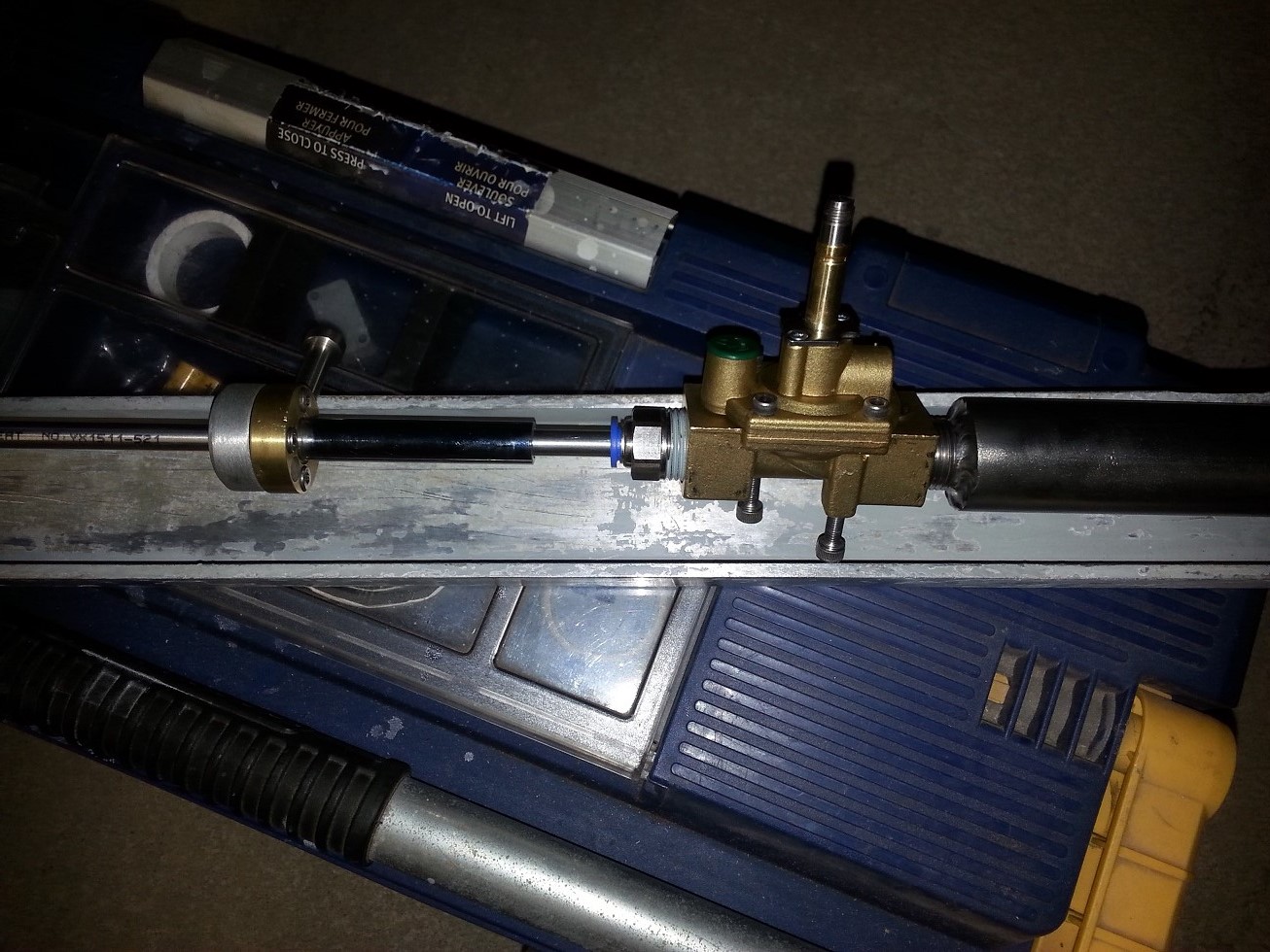

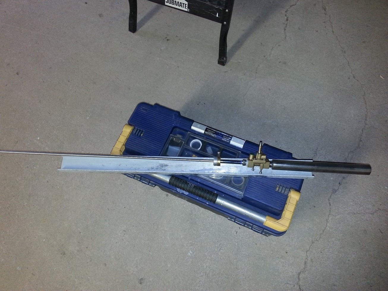

Got some parts together for a .177 smooth bore pellet gun (or BB), .18 ID stainless tubing, 1/2" 24vdc solenoid valve and 12" x 1" stainless chamber. Going to be a simple breech load with a sliding tube which has a seal at one end and will push against a O ring at the valve end to get a good seal on the tube. :idea:

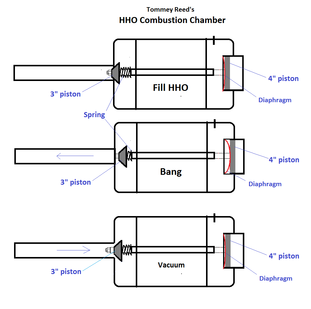

I was seeing weapons that work with HHO and there are several. I have found some diagrams, but basically, I suppose it is a "normal" combustion weapon, with this type of fuel. What would be interesting to store in a gel or foam of some kind, lasting at least a few hours, HHO, as a solid fuel for combustion weapons. I mean to introduce the HHO as foam, in a cartridge and seal later. The H and O are trapped there.
HHO Rifle Basic Design..png (21.49 KiB) Viewed 7347 times
HHO high pressure output.png (10.87 KiB) Viewed 7347 times
Sun Aug 12, 2018 7:30 am
The use of combustion to power a piston is interesting and something I had touched upon in the past:
Jimmy had done some experiments with closed chambers burning propane and he confirmed the limits of combustion pressures at below 150 psi which is not very useful for propelling small caliber projectiles to interesting velocities, but by using this pressure to propel a larger diameter piston, better performance is possible.
This one is basically how combustion nailguns work and the velocity of the projectile is limited to the velocity of the piston. Since you have to stop the latter, there is less practical performance potential unless you want to launch something heavy at relatively low velocities.

Basically the small ammunition is pushed by compressed air, and you use the pressure generated in the combustion as a "thermic spring". Interesting to try ...
It would also be possible to use a combustion with compressed mixture, a hybrid ... a matter of testing and developing.
