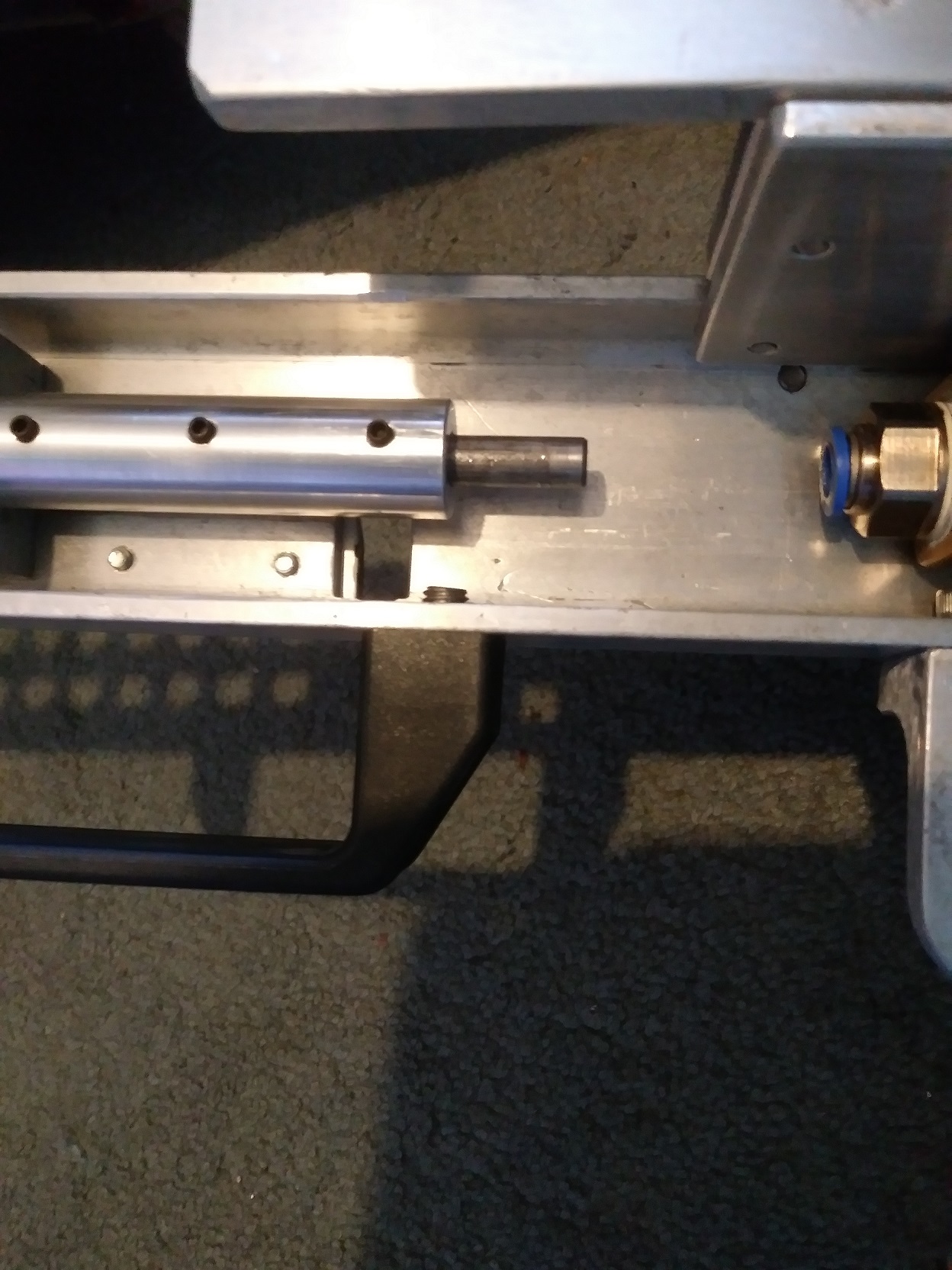

Never being really happy with anything I pulled it apart again, changed it back to the .177 barrel, now at only 12" long (cut down the body), and made it a sliding barrel, much easier to load and zero dead space. Some work on the sliding stock also so it goes fully in.
