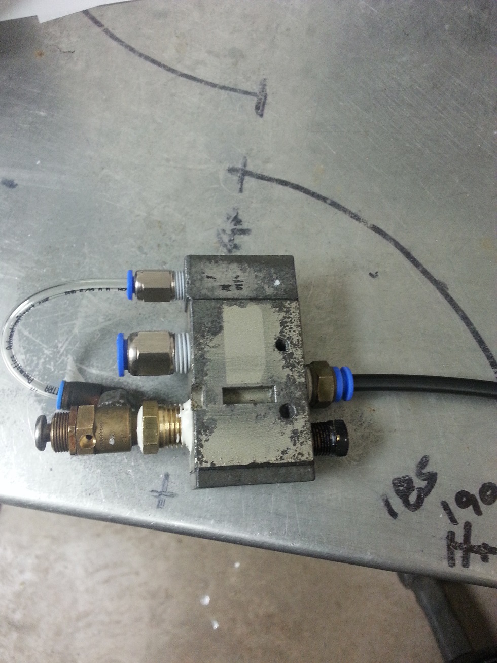

Just playing with an old 5/3 air pilot valve and a small push button 3/2 for the trigger, this actually works for a single shot, if I take the plug out of the port on the bottom right it goes full auto crazy :shock: it dumps the pilot air, closes the valve which brings back the pilot air, not what I want but pretty neat if I did.

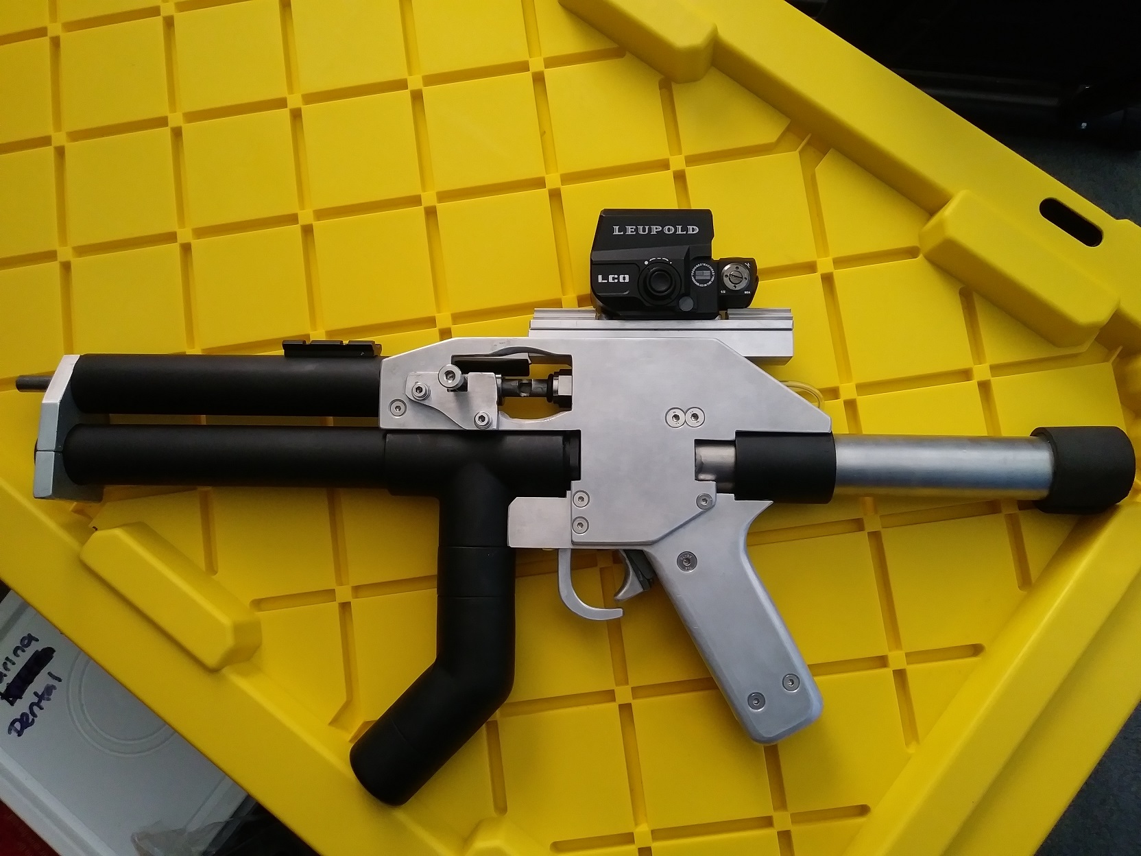

Thu Nov 01, 2018 5:48 pm
Going to make a 4.5mm BB gun, not sure if it will end up being select fire or full auto. Using wood for the first time, the body will be 2 pieces of 3/4 plywood joined together, magazine will be spiraled around the chamber and be air fed from air bleed off the barrel. Should hold at least 200 bbs.

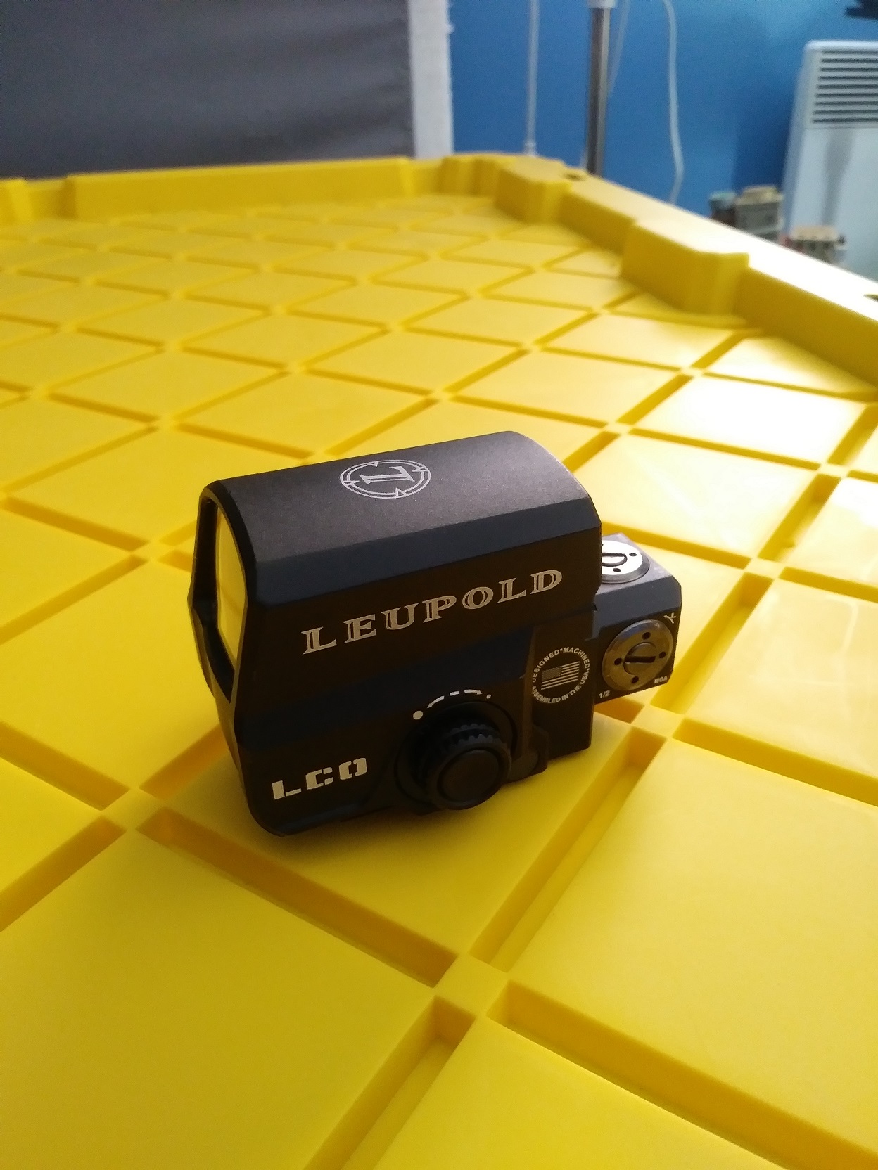

Got a red/green dot today that I won in a competition, will go nice on the single shot airsoft or maybe the BB :idea:
Argentina
Posts: 1064
Location: Argentina
Has thanked: 274 times
Been thanked: 276 times
Sat Dec 08, 2018 10:45 am
Good thing you won! That looks good on almost any weapon. Enjoy it :)
Sun Dec 09, 2018 7:28 am
Is that a genuine Leupold? If so, great acquisition!
