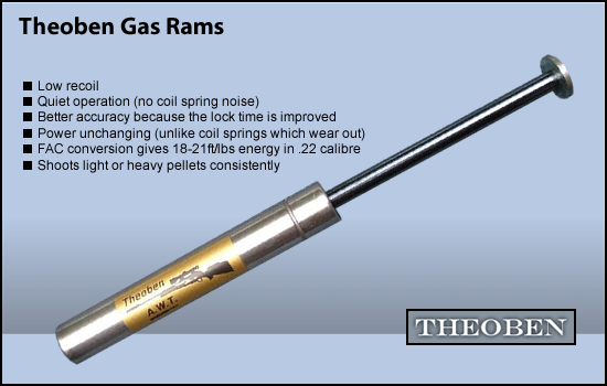

Anybody knows how a gas ram/ spring works? I tried to make a gas ram powered bolt action but no matter what I do it leaks over time, I made sure the surfaces are smooth, free float and right size o-ring (two of them even!) and it just leaks...

A bit like a gas ram that holds up a car tail gate.

I know, but how does the inside looks like?
Wed Nov 28, 2018 9:03 am
farcticox1 wrote:A bit like a gas ram that holds up a car tail gate.
That's more or less what it is, here is the relevant patent.
Personally, I think such devices are of limited relevance to the average spudder because of the need to retain large amounts of stored mechanical energy on a single point, in a manner similar to a crossbow. It can be done, but it's easier and more practical to store that energy as pressurized gas that is released by a valve. If you look at commercial airguns, there is a fairly low upper limit that such configurations can achieve in terms of energy in the 30 ft lbs range, while precharged pneumatics can be an order of magnitude more powerful.
