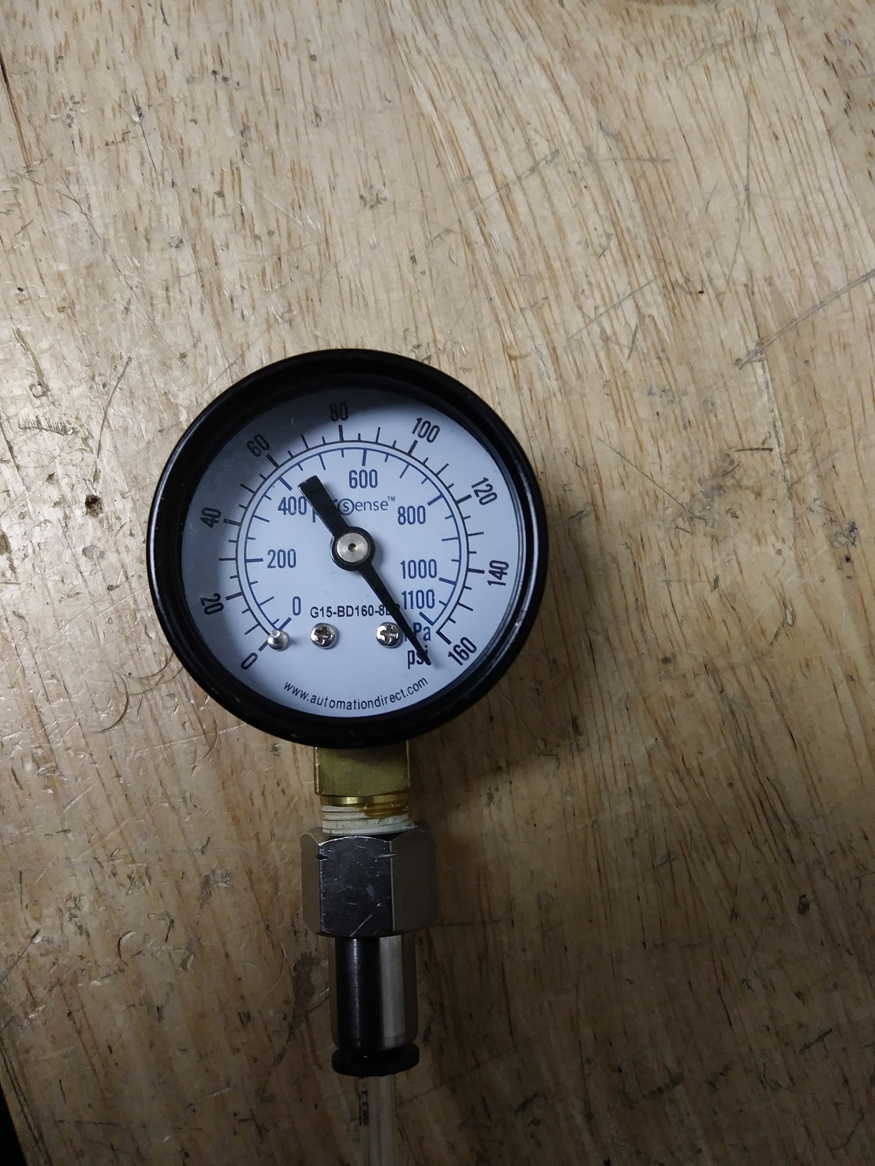

Got compact non return valves from McMaster Carr and was able to easily hand pump over 160psi with no precharge, but volume is really small, will take a long time to fill a tank of any volume.
- Sergeant
- Posts: 1064
- Location: Argentina
- Has thanked: 274 times
- Been thanked: 276 times
Similar to the air bombs in my arms. Unfortunately, it only drives small volume of air. To fill a deposit does not reach unless you are all the afternoon giving and giving pumping
The critical element is the spring pushing against the pressure, as these things are typically made for a 850 psi output then the stock spring is going to be far too strong.
You can find low pressure kits for certain models but the output is typically higher than 150 psi.
Something like this will probably work better but make sure you have a safety pop-off or burst disk in your circuit, if a seal fails inside then it's full reservoir pressure to your system.

I bought several of these, work wonders. Air flow is healthy and stable.jackssmirkingrevenge wrote: Something like this will probably work better but make sure you have a safety pop-off or burst disk in your circuit, if a seal fails inside then it's full reservoir pressure to your system.
- Sergeant
- Posts: 1064
It is definitely the best option for my project.Something like this will probably work better but make sure you have a safety pop-off or burst disk in your circuit, if a seal fails inside then it's full reservoir pressure to your system.

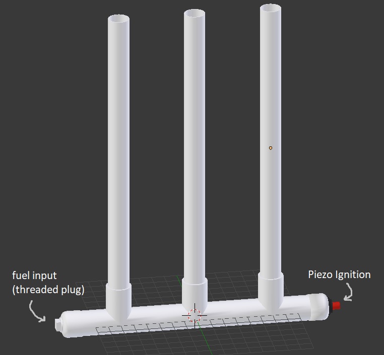

What's the best way to calculate performance for something like this in HGDT?
All three barrels are connected to the same combustion chamber and share the same ignition.
I would combine all three barrels and projectile weight into one.Cthulhu wrote:What's the best way to calculate performance for something like this in HGDT?
For example if they are 1.5 inch barrels, that's a cross-sectional area of 1.767 square inches each, for a total of 5.301 square inches each. This makes them equivalent to a single 2.598 inch diameter barrel. If your projectiles are 50 grams each, calculate for a projectile weight of 150 grams.
