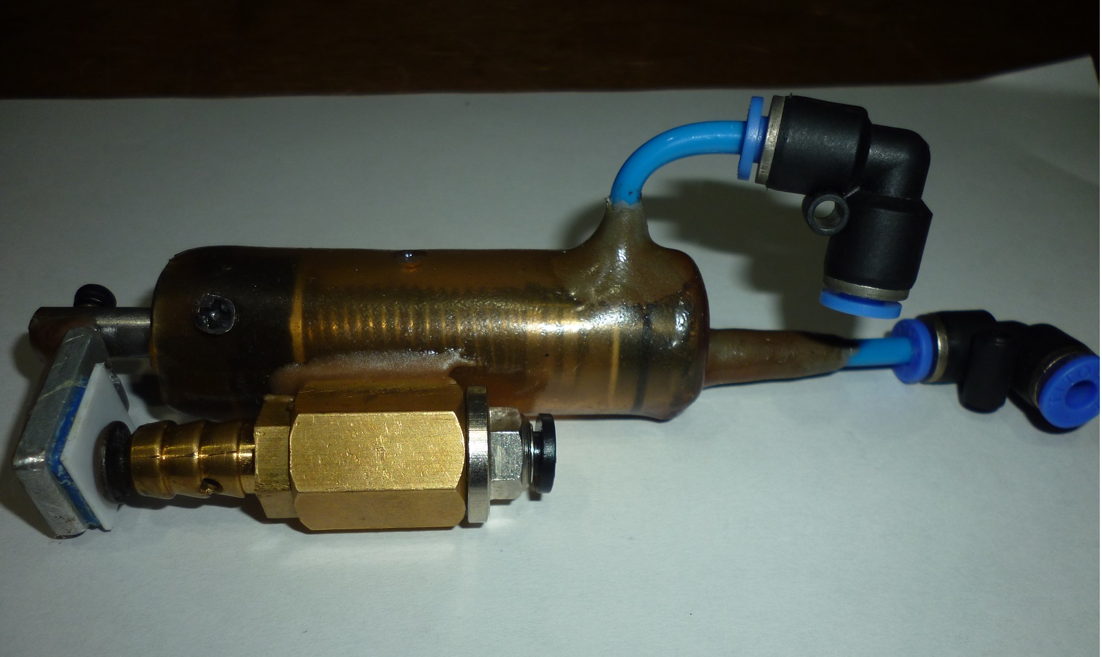

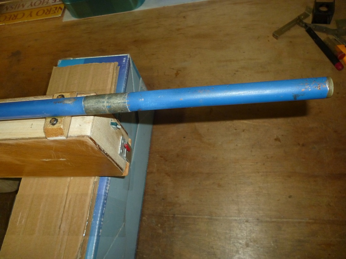

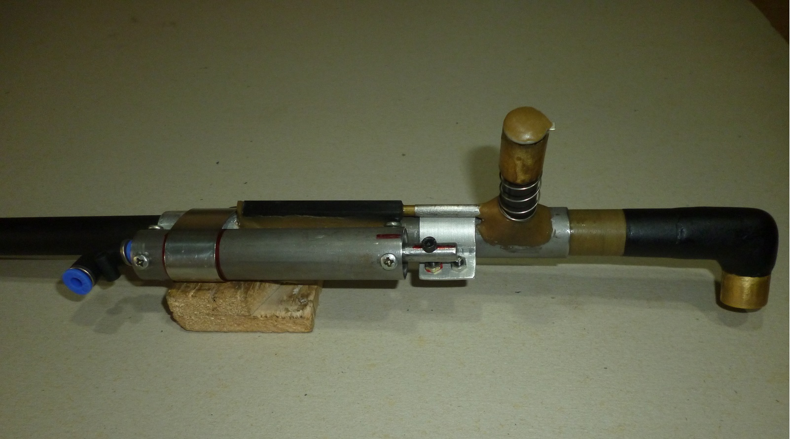

Here I leave several photos of the new ammunition loading system and other components. The photos are being installed, inside the weapon. Later on in time, I will upload a new shooting test video with the new cal.22 spherical lead ammunition system.
1- Loading system
2- Loading system with pneumatic actuator.
The red arrows indicate where they are attached. I need to do this.
3- Ingestion of the ammunition to the tube that contains them. It can accommodate 7.
4- Shot gun .22, manufactured with a 5/8 "tube and resin inside.
5- Simple effect pneumatic actuator. Produces 12 kg force at 6 bar.
7- Check ball valve, main.
8- Gas dosing unit and low pressure check valve, in the automatic air-butane mixing unit.
9- Exhaust valve that cleans the burned gases from the combustion chamber and its pneumatic actuator
