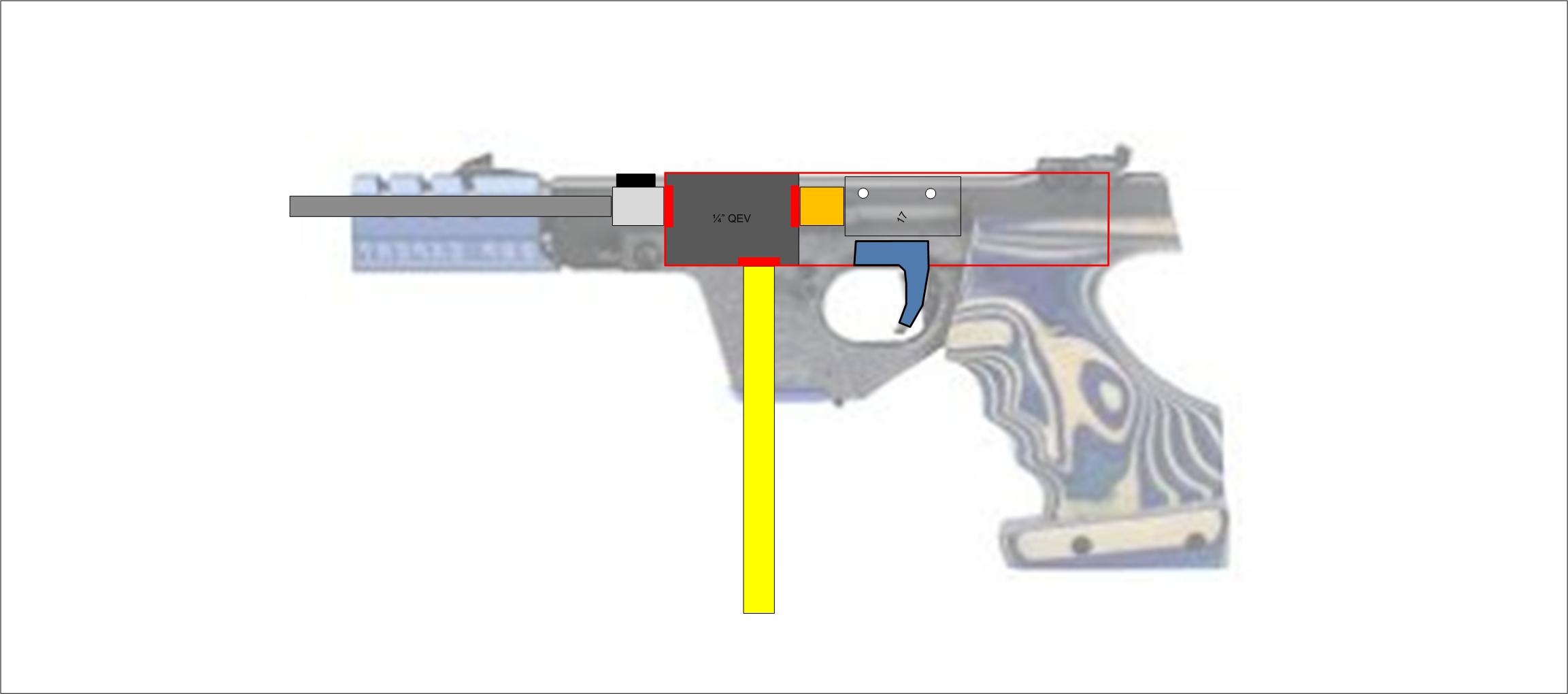

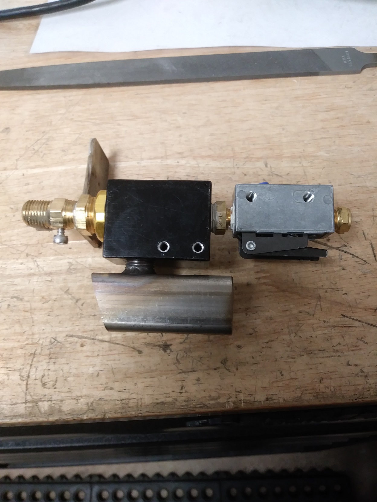

A few parts lined up for a simple 4.5mm BB pistol, 1/4" QEV, 1/8" 3/2 lever valve for trigger. Interchangeable barrels :idea: Single shot muzzle load with a magnet to hold the BB :idea:

Looks good, though I would say the chamber is far too big, most of that air is going to be wasted. You should really try for higher pressures in a much smaller chamber, especially with the small caliber and all-metal construction.

Ha Ha yes, I am fabricating a square chamber which will be hidden by the side plates, still has at least 4x the 8" barrel volume :D

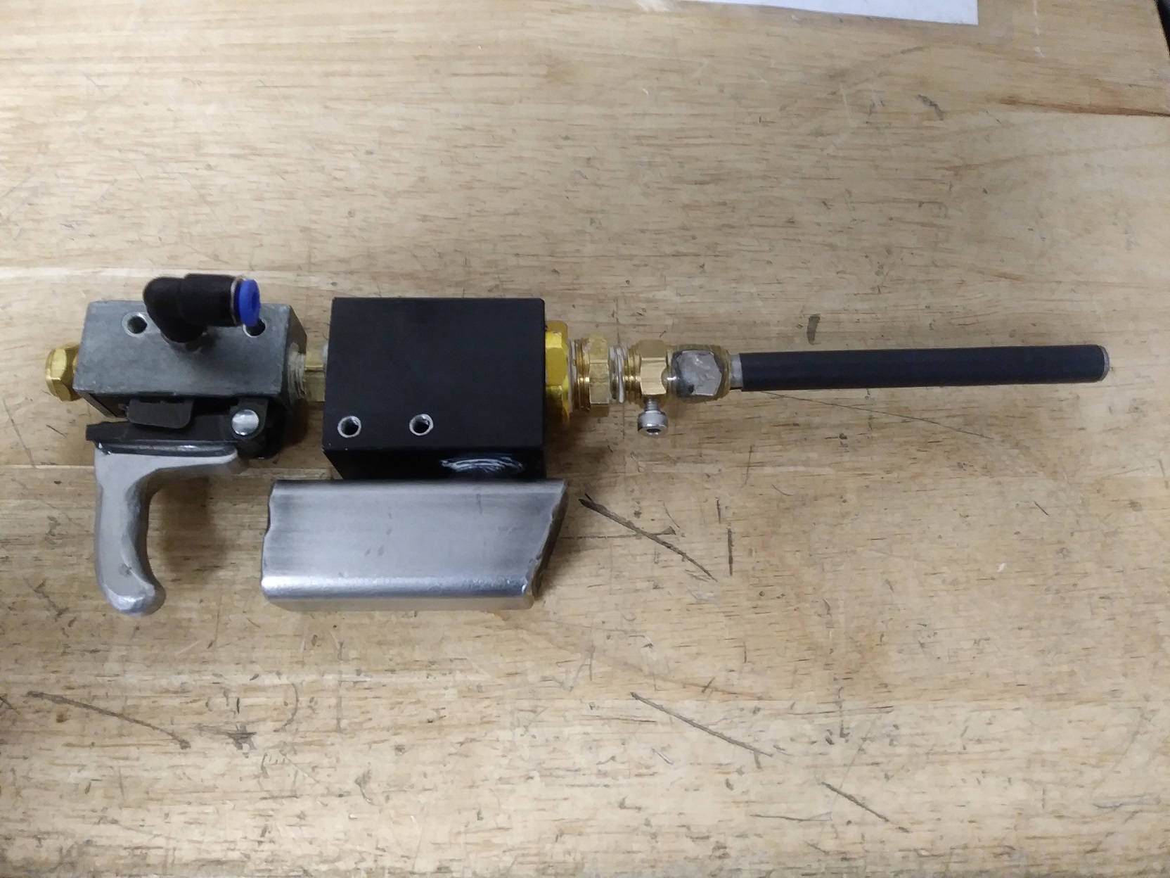

farcticox1 wrote:square chamber
Not normally recommended as a pressure vessel... though I imagine the wall thickness is completely disproportional to the pressure you will be using.

The tubing and end caps are 1/8" stainless, won't see much more than 150psi.
So this is the heart of the beast with the 5" barrel, pretty simple (KISS) just needs an air supply.
