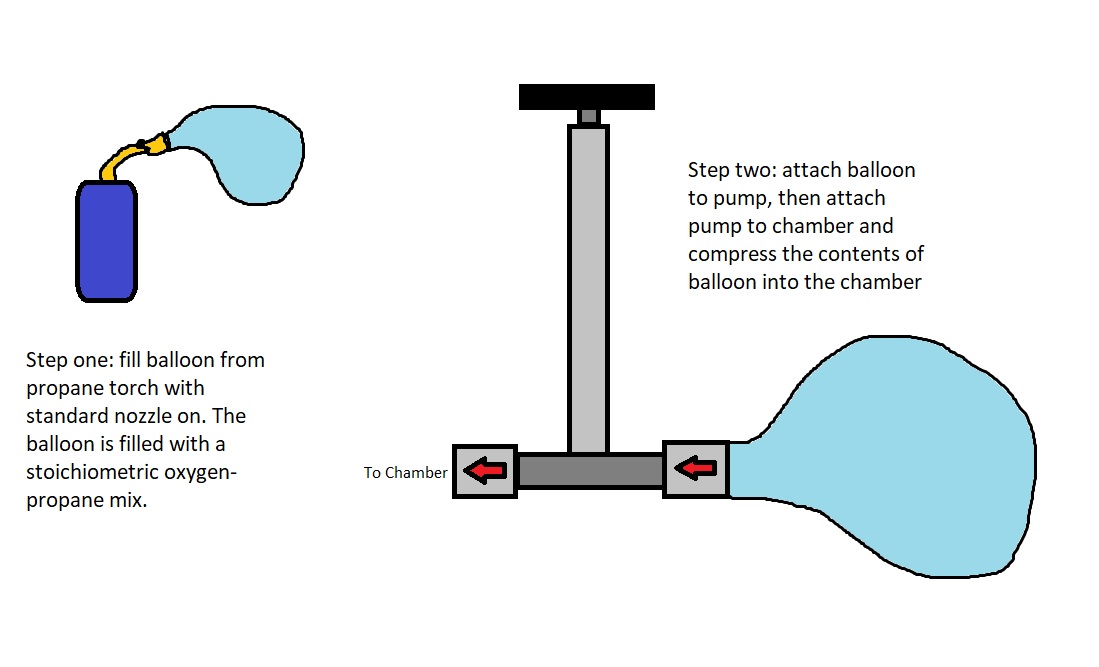

I know syringe fueling can be used for hybrids. but could a homemade pump with the inlet port attached to a balloon filled with propane-air mix from a torch nozzle be used?
I know it's primitive but I think it would be easier to just inflate a balloon and pump it into the chamber instead of having to measure fuel and pressure between each shot.

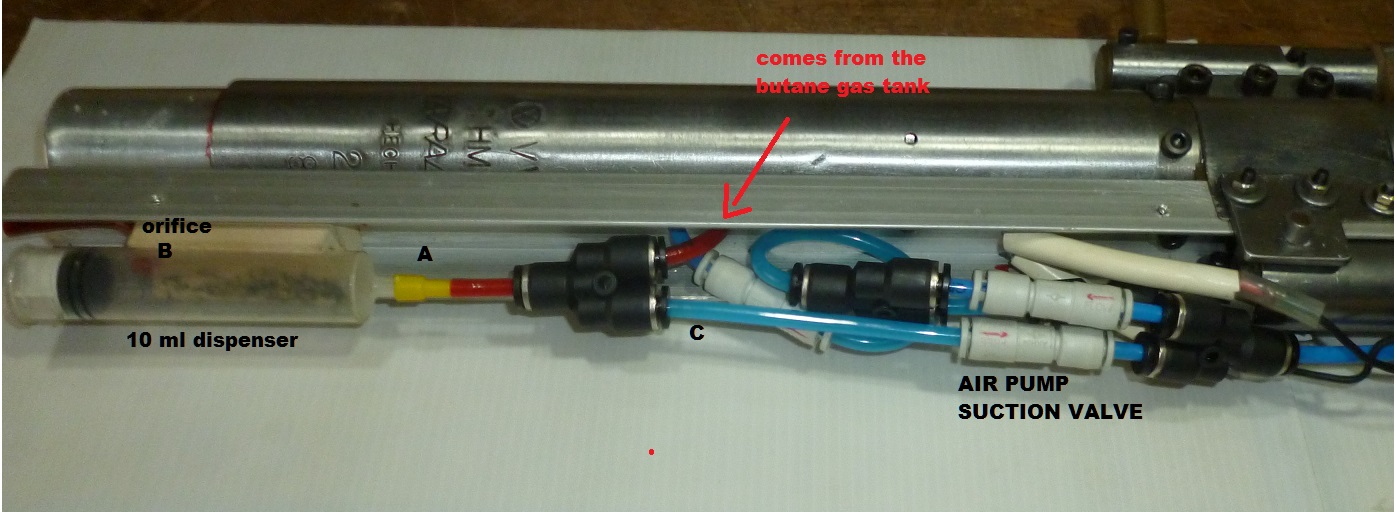

If you get a simple air pump, with an intake valve, when the pump tries to suck air, it can suck the combustible gas and then air only until it reaches the required pressure.
Another option is to inject the propane dose directly into the combustion chamber with a syringe and then refill with air ... Le muestro un video y un dibujo.
When you press the valve that lets the gas from the tank, "A", the air from the dispenser is expelled and is filled with butane, it is a volumetric meter. Hole "B" lets out a little to maintain atmospheric pressure.
When the pump aspirates for "C", it sucks the butane gas (the first pump), and then only air, (also for "B"), until it reaches the necessary pressure that you have programmed. The air pump pre mixes the gas and air. My autonomous hybrids 1, 2, 3 and 4, work this way. :shock:
This method, that of drawing, allows you to use small things, (a balloon is very large and unsightly), and not having mixed air and fuel, because it is dangerous.
This is what the actual installation of what I have drawn looks like.
CDIS simple HA.png (31.28 KiB) Viewed 22767 times

That's a good idea hectmarr, I might need to look into making something like that.
mrfoo wrote:Probably, but I'm not sure how you're proposing to guarantee a stoichiometric mix from a propane-oxygen torch. All the ones I've seen have 2 pressure regulators, and a torch with 2 controls, it's no just a "press the button for perfect mix" type setup.
I'm probably wrong, but don't those cheapo bernzomatic torches use the venturi effect in their nozzle which pulls in air behind the fuel right at the nozzle to mix in the right amount of air?

> venturi effect
Yep, but that requires there to be atmospheric pressure on both sides. If you try using one to push an air-fuel mix (which is, in passing, a very different animal to an oxy-fuel mix) into a pressurised container, it simply won't work.

mrfoo wrote:> venturi effect
oh that makes sense, so it might not work even with the flexible container of the balloon.
