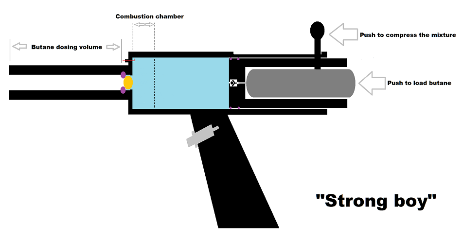

I am planning to build a low compression hybrid, about 3 or 4X, which uses manual force, :roll: using the bolt to compress the mixture. I have thought about using the firing gun, with a previously defined volume, to dose the butane. At the end of the day, it is a cylinder of known volume exactly the same as the one I am currently using to dose in my air pump hybrids.
After testing how much force I can exert through the bolt, using a fish scale up to 40 kg, and I generated 25 kg with a little effort, not terrible. The area of ​​the piston is 4.9 cm2, (2.5 cm in diameter), and with 20 kg I can achieve a pressure of 4 bar, enough to play for a while! The projectile's load, 1/4 "steel bb, is through the mouth of the barrel, and the seal is a screw-regulated o'ring (not seen in the drawing). It is a simple weapon and is only necessary the ammunition and a can of gas to introduce the fuel.
To load the butane, the tank must be pressed to flood the firing barrel with the bolt fully closed, and without placing the ammunition. Next, the bolt handle is retracted back to suck the gas into the combustion chamber at the same time as the air. Then the ammunition is introduced, and it is compressed with the crank, and then by twisting the bolt it is locked and ready to fire. I am seeing the real measures to build it.
It is already understood because it is called "Strong Boy" jajajajaja :D

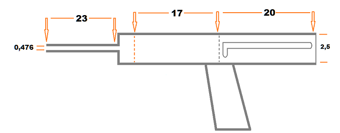

Compression cylinder 2.5 cm in diameter, area, 4.9 cm2, useful length, (to compress), 16.5 cm.
It would have a mixing volume of approximately 80 cm3
The amount of gas at 5% would be 4cm3 of butane.
A 4.76 caliber barrel, steel bb, must be approximately 23 cm long, to be used as a dispenser.

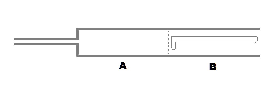

It would look roughly as in the drawing :roll:
In another case, if I decrease the diameter of the piston to 1.8 cm, the area is 2.5 cm2. To obtain 80 cm3 of mixture, the useful length of the compression cylinder is 32cm. As double the length is necessary for the bolt system, the body of the weapon is 62 cm long and a 23 cm firing cannon. I have no problems with this appearance, I just have in mind that it is as comfortable as possible to zoom in.

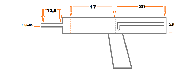

Can you give me your opinion on the approximate minimum quantity of mixture that can be used, for a 4.76 mm caliber, a pipe length of 25 cm, in a 4X hybrid? :roll:
The approximate dimensions would be like this, (the measurements are in centimeters)

If the caliber is 6.35 mm, the weapon would look more or less like this. The barrel has a length of 12.5 cm, to have, in that caliber, 4 cm3 of volume! I'm laughing alone here :wink:

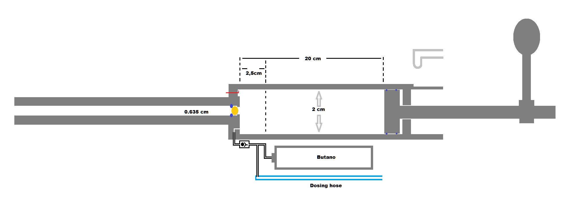

Another way to do this is as in the drawing.
Locate the small butane tank outside, and use a piece of 6 mm plastic hose to dose the volume of butane, (technique that works very well). In this way, the barrel can be as long as desired.
On the other hand, I will use a rod that stretches to aspirate the butane and the air, but when compressing the mixture, and after locking in the notch, it protrudes little, precisely, at the time of aiming and firing the weapon, everything must be as comfortable as possible. To carry, in the same way, the rod is attached to the barrel and everything is much shorter.
In fact, this design does not provide anything of complexity, but it allows you to build a shorter and unlimited weapon in the barrel length, (which is going to be .25 caliber, because as Jack says, the bigger the hole, the better! :D )
Otherwise it will have 8X compression that is better, because of the simulation data it showed me. It will take about 25 kg of force, which I can exercise without problems, (yet!)

This idea is awesome for sure. I had a similar idea for a larger cannon using an acme thread with a turning handle to compress the piston. The only thing I didn't like about the idea was the very long chamber, but with a smaller device like yours, it isn't an issue.
Perhaps you may consider incorporating a threaded end cap and a threaded rod with the piston head and a turning handle. I think you could get more compression that way, but the design gets a little more complicated because you have to seal the threads somehow. Even with just pushing the piston in like you have it should work well.

Yes, you told me about that idea of you, of using the force of a screw to compress. It is a disadvantage to compress from a chamber at atmospheric pressure, because of the bulky chamber, especially in a large weapon. As you say, in a small weapon, this does not bother much. This is born of testing if an air pump that I have here was losing air, when I had to change the o'ring and I didn't have the force lever connected yet. To my surprise, applying force directly reached 6 bar, and I thought it could be used directly in this way. The facts gave me the corresponding lesson.
I like to use a threaded rod, I will try to do it. I am looking for 20 mm diameter steel tubes, which are recycled from car shock absorbers. Threads are not an option at the moment, because I don't have a lathe.
