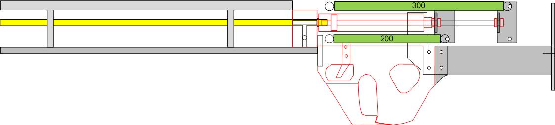

Layout for my next spring powered air soft with a 4" stroke piston and 2 expansion springs, this time with rearward charging.

Layout something like this
WIP 1.jpg (31.23 KiB) Viewed 73032 times

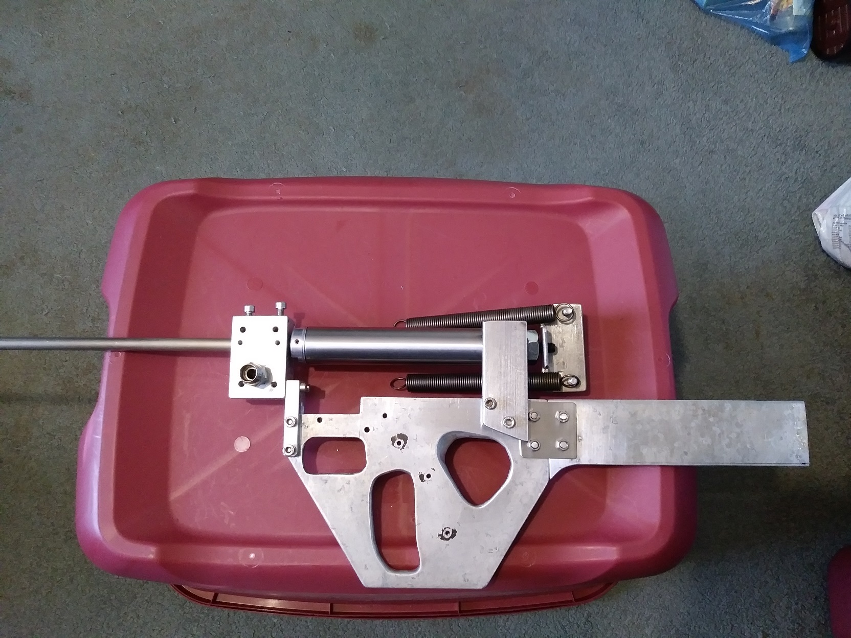

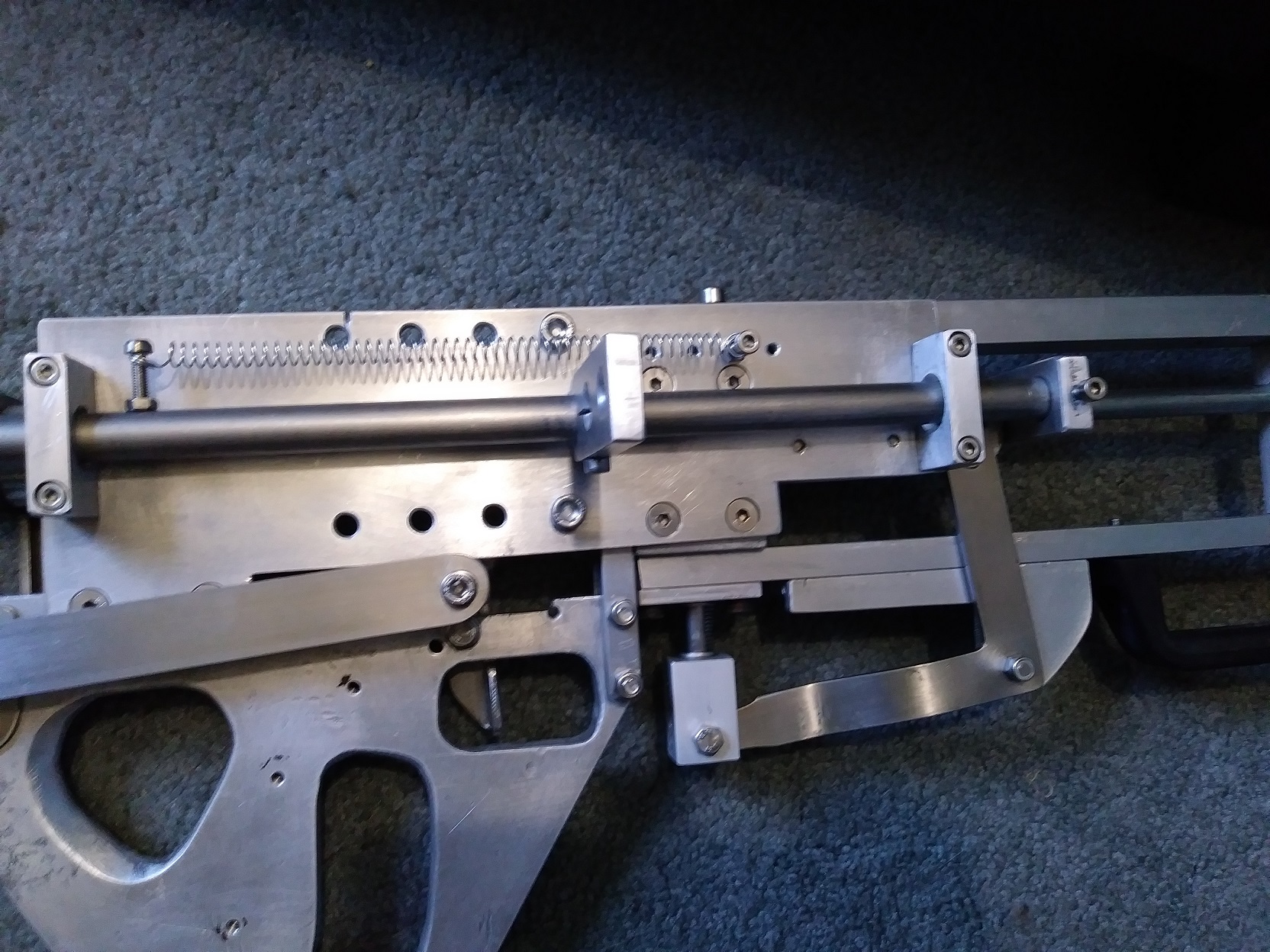

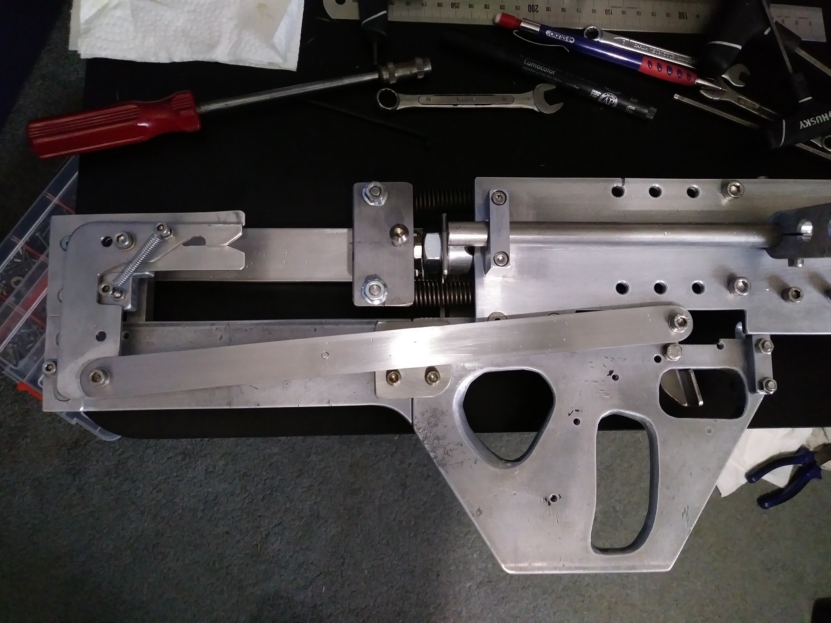

Got the locking and trigger release mechanism working.

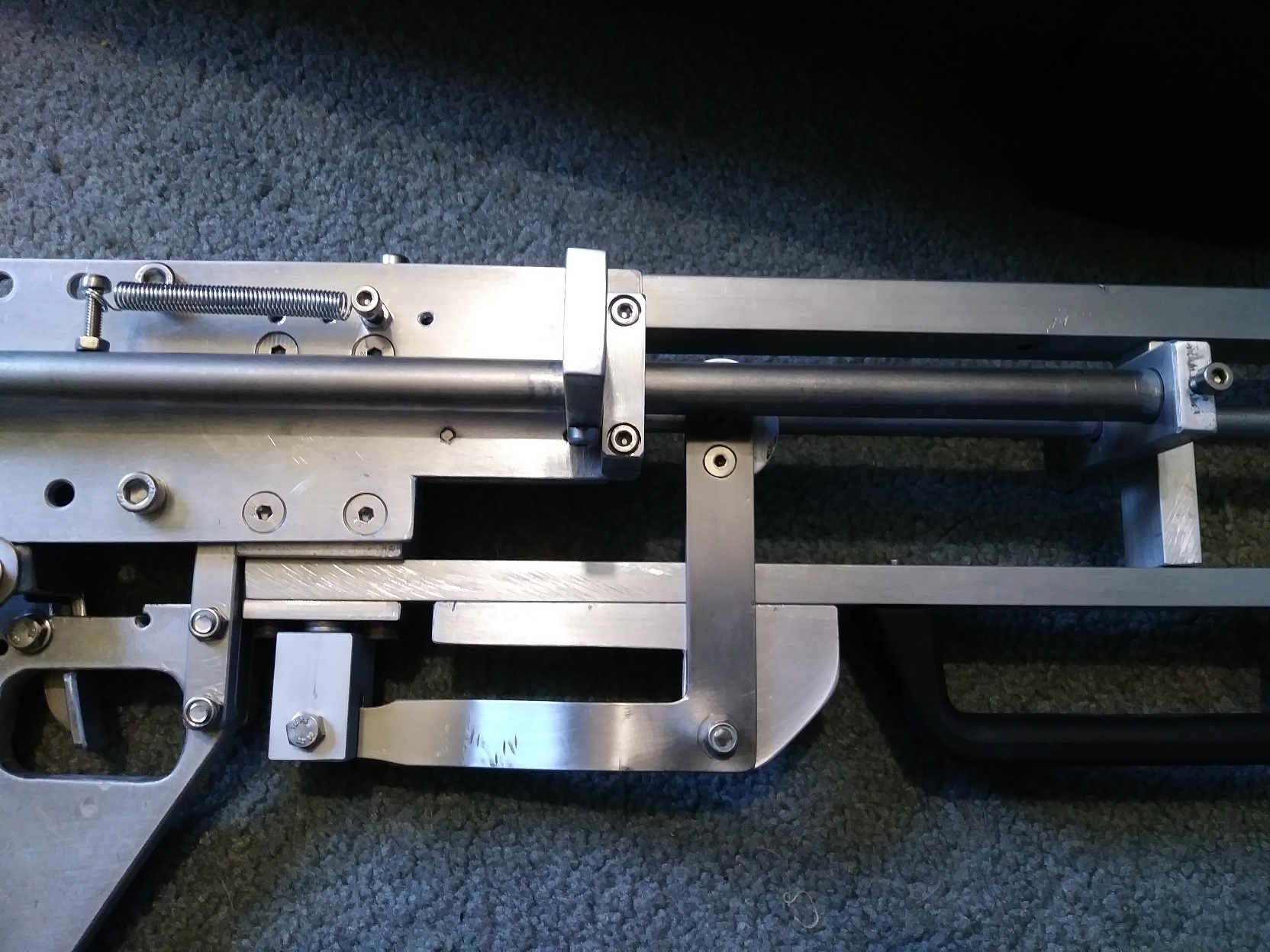

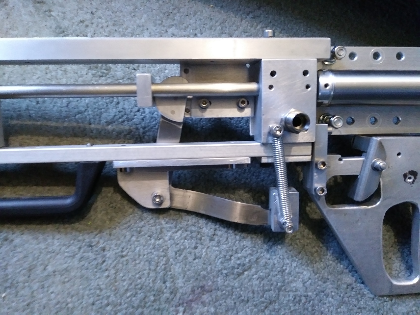

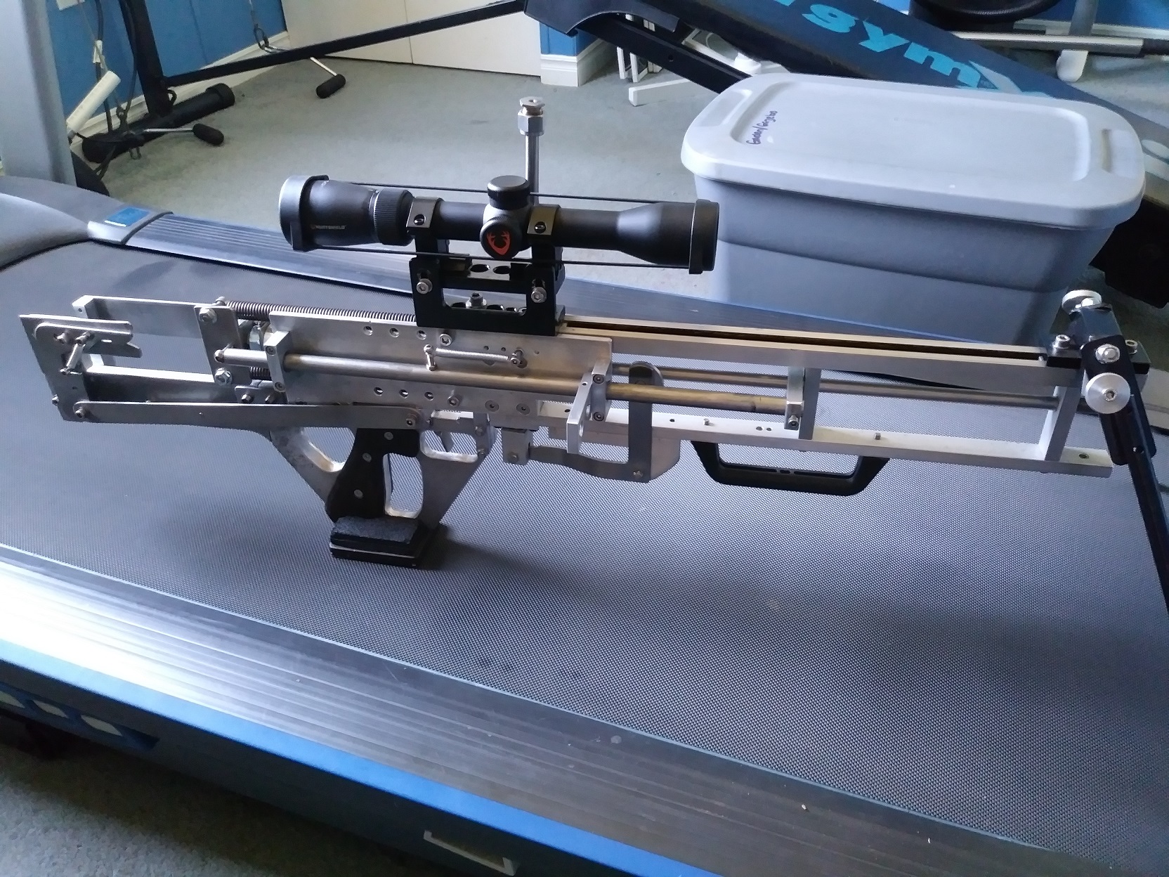

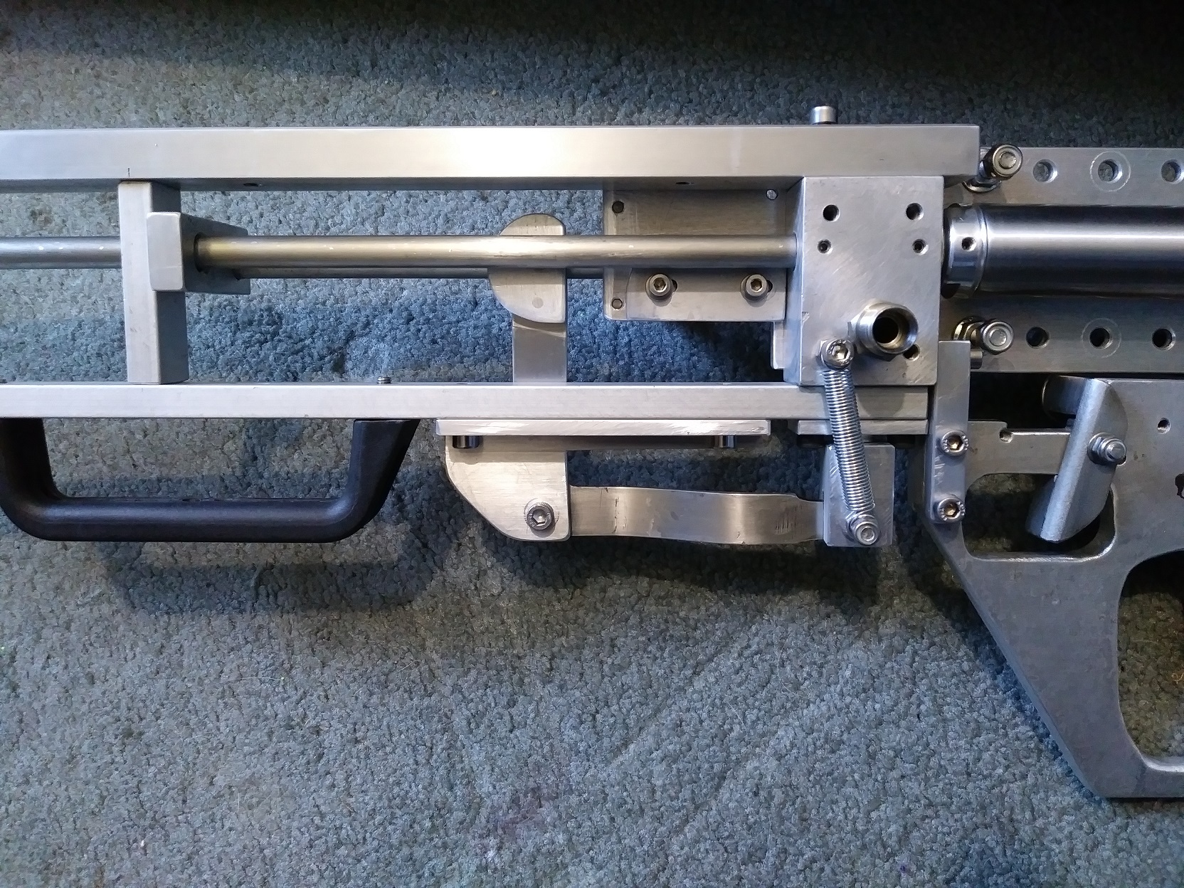

Getting the loading mechanism linked into the charging mechanism has been a headache but it is getting close.
Charge/load position, block on the charge rod moves about 80mm then hits the rounded piece on the L arm as it only needs about 20mm movement to move the plunger to the load position.

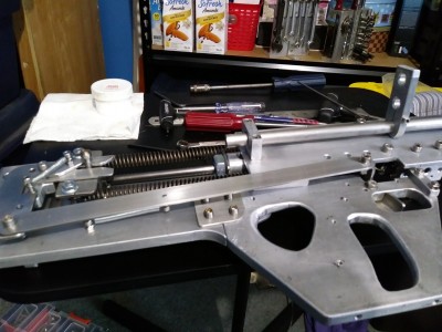

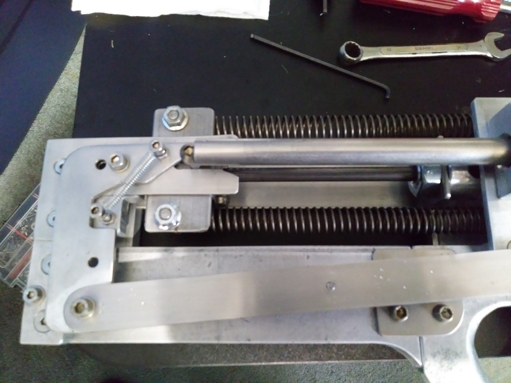

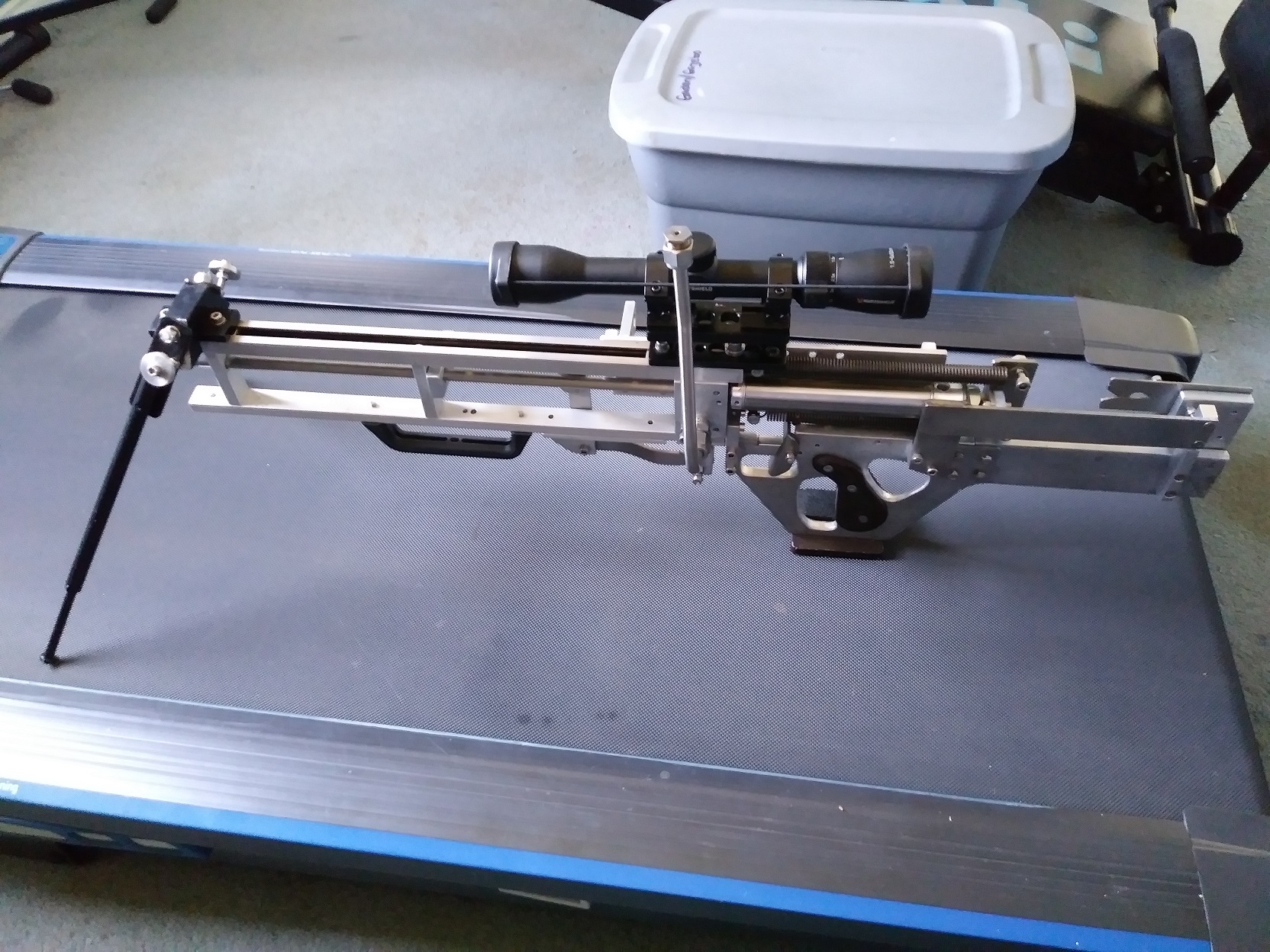

Mostly complete and had some test firing, loading works ok, just need the scope set up. Need to make butt plate and cover for the top spring.
