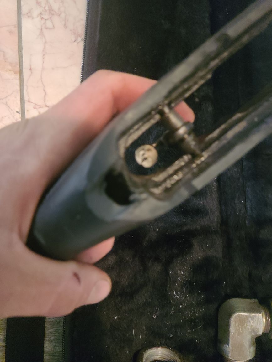

I have built many more great toys over the years and I felt like getting back into the community to share my knowledge as well as to learn and become better my self.
This is my greats feat so far.
It has 50cal muzzle loader barrel rifled 1:70 from green mountain rifle barrels.
The main components of the rifle are 3/4" 3000 psi hydraulic plumbing. The 3/4" street tee has a 1-3/4 male male adaptert. A 1" cap drilled and tapped to fit a 1/4 nipple and reinforced with jb weld(the only component not rated to 3000psi at the time of writing).
It is operated by a custom spool valve made from a brass street t and a 1/4 cap. (At 3000 psi even a shreader valve take 250 pounds of force to actuate)
The operation is what I'm calling a spool valve opposed to a piston due to the fact I am using oring seals instead of a sealing face.
The piston is machined from aluminum round stock.
The rifle stock is from a ruger 10/22. I had it laying around and it fit, so why not?
I dont know of i covered everything. If you have any questions let me know.
I'll let the pictures day the rest!
Sorry for the random order of stuff.
