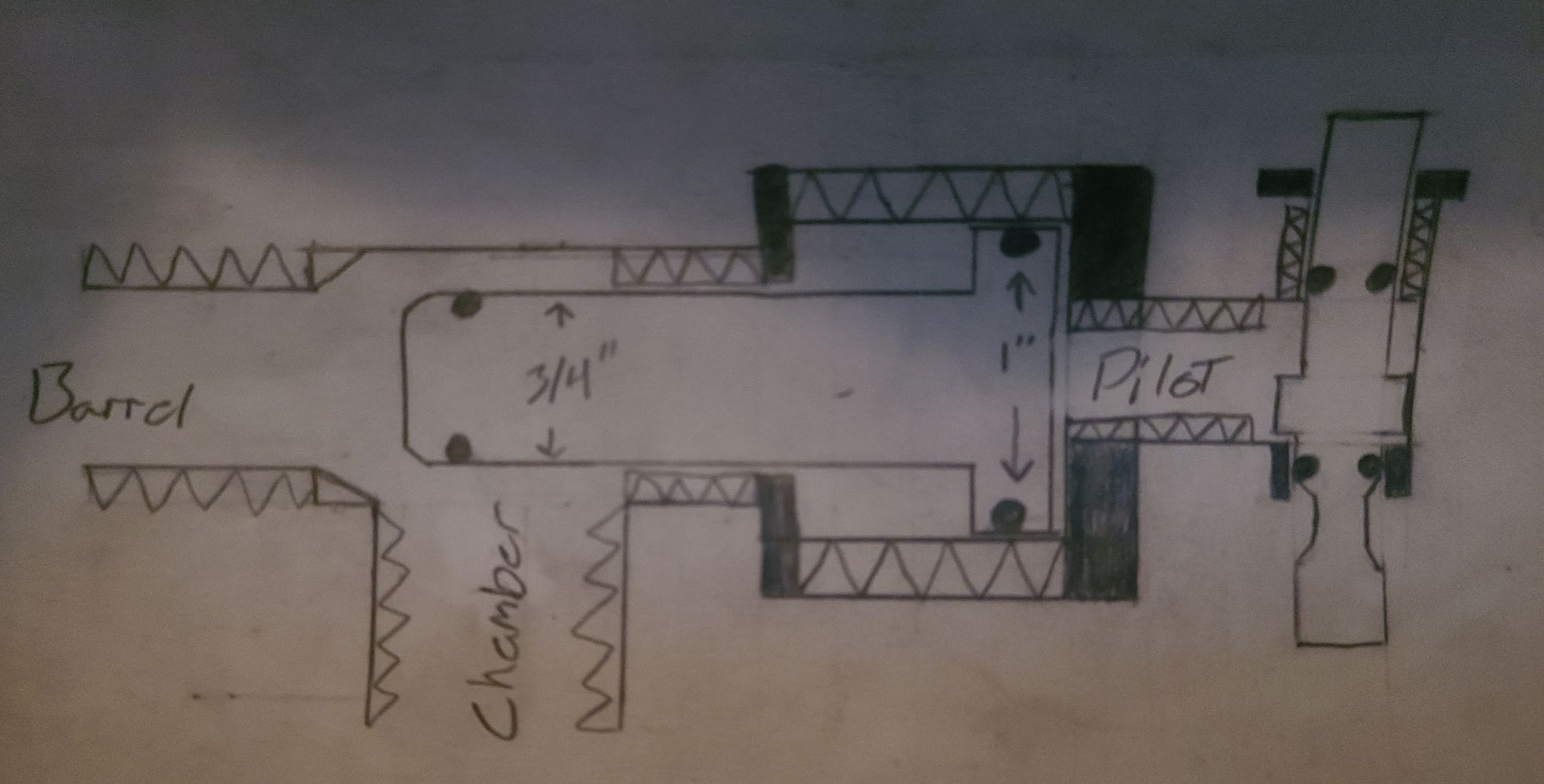

Also it is a barrel sealing piston. The "face" sits inside the barrel instead of pressing up against it. The rear oring is a "floating oring" so air passes one way to fill the chamber. It cannot flow in reverse.

PracticallySane wrote:
Sun Dec 27, 2020 10:42 am
His drawing is very clear, which is worth ten thousand words! THANKS! :)
The barrel side oring is what seals. I like the concept, because it is simple.
The "floating o'ring" lets air pass from the exhaust valve on the right to the main air chamber on the left and below.
Thanks for the drawing. In the future I will try to do something with this idea, a hybrid for sure.

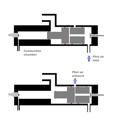

válvula de sello con oring.png (16.95 KiB) Viewed 9673 times
This is the drawing of what I built.

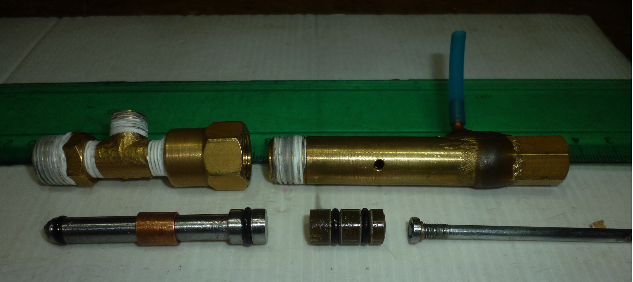

Sun Jan 03, 2021 2:55 pm
A photograph of how it was. I am building a mechanism so that it closes automatically. The small piston with two o'rings and the hole in the center is for decompressing. It is fiberglass because it only supports 6 or 7X pressure. The hard part is the one that seals the chamber.
I leave here in this publication what I did, because I think it is not necessary to make a new topic, it is a comment of the same.

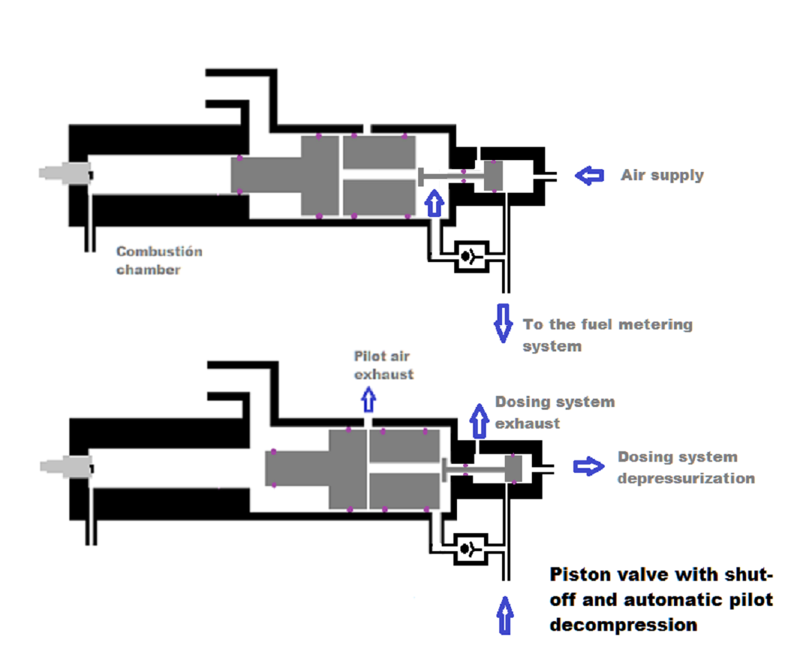

Mon Jan 04, 2021 6:10 am
Add what was missing to get the valve closed automatically. It works correctly, luckily. The valve closes when you let in compressed air and the pilot depressurizes immediately after firing.
The dosing system that I am testing needs to be able to decompress to measure the right amount of butane, it is of the volumetric type. I'm thinking of adding a 60cm firing cannon, with 12 microstriae that I bought a long time ago, caliber .25, and firing ordinary pellets 8-)
