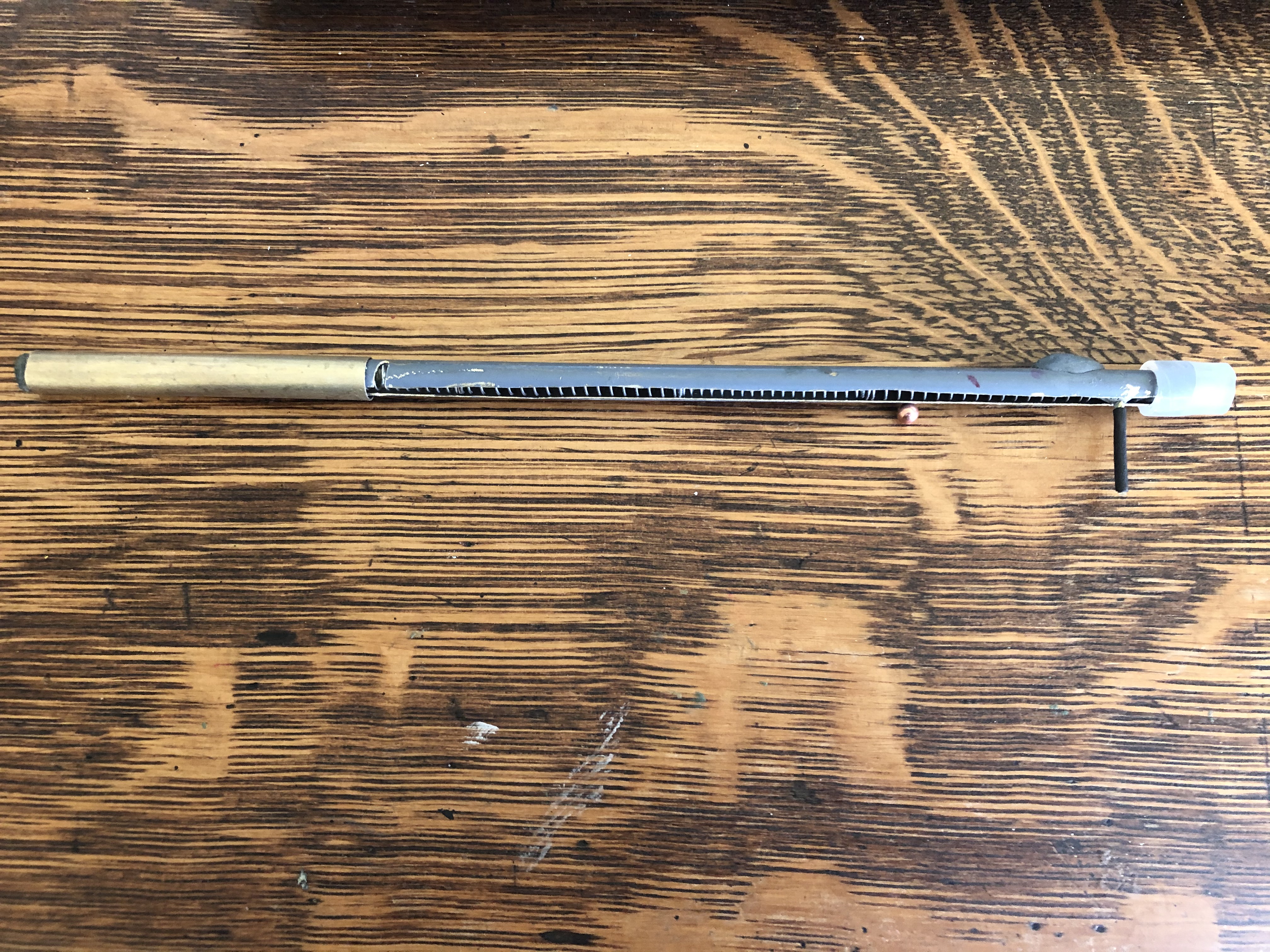

This is a crude magazine I've cobbled together with some brass pipe, compression springs, epoxy and heat shrink tubing. The capacity is about 50 .177 bbs. There's a large "L" shaped groove I cut to allow the follower to push bbs into the barrel.

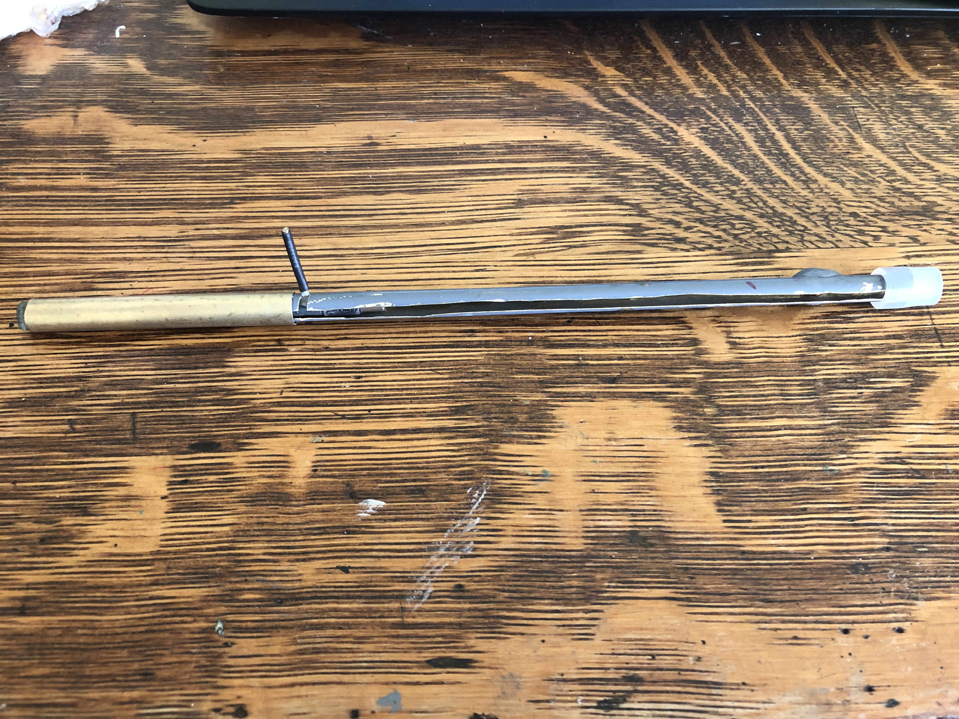

This shows the magazine in the "locked" position allowing me to load ammo into it.
It seems to work, though I have to manually hold the magazine to the cannon. Otherwise the air pressure is too great and the magazine pops off. The next step is to build a better mag well.

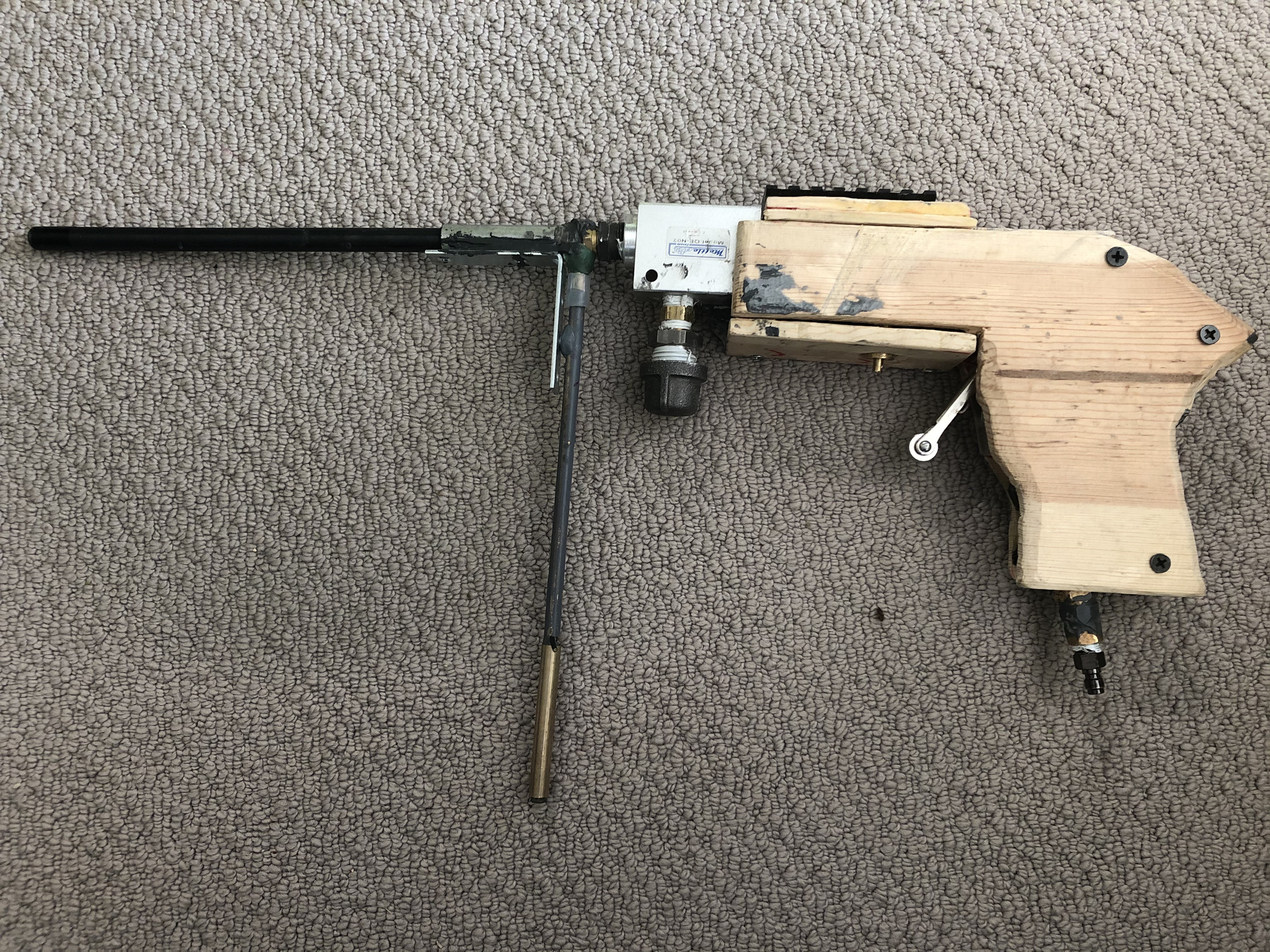

Oh, here is an overview of the gun if anyone is interested.

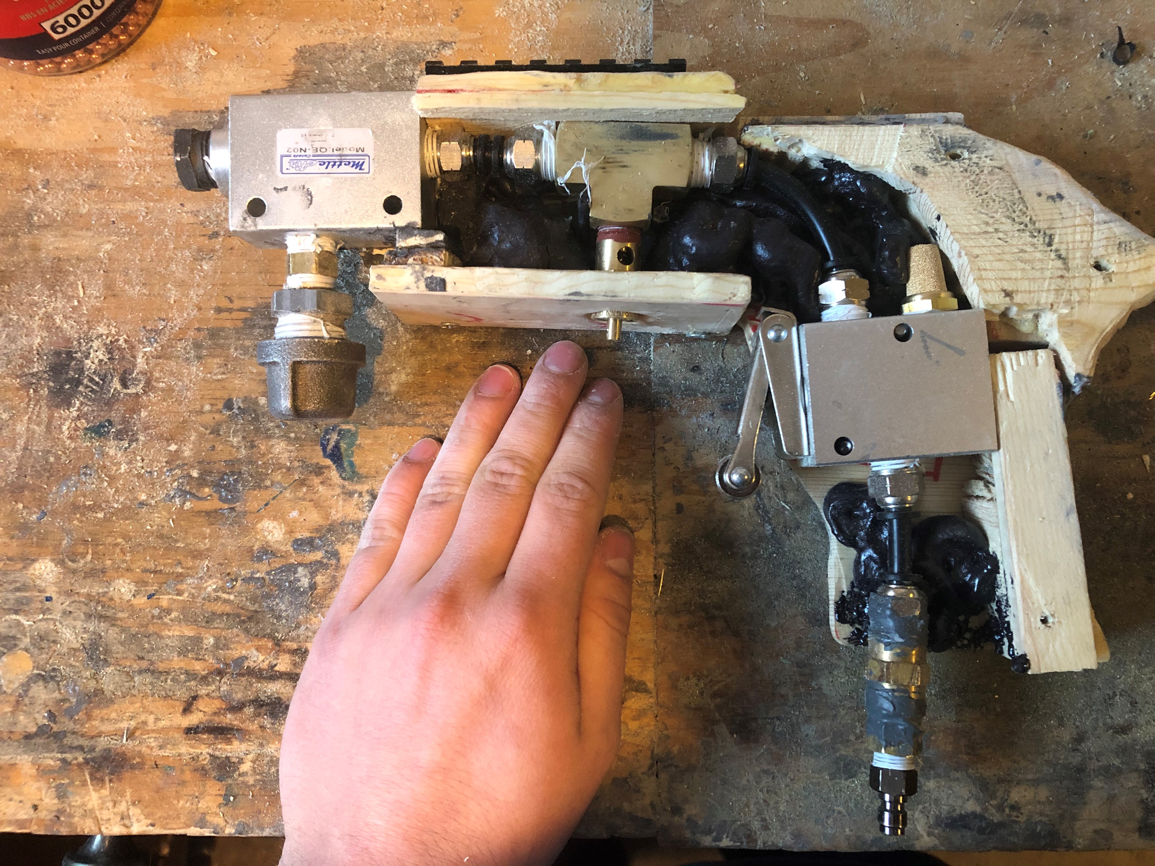

And these are the internals. The insulation foam is to muffle the sound of the popoff valve.
It may not look very pretty now, but with some wood filler and stain, I hope to have look a little nicer than the "random plumbing parts and pneumatic valves" current aesthetic.
