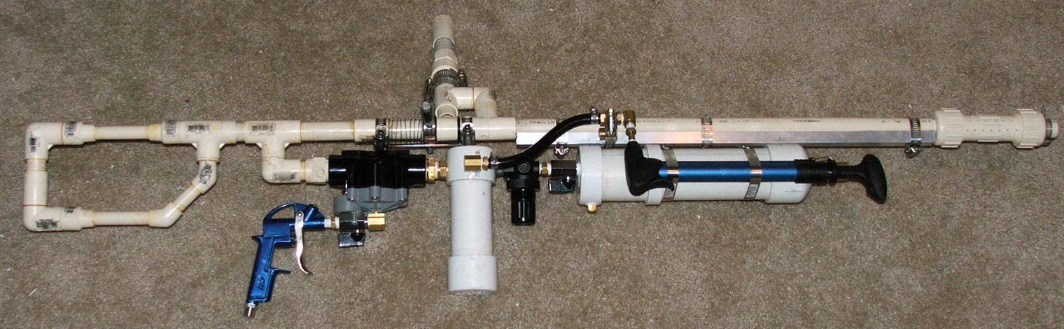

After viewing many sites and studying a host of fine spud guns, I decided to attempt one myself. I think it turned out nicely. First paintball gun.
Bolt action breech loading
2 reservoirs with a regulator in between
Direct compressor hook up and on board bike pump
Functional silencer
Trigger Safety

Is the blowgun for actating the valve?

Yes, that’s a modified sprinkler valve with blowgun activation. I have two air reservoirs, the big one (the main reservoir) towards the front of the gun and the smaller one (the firing reservoir) with a regulator and shutoff valve in between. This allows me to fill the main reservoir and get several shots out of the gun with just one fill. I fill the main reservoir and close the valve, cock in a paintball, fire, then open the valve to fill the small reservoir, and repeat process. At 125 psi I can get 5 good shots at a regulated 40 psi per shot.

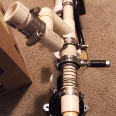

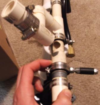

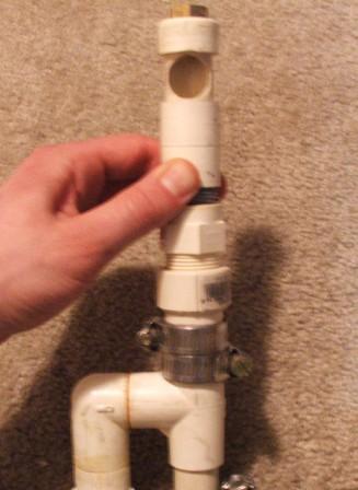

Here are some images of my breech loader.
My breech loading loader, for faster refill<br />holds 12 paintballs
holds 12 paintballs
Open bolt action loader<br />The gray area towards the front of the coupler is JB Weld.  Yeah..... i messed it up and had to fill it back in. I thought if I shaved it down it would kinda scoop the paint up and keep more than one from going in at a time. But it
Closed breech loader.

I like this gun a whole lot!! Looks like one of the best in PVC so far.I do have a few suggestions however.You have a lot of room underneath the barrel to extend the primary chamber forward.
Bigger primary chamber means more shots.if you also increase the diameter of the secondary chamber you get better performance AND extra shots!!! These moderations won't affect the overall look
.About painting it: try cutting pieces of bike inner tire to sleeve( outside) most of the pipes instead.That way you get a satin black gun with a rubber coating to help prevent damage or scratches when you bump it into something.Also it makes the PVC pipes stronger.I do it on my guns and it works great.U can use different sizes of tire or cut smaller rings so it's easier to stretch around bigger diameter pipes.Build up a sleeve from smaller sections that way.
These are just suggestions.Your gun kicks ass as it is.My compliments

When I was first building the gun I thought about having a bigger primary chamber but I didn’t want to make the gun any bulkier then she already was. I love the inner tube idea, I’m goona try that!!
20 full pumps will put at a little over 40 psi

The main chamber is 10” of 2” pvc pipe and the firing chamber is 6” of 1.5” pvc pipe.
As far as plugging, I drilled out about half way into the tee that the stock goes in. I cut a little piece of pipe with one side at about a 45 degree angle and filled it with JBWeld. Glue it inside the tee with the angle creating a nice little sweep to direct the air out the barrel. It acts like a 90 degree and keeps the air from traveling around in the stock
