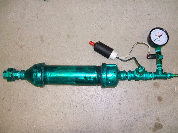

I made this Monday, when there was a 10% off discount at OSH, so it's slightly thrown together, but I think it turned out pretty good. The chamber's about a foot of 2" steel, and the rest of the gun is either steel or brass. The ignition is a single spark BBQ igniter, with one wire through a 1/2" aluminum rod and the other wire attached to the chamber wall. The spark jumps from the inside of the chamber to the chamber wall; it's pretty simple. The barrel is 10 feet of 1/2" PVC, and I usually shoot ball bearings or rifled potato pellets. I've shot a couple times at 2x, but will go to 5 or 6x when my mixing tank is back at my house.

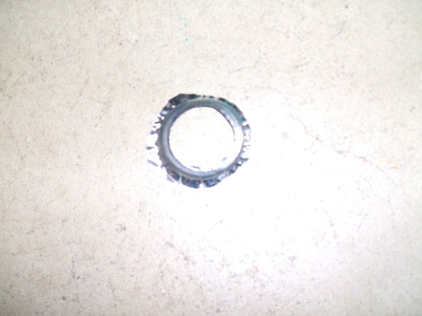

Those of you who have made burst disc cannons know it's damn hard to get over 6 layers of aluminum foil to seal, right? So make burst discs from chip bags! It's some type of mylar, and by the pics you can see they burst extreeeemely well, and seal 100%. Just one layer was tested pneumatically and took about 130 psi to burst.

Check out how well that burst!

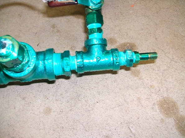

The fill valve
The fill valve

The whole chamber. I am very disappointed my camera didn't get the color, sorry everyone.
