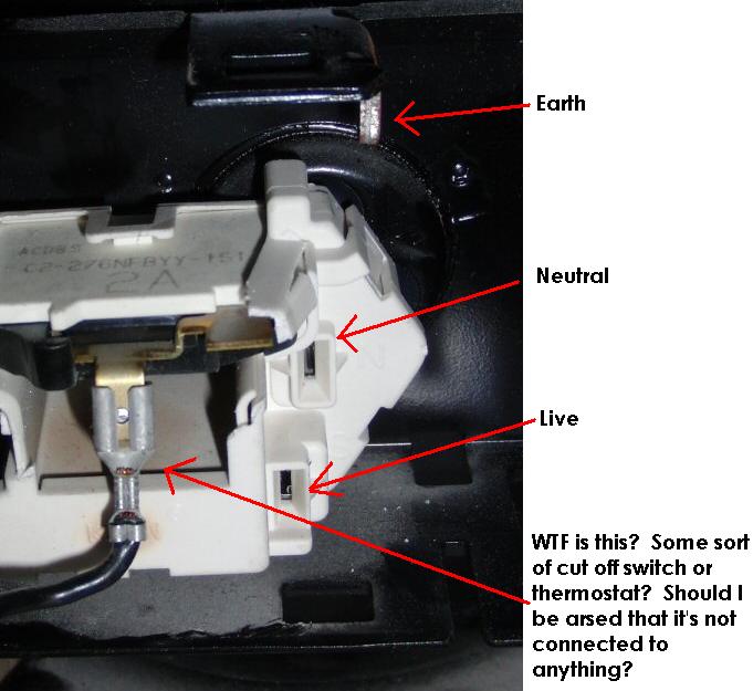

Before I plug this in, have I got it the right way round?
edit: looking at the previous photo before I ripped everything off, it seems I have got it wrong. The loose black wire should be live, yes?
Sat Nov 13, 2010 1:58 pm
hard to say.... but it was attached to something before you started playing with it, right ? check what it was
Sat Nov 13, 2010 2:09 pm
check my edit, it was live :) and I was compressor! woo!
Very disappointing whirring noise, is it meant to be so quiet? Or does it get louder under load?
